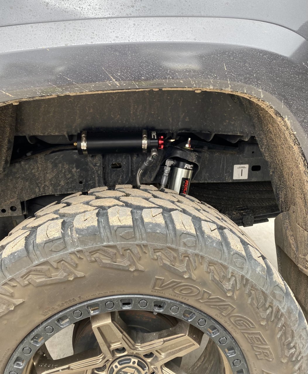

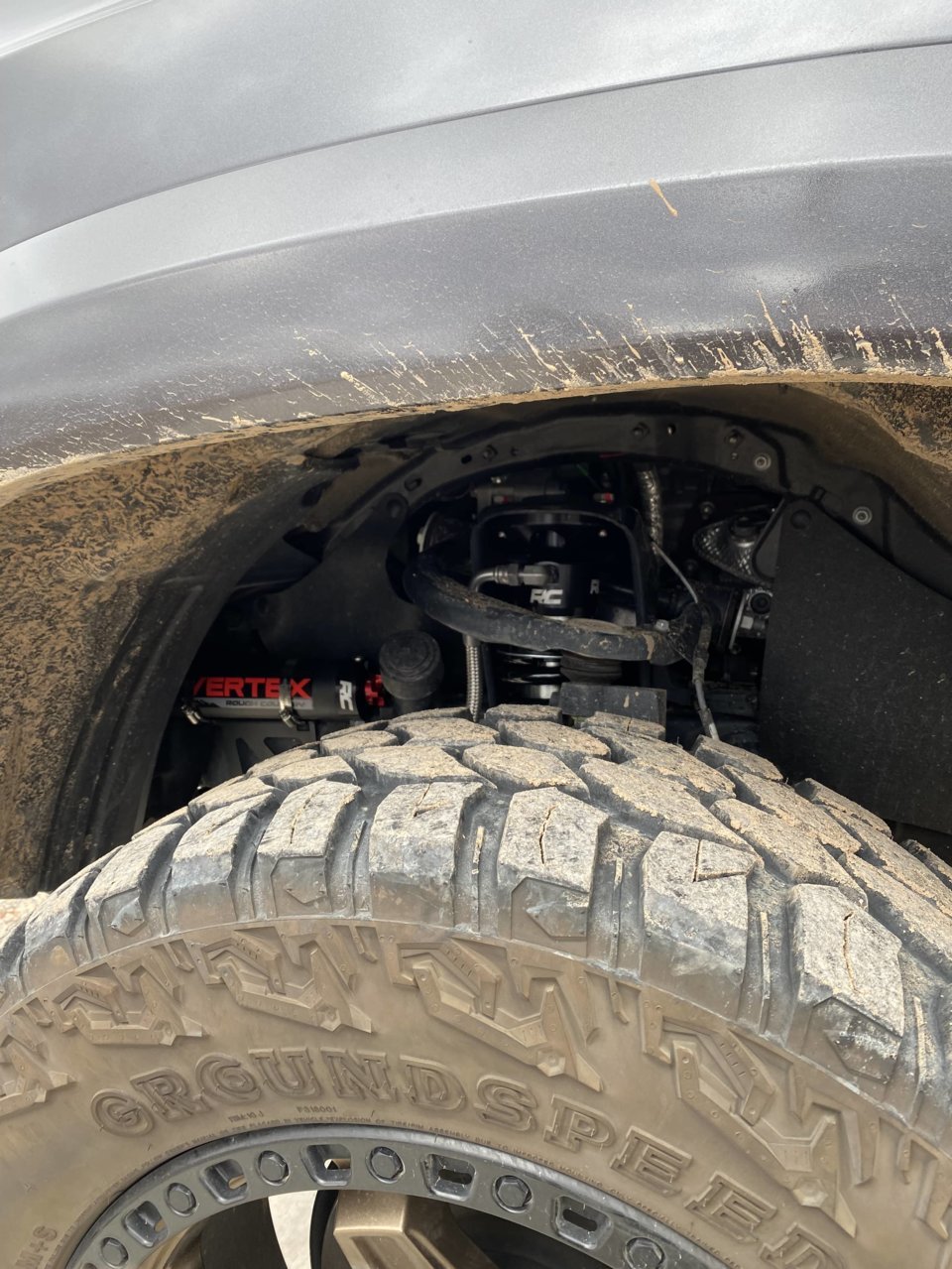

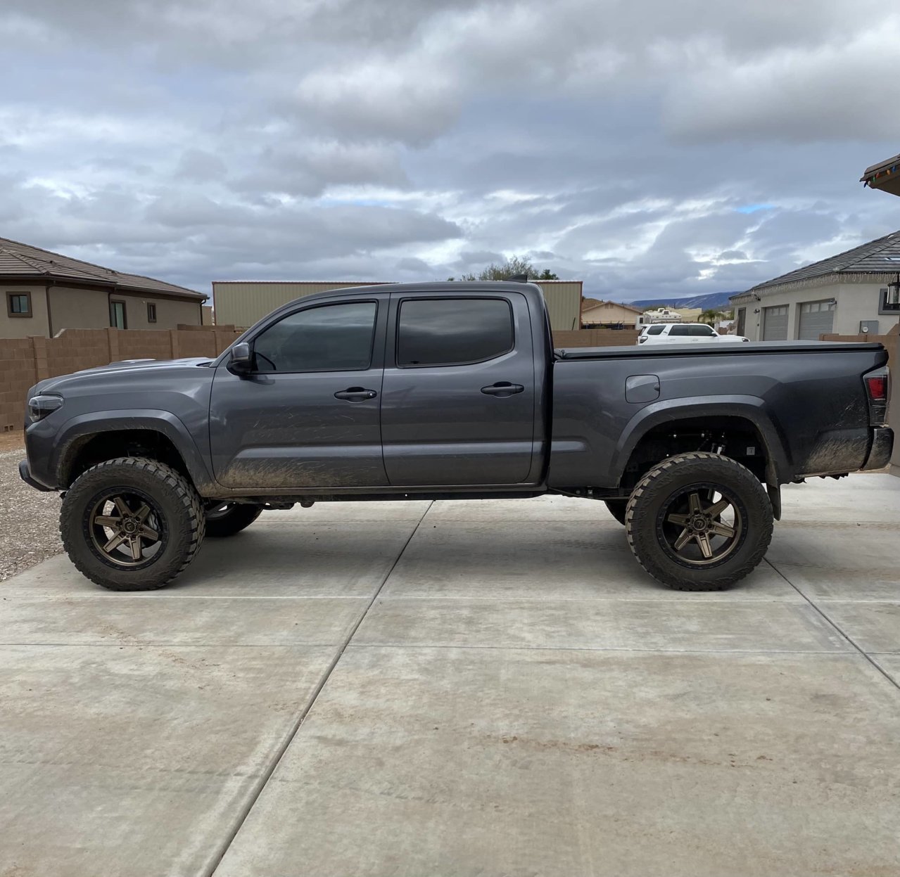

    Finally done!

    Is that the 3.5” lift? 33” or 35” tires?

    6 inch. However, the front is more like 4 inches. 35 inch tires. 41 inches from ground to bottom of fender in front and 43 in back.
    I may just leave it as is because my CV angles are perfectly straight now
    shotgunbilly420 likes this.

    I adjusted my front coils to level it out some

    I don’t hate the stance, it’s just different than what I’ve been used to for the past year and a half.
    I may adjust the front up another inch but for now, I’m happy.

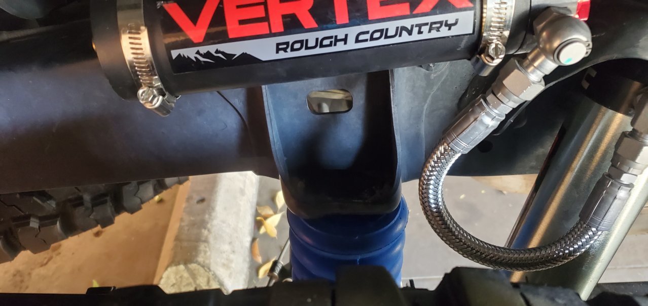

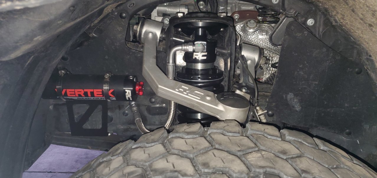

    Have a couple months with them
    Even installed bigger bumpstops, helps but front is still kinda stiff and bouncy 20211126_165115.jpg 20211205_144542.jpg 20211205_105339.jpg

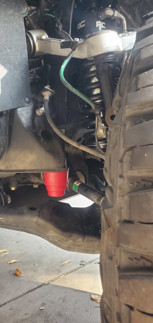

    PowerThirst ECU tune, 3.5" lift in front w/RC Vertex coilovers, SPC UCAs, sway bar delete, 3" total lift in rear w/RC Vertex shocks rear, 1.5" block in rear + Torch AAL, 275/70/18 Discoverer Rugged Treks, TJM rock sliders, DIY bed-mounted full size spare, TRD Pro grille, Raptor grille lights, viper cut (front bumper), recovery hooks, factory black out package Next up: winch, high-clearance rear bumper, lockers, legit skid plates
    Thanks man! So I finally got a chance to pull my sway bar last while I had it up replacing a CV axle. Man it was a PITA to figure out how to actually untangle it from the truck. But finally got it out and just took a short drive to see how it feels around the neighborhood and some city streets. Honestly I was struggling to feel any major difference in body roll or anything like that, even intentionally taking some fast corners. Did notice a generally smoother feel overall though. Interested to get on the highway and offroad. But so far so good! Appreciate the suggestion.
