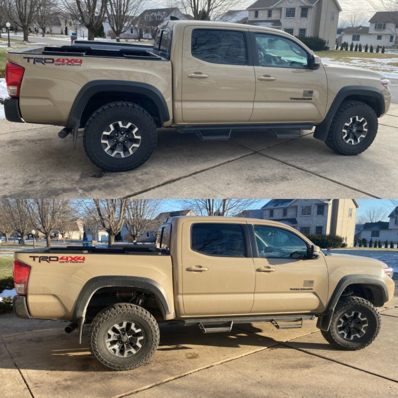

  19. Jan 22, 2022 at 7:21 AM
    #299
    Sweets
    Sweets Well-Known Member
    Jan 19, 2018
    #241778
    154
    Indiana
    2023 GMC Canyon AT4X Edition1
    I just got mine on and, after only 50 miles of road time, I am loving the setup so far!
