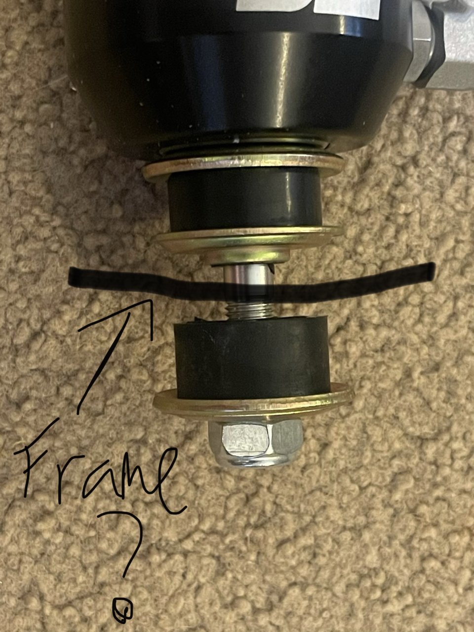

    Aloha What is your guys rear shock bushing/washer orientation. There’s 3 washers and 2 bushings. Is it flat washer, bushing , raised washer to frame , then bushing washer , and nut ?
    the instructions doesn’t have orientation.

    If I'm understanding you correct its washer to frame and lock washer on top of that against nut. And washer against bolt head

    would it be orientated like this ?
