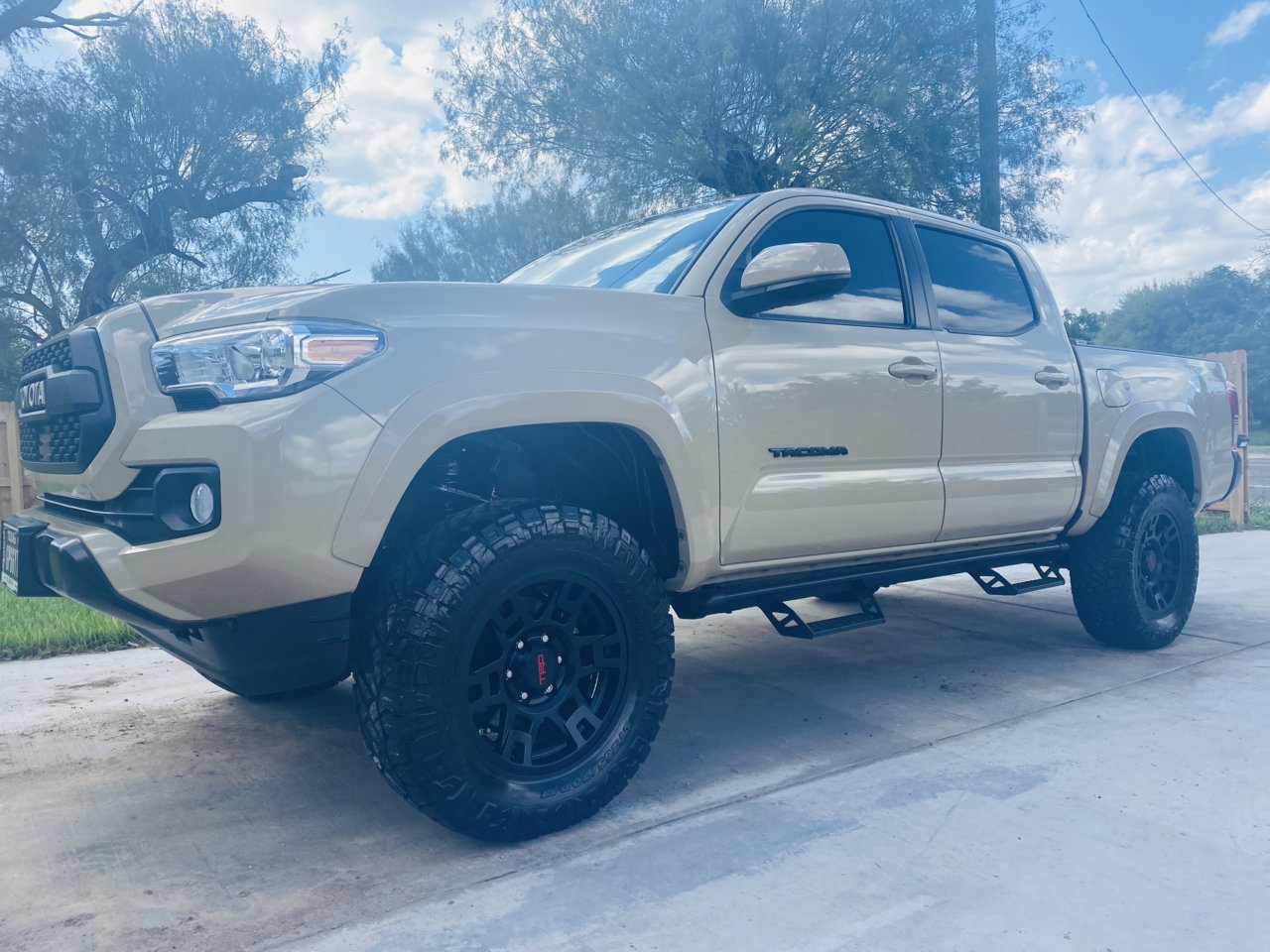

    What size did you order the 3 or 3.5?
    I currently have a 3/2 spacer lift and I’m looking to upgrade my front coils to these, but I’m trying to keep it the same height
