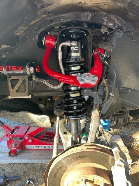

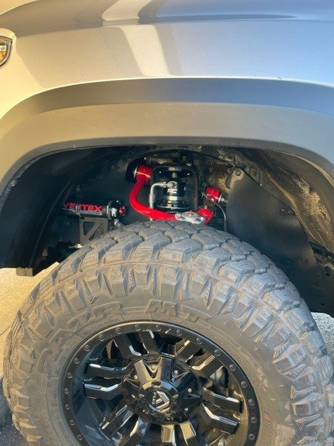

    It was probably a bit smoother with it off and I just jacked up the drivers side to adjust the coil a bit to get rid of the taco lean and I noticed even with the sway bar the cv still was binding just enough that when you spun the wheel it would catch then pop the wheel up a tad. I'm going crazier then normal trying to figure out why mine does it when yours seems fine and it looks like we have pretty much the same setup. I am not too concerned since I don't really do a lot of crazy off road, just not crazy about knowing if I get one wheel off the ground that my axle will have a slight bind.
    My UCA you might get a piece a paper to slide between it and coil with the tire off the ground

    I was thinking the same. I did notice that my Vertex 3.5s came from RC with more preload then yours. I might try taking some out of them and see if it changes, but I do like the amount of lift it has now though.

    That’s a pretty minimal difference. Not saying that couldn’t be what’s causing your gap with the UCA or your axle bind issue… they will only droop so far though, regardless of where the height ring is adjusted to.

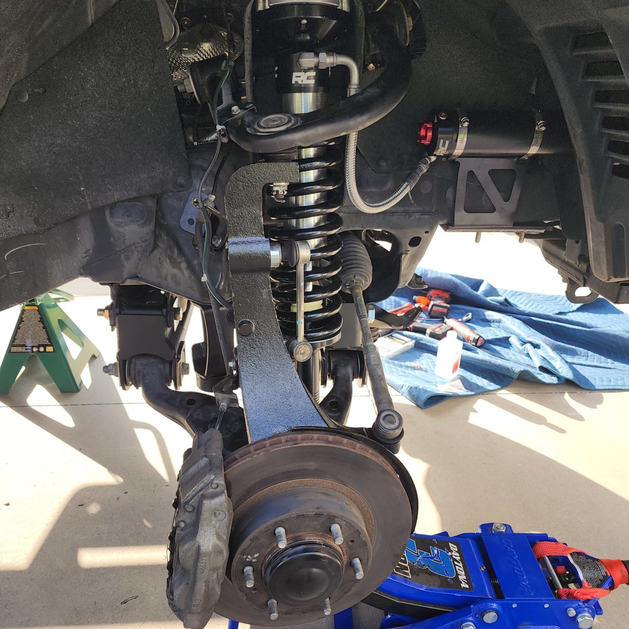

    20220922_190913.jpg I did the diff drop right after I installed my 3.5" vertex. At first i didnt want to after all i read, but the cvs were too much at angle i didn't want to risk it. The diff drop put them at a much better angle. I had to add spacers to my skid plate since the diff dropped slightly. I offroad a lot, almost every weekened I can. Haven't had a problem, and my boots are fine. I recommend you do it.

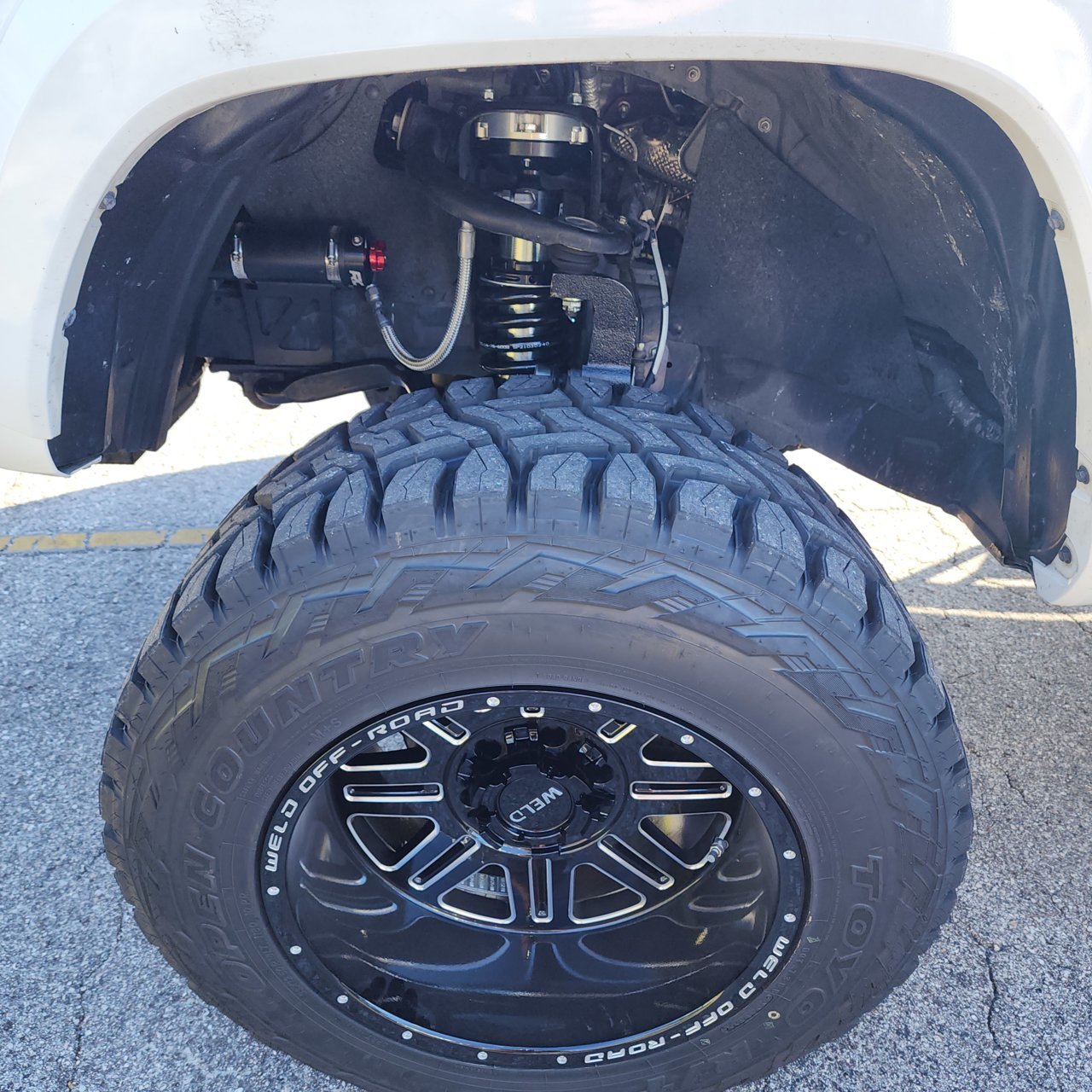

    I have a Zone 6" kit. As several people have stated, the 6" vertex c/o doesn't lift 6" out of the box. The drop brackets on many brand kits actually drop the lca's more than the RC kits, and this is the result. I personally chose adding 2" spacers to them (against RC recommendations) and it came out great. Factory UCA, great angles on everything, and I could adjust them up if I chose.

    Looks great have better pictures of spacer added. Never knew you could do that?

    That's the only other pic I have at the moment. It's a RC spacer.

    So rough country doesn't recommend?
