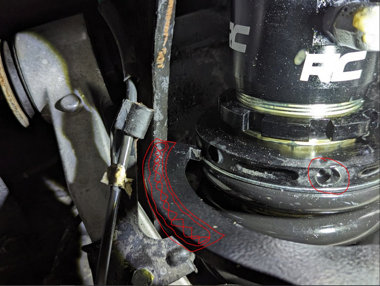

    In Toledo, OH. Just wanted to add that I've recently purchased and installed the 3.5" fronts. Going to really abuse these. I ultimately see these rusting quickly and have applied a liberal amount of fluid film to the areas as seen in the picture below. The shocks came pre-adjusted, but did NOT account for taco lean. Passenger side 1 1/2" higher than driver side. A spanner is not included with this kit and was purchased on their website. It was a little confusing on the site to find the correct SKU (10403), but it is the one for F-150. I will post a ride height picture as soon as I get it dialed and re-aligned. Got some limit straps ordered, too. already busted a CV. Waiting on ORW to ship.

    Yours came pre adjusted?! Shoot I had to really krank on mine to get about 1/2 of threads showing

    Yes, honestly I wasn't too happy about it. I am driving with about a 1.5" lean at the moment. Spring rates and shocks are the same length and size.I have noticed in a few pages of this thread that most people just have a taco lean. This was a little more. I have some spring tools to adjust more easily, but honestly the average person would have to take this to a shop to get it adjusted and that's kind of wrong.
    Update: I decided to act like a 'regular DIY guy' and use the spanner tool they sell on their site. It's trash and I ended up using my set. Only good to loosen the top collar. Machinists will be happy to note that either a cutoff wheel to shorten the outside diameter of the tool 1/4" OR a 5/8" hardened punch with a small cheater pipe will work for you. I highly suggest getting a set of spanners (or the 1st option) to avoid the collar damage noted here. This is bad design. Big loss for RC.

    Ya my collars are chewed up to after using the punch and cheater bar. Ridiculous, I just shaved down my RC spanner wrench as well to get it to fit
