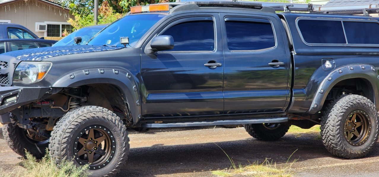

    No it wouldn't. Mine sag so bad I lost about 1.5" lift. I had to swap the coil with eibach 700lbs rate but now my ride is too stiff. I heard 650lbs coils is the sweet spot 20230403_101532.jpg

  16. Apr 18, 2023 at 12:30 PM
    #556
    Fonzy77
    Fonzy77 Well-Known Member
    Jul 19, 2015
    #159804
    99
    California
    2007 White Tacoma
    How heavy is your bumper?
  17. Apr 18, 2023 at 1:42 PM
    #557
    Mully
    Mully Well-Known Member
    Feb 12, 2014
    #122907
    5,272
    CA
    12 DC 4x4 Lifted Sport
    Lifted, Kings, Locked, 295s and more.
    You will need 650# springs is you have a steel plate bumper and a winch. I have a 1000#s of armor on my truck and have 700# springs. Truck rides great.

  18. Apr 18, 2023 at 1:54 PM
    #558
    MauiJR808
    MauiJR808 Well-Known Member
    Sep 29, 2019
    #306637
    337
    Jrey
    Hawaii
    2008 black tacoma 4x4
    Paint black with gold pearl with camper
    200lbs with the winch
