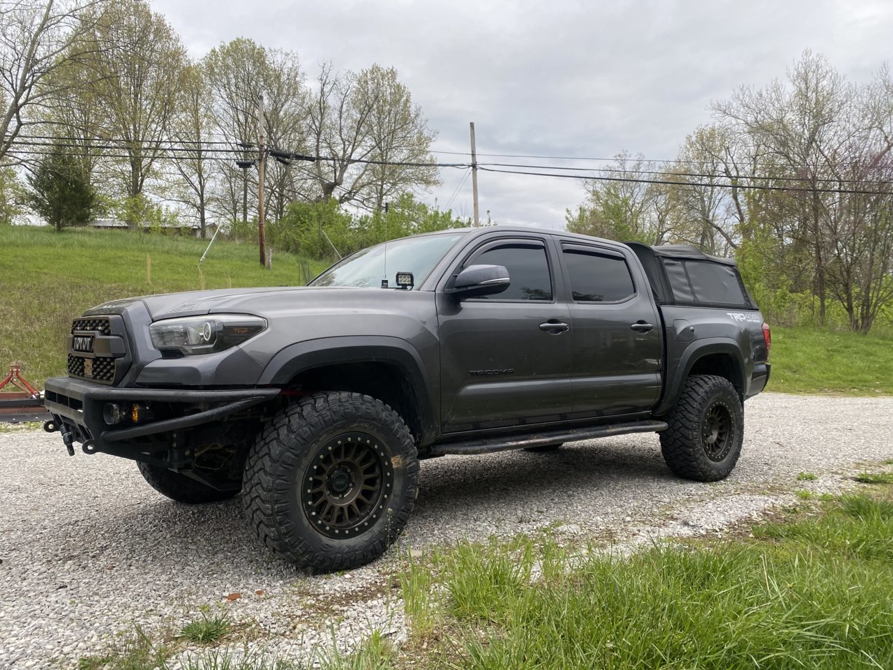

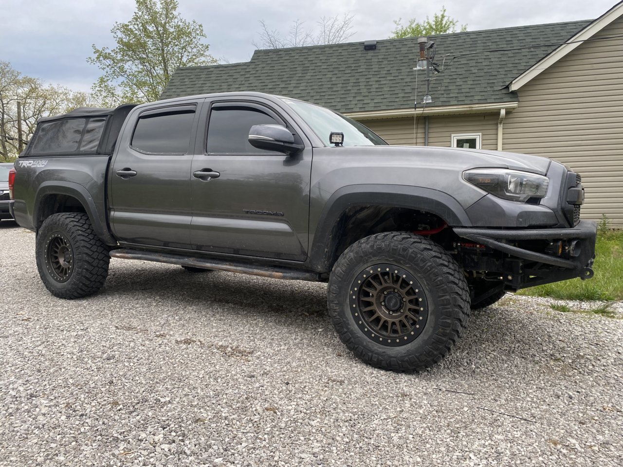

    I believe that is fender to hub measurements not fender yo ground, but interesting that's a full 3" of lift.

    Correct. Fender to center of hub.

    Is it cool you could get a fender to ground measurements as well? And if I recall correctly, you have not adjusted the coilovers yet, yeah?

    Yeah I can do that. I have not adjusted my coilovers yet. But I need to

    Fender to center hub is really the only way to accurately measure your lift. Tire pressure, ground level, ect. influence ground to fender. My SR5 was 21 front and 22 rear stock.

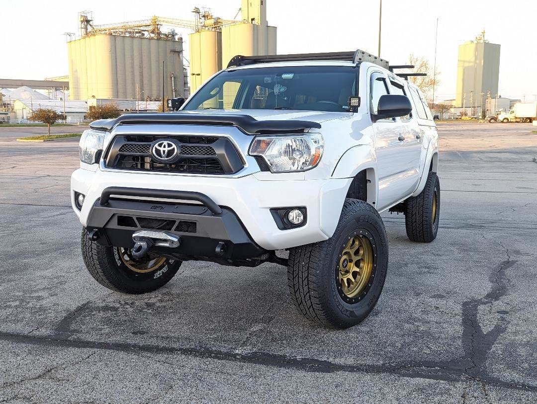

    Update on this - I have adjusted the 3.5" fronts down to give me a solid lift height and save my other components. Paired with their 'forged' Uppers, I get quite the amount of downtravel and need to limit it. Truck looks great and I love the ride. I have them set at 4 and it is soft with the Geolandars. They're pretty great for mid to mild off-roading on dirt and gravel, but beware on rocky trails. Note: The RC UCA nuts are rusted already, even after dousing them with some Fluid Film. Can't avoid it. I am pretty annoyed with the resi-mounts, as well. They made way too much noise when they were initially mounted. Bounced off the frame basically 24/7. They were since adjusted.
