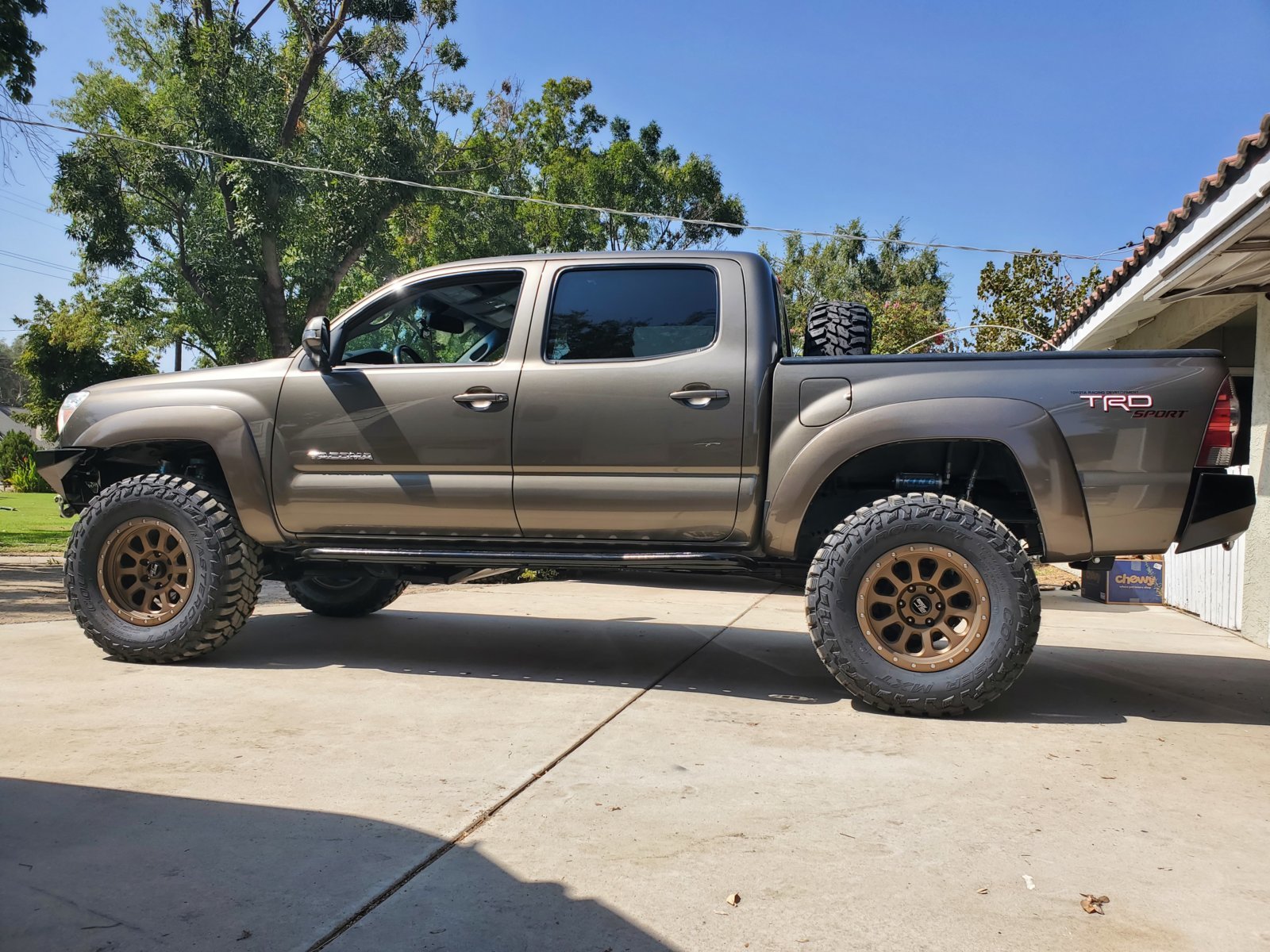

    Because a DB lift requires the main cross member to be cut out of the frame. Go with a good 3" lift and 35s or long travel and 37s.
    This is a 3" lift on my truck.

    Kings EXT set at 2.5", TC UCA, Dirt King LCA, 3" expedition RS, Marlin Crawler HD gussets and Cam lock kit, Total Chaos spindle gussets, BAMF hangers, x-brace, regeared air-lockers and more. Super flexy and works great.

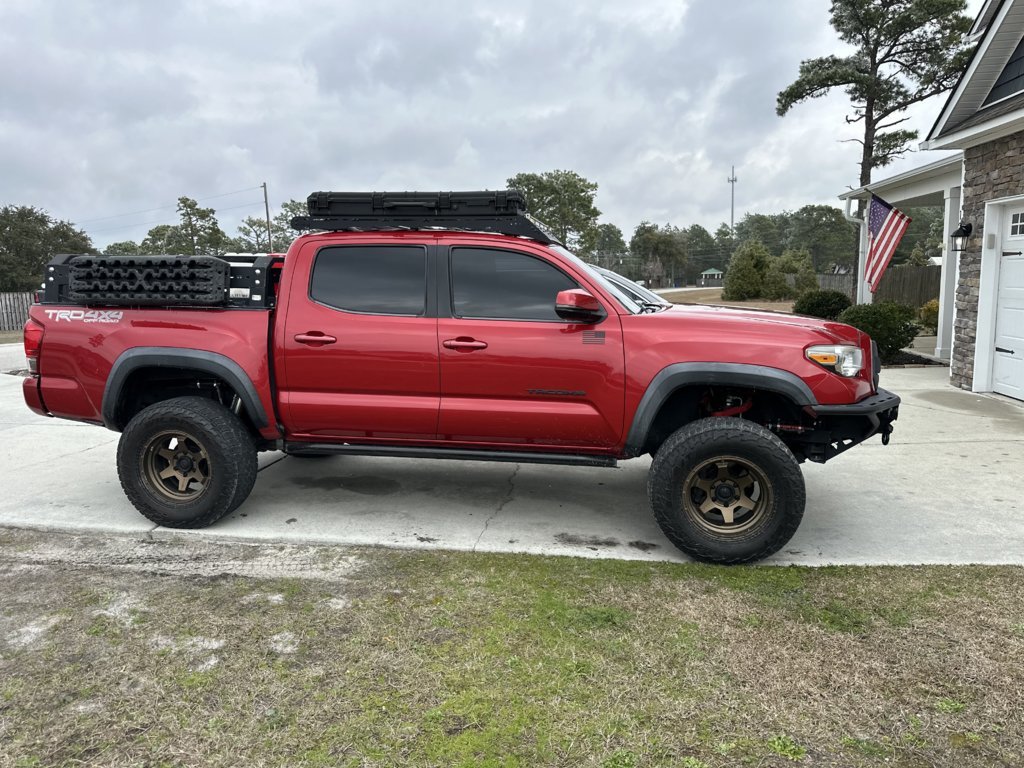

    Got my 3.5 lift with Vertex front coils and their adjustable rears. No blocks. Old man emu leafs. I had kings 2.5 oem coils and icon tubular uca on 2 lift that were needing a rebuild.Used the forged uca that came with the kit since the icons only support up to 2.75 lift. Gained two up front, didnt have to use the blocks in back to make it level. Rides like a cadillac. Right now have fronts at 4 and rears as well. Might try front ans rear at 3. Also getting 34’s installed tomorrow since I already have the pinch weld. Will update with the 34’s. For reference, those are 285/70/17 on Fuels.

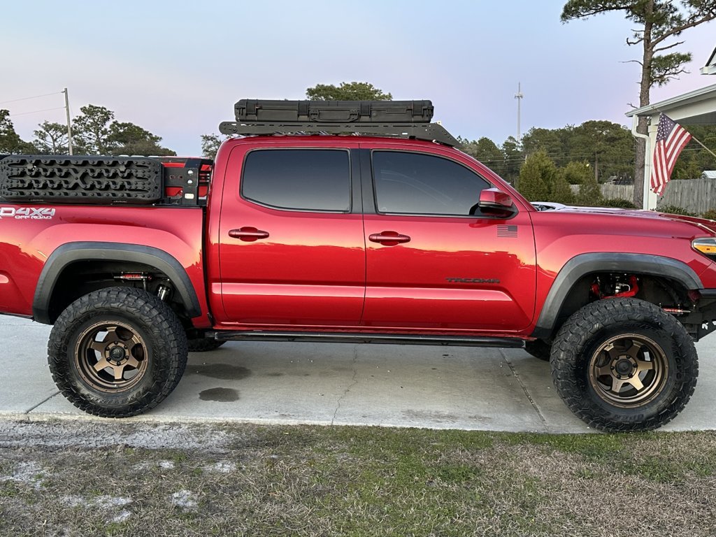

    Here she is on Toyo RT Trails 285/75/17
