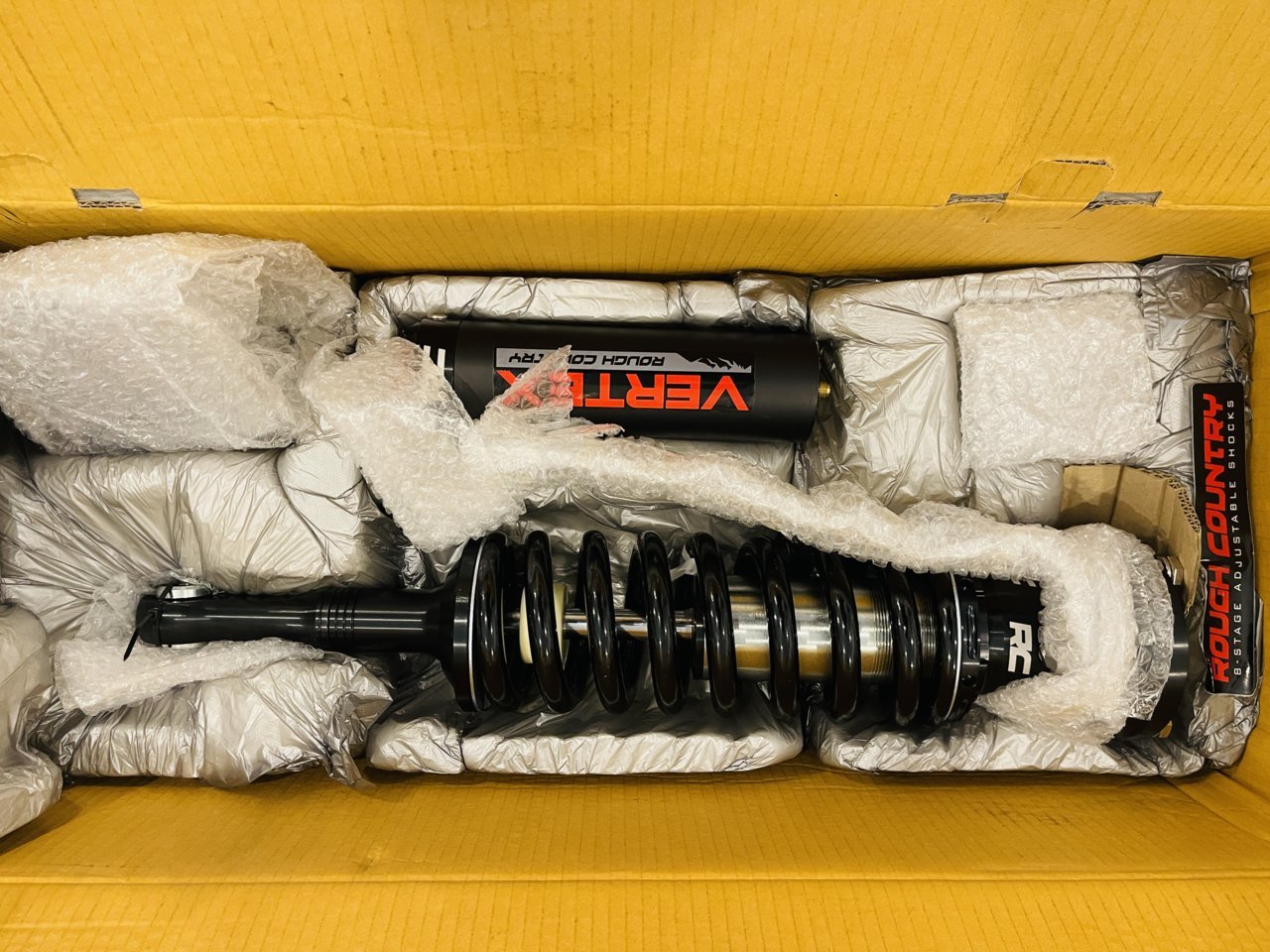

    638B4C39-5DEC-44D8-A043-AAB4E13AE3AD.jpg B2B7AC9A-E6F1-4420-BCF0-603355565552.jpg Well FedEx only delivered 1 of the coil overs, first impression of the 3.5inch is they are massive holy chit. Was hoping to get them installed today but doesn’t look like that will happen
