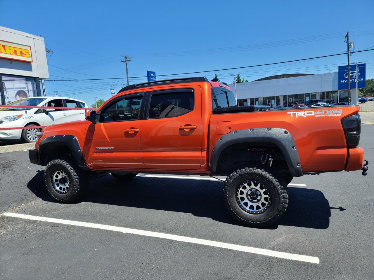

    So I ordered a 6" and I really feel like I got a 4" outta the whole deal
  5. Jul 7, 2021 at 6:18 PM
    #145
    shotgunbilly420
    shotgunbilly420 OG Owner 249+ mi club/Tacoma enthusiast
    Jul 10, 2018
    #258947
    3,320
    Montesano, Washington elv. 66ft
    2017 trd Tacoma offraod AT Inferno
    315/75/16, 6in modded RC lift,Anderson Engineering manifold spacer,K&N air intake, URD YPipe, stock exhaust ,16" method nv305 wheels, AFE throttle body spacer, vf Tune program, JTL 3.0 Oil catch can x2, rear cat delete
    Top picture is what happens when you don't install the lift your self, bottom picture I fixed it myself front is close to 24" from center hub to fender and rear is at 24.5" .

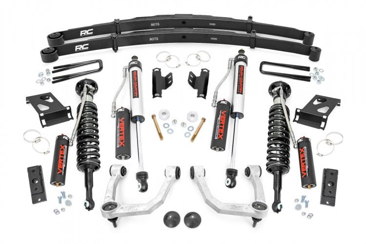

    Interesting discussion. I am on the fence with the Icon stage 4 w/Tubular UCA's and Icon AAL - or these RC Vertex. RC has a full kit now with RC UCA's and leaf springs. I am interested in the 3.5" setup. Anyone following this discussion have this full kit? Or have any interest, or information about them? Like others have mentioned, the RC site is lacking details. Reviews are bleak.

    I only have the front coil overs and the V2monotube rears on blocks. SPC uppers. It rides great! I’d say this kit you have pictured would be a good investment,
