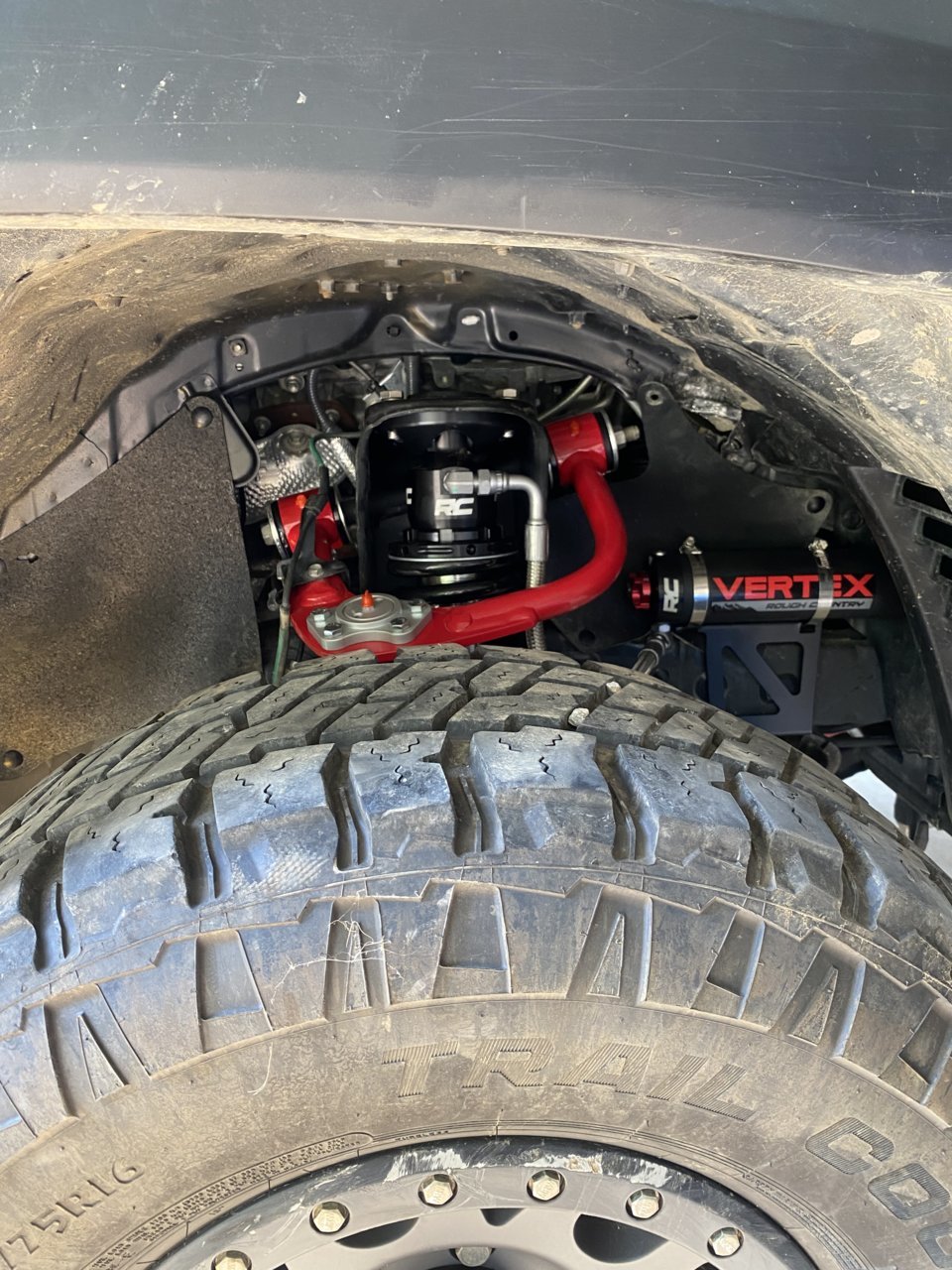

    Has anyone really achieved a true 3.5” lift from these. I swear I’ve got a bit of a front rake very slight. I bugs the hell out of me. I wish there was a way to adjust these while on the truck

    Update! I actually borrowed a Jack from my neighbor and was able to adjust them with a 5/16 punch and used a large adjustable wrench for leverage. It is possible!

    19 trd OR tacoma
    Got mine did today! Along with JBA UCAs and a sway bar delete mod

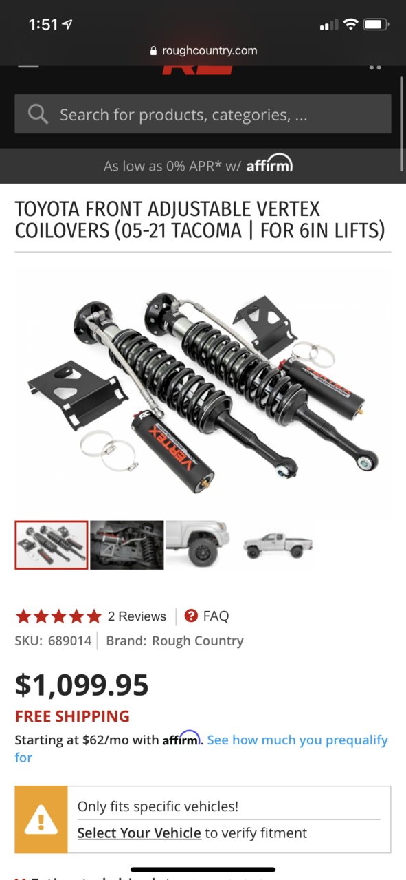

    Are these for a 6 inch lift?
  9. Aug 8, 2021 at 11:01 AM
    #169
    shotgunbilly420
    shotgunbilly420 OG Owner 249+ mi club/Tacoma enthusiast
    Jul 10, 2018
    #258947
    3,320
    Montesano, Washington elv. 66ft
    2017 trd Tacoma offraod AT Inferno
    315/75/16, 6in modded RC lift,Anderson Engineering manifold spacer,K&N air intake, URD YPipe, stock exhaust ,16" method nv305 wheels, AFE throttle body spacer, vf Tune program, JTL 3.0 Oil catch can x2, rear cat delete
    3" or 3.5" lift
  10. Aug 8, 2021 at 11:04 AM
    #170
    Taco530
    Taco530 2016trd off-road OvTune 6speed
    Nov 30, 2019
    #312109
    8
    Ian
    Los Molinos Ca
    3rdgen trd4x4 double cab
    Rough country vertex 3.5 lift Jba uca Ov tune
    They make them for 6in lifts tho

    And I belief you go back on the post a guy in a second gen has em FA3DD638-180B-46DA-8354-C153E1877F48.jpg

    They have them for 6”

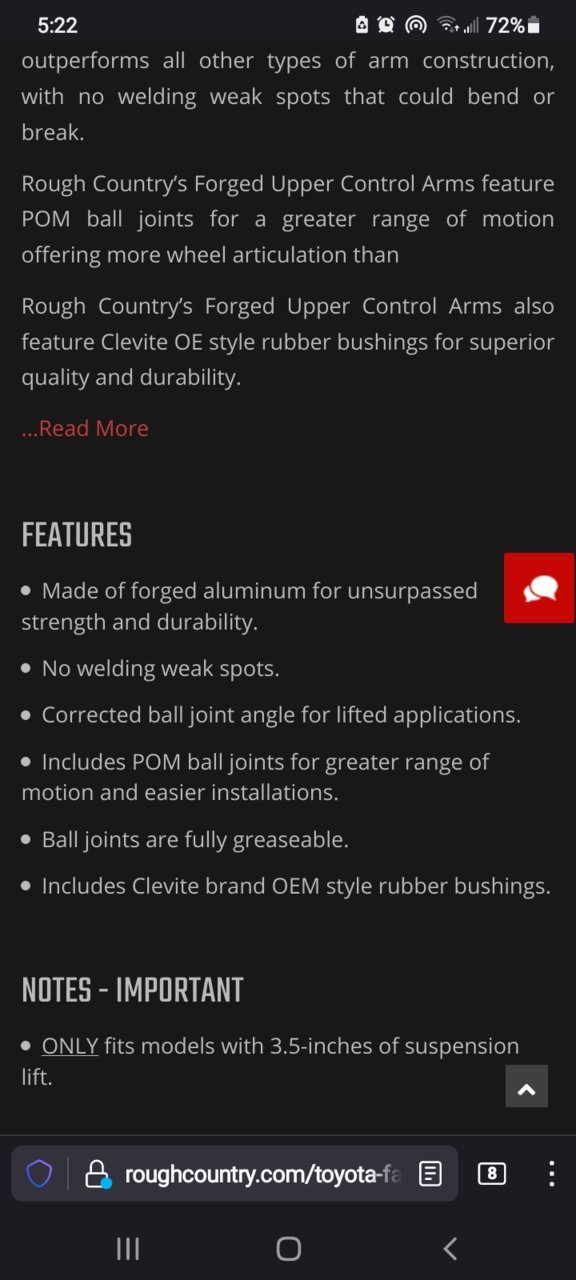

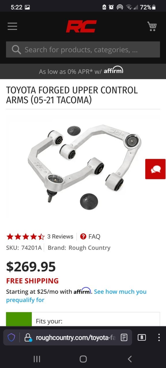

  15. Aug 10, 2021 at 2:18 PM
    #175
    tclavell
    Aug 7, 2020
    #336897
    12,439
    Troy
    Phoenix, AZ
    G70
    I could be wrong but i believe @shotgunbilly420 is referring to the UCAs supporting the 6 inch lift kit. They come as a kit for the 3.5" lift but not 6".....
