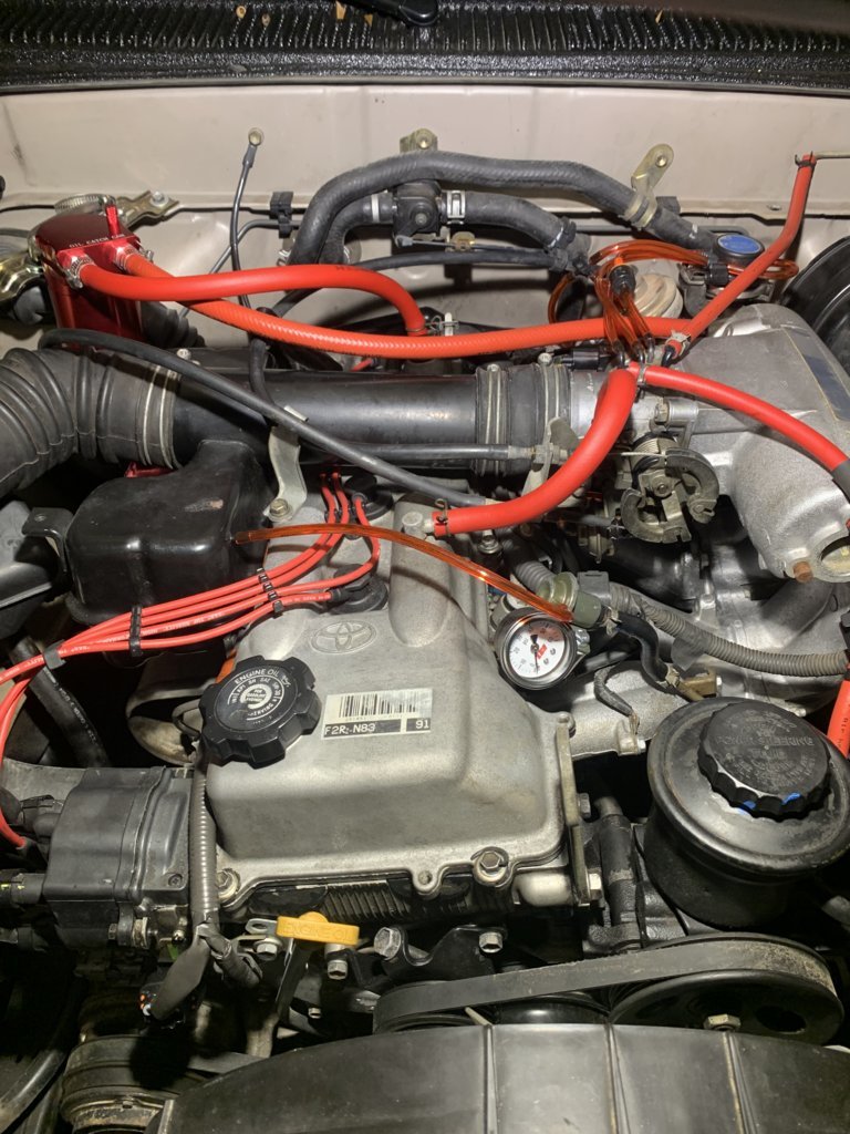

    Clock Volt meter/LSPV Delete/Hyundai 16’s/FP gauge/after 9months of wrenching ZERO oil leaks
    Here is my LCE FP gauge
    I have used the readings 3 times already to rule out issues with fuel pump
    2R-STEEZ[OP] likes this.

    Looks really clean. I have the pieces to build a gauge where the fuel line meets the fuel rail. I might go with the LCE since it's relatively affordable and anything that I could put together might fail on the highway haha

    I made FP gauges on my 2 other old cars
    But relatively simple bc of the rubber hoses on both. IIRC, our fuel inlets are steel and near firewall.
    I decided too much of a chance to screw something up and bit the bullet for that LCE gauge
