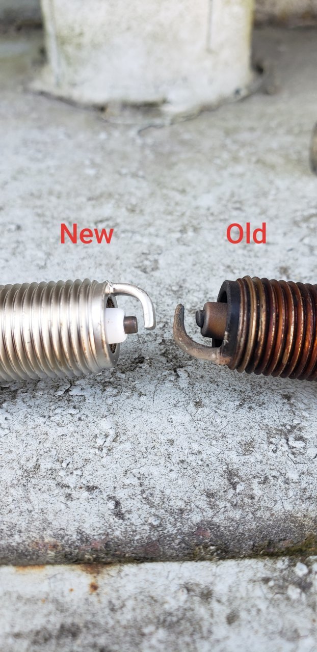

    Replaced my plugs two weeks ago because of a rough idle. Put new ones in and it went away. Old ones were shot, obviously. Now that rough idle has returned only it's not as frequent. It comes and goes. RPM'S fluctuate about 200 at idle in park. What gives?

    How many miles? Those plugs were shot

    235k miles. I'm pretty sure these plugs might have been original lol.

    Those are supposed to be replaced every 30k miles!

    Well I bought it with 230k miles on it so its unknown when or if they were replaced the last time.

    FYI 09 plugs are 100k interval per book and mine looked good after 100k.

    If they were original and you have a V6; youll have 3 NGK and 3 Denso plugs.
    What they do in the 4 banger I have no idea.
    Edit:
    Is it throwing a code? Could have burned out a coil with that huge gap in the plugs.

    No codes have been thrown and yes 3 NGK and 3 Denso's came ou . So its sounds like they may have been original.

    If you have the 1GR-FE it’s every 30,000 miles.
    It you the 2TR-FE it is 100,000 miles.
    Does it needed them every 30k?
    Well, that’s not for me to say.
    I just drive my truck. Lol:confused:
