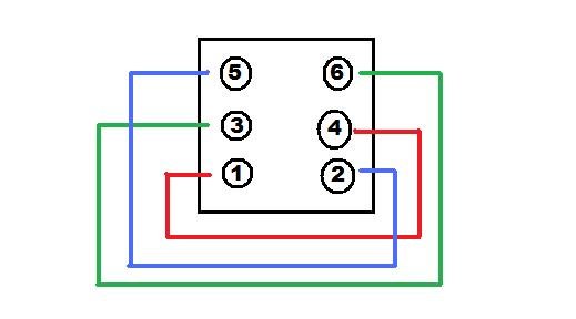

    same thing happened to mine when i also replaced the covers. mine was the spark plug wires were not in the right order.
