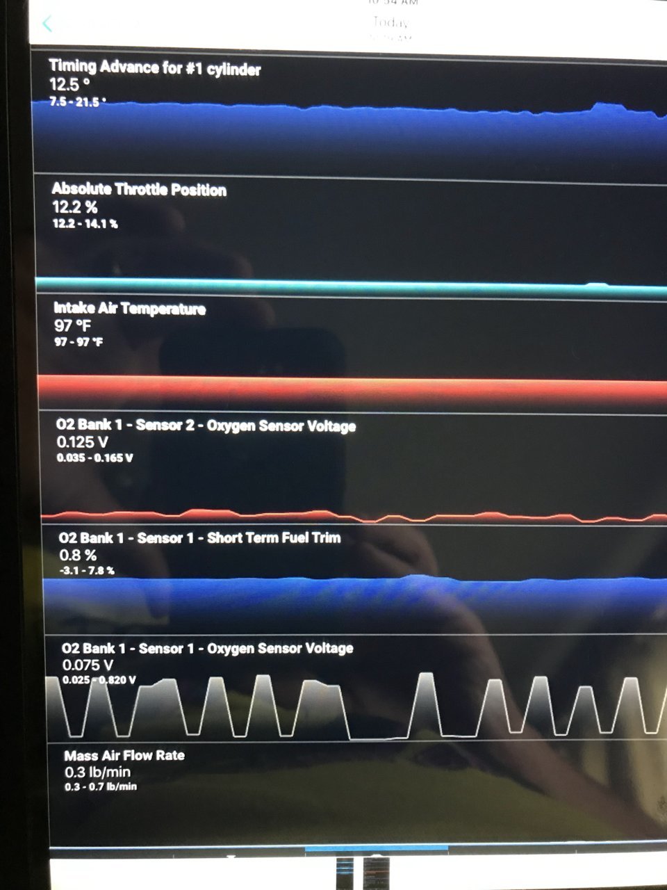

    Starts up OK and not too rough with the idles where it's supposed to be a little over 1100 rpm but after warm up it drops to below 500. It hasn't stalled yet but shakes and almost dies. No CEL and I put my code reader on and nothing shown as pending. See photo below of some of the readings, I honestly have no idea what these mean. I haven't done anything yet except tired to find an vacuum leaks. It's been awhile since it has had plugs because it's just an errand truck now and really only make one trip a week to the dump.

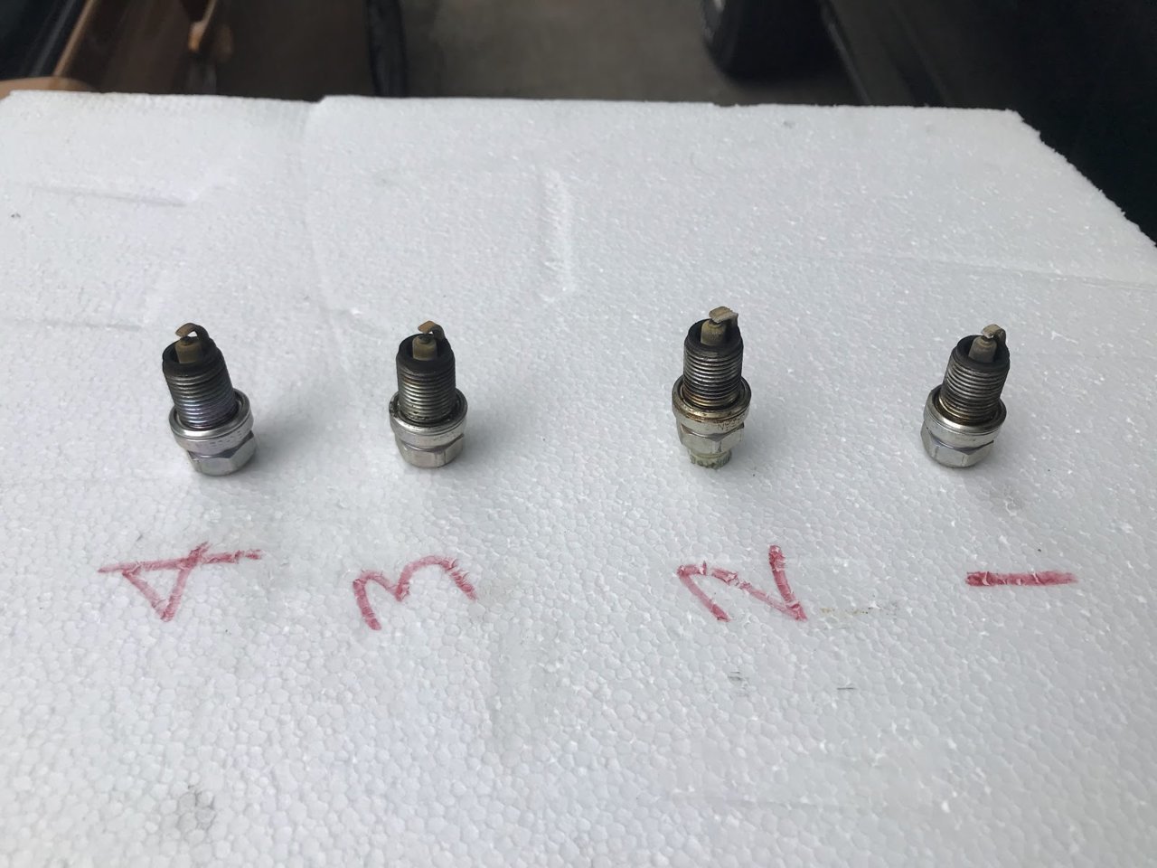

    Got the plugs out....Parts store only had 1 on the shelf.

    Best things I ever did to my 2.7 were new iridium plugs and clean the MAF. I did them both at the same time so I can’t be sure which had more of a positive effect but together they fixed my idle and bogging problems.

    Got the plugs in and the issue is still present. It's hot day here about 90 deg and I even got the low idle on a cold start. I'm leaning towards a IAC valve problem. Still no CEL. I put an eBay cheap IAC valve on it a few years ago and was warned it might not last long. I'll put a link to that post below. The problem isn't the same but close.

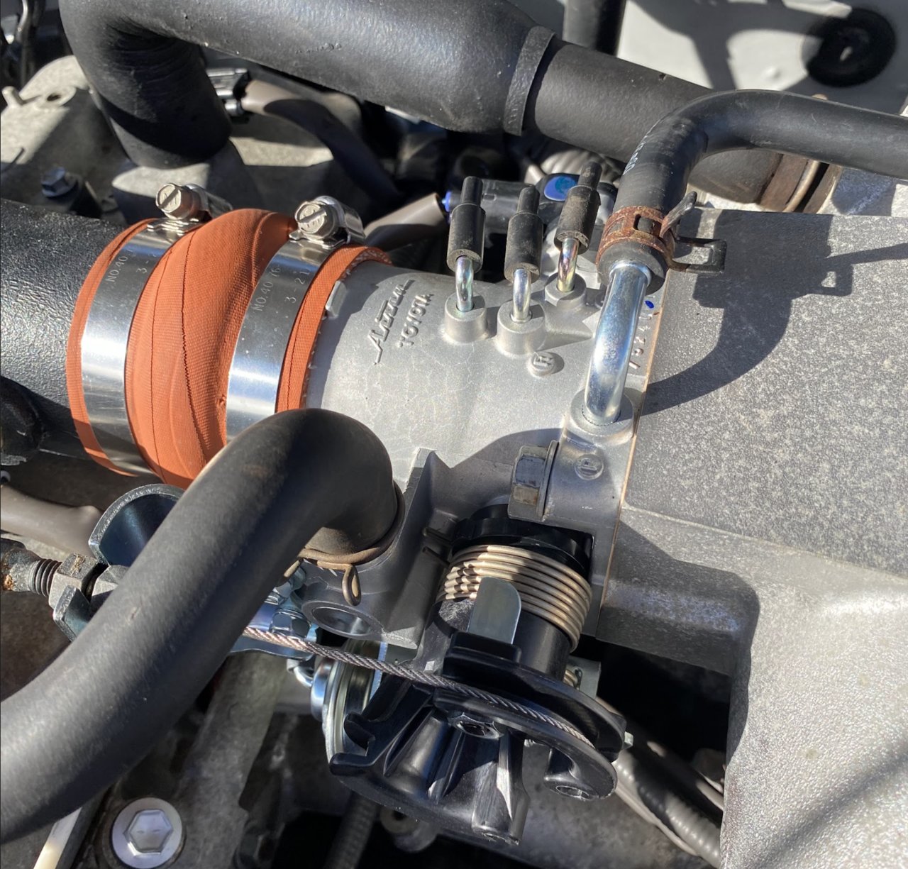

    I don't know if I'm late to the thread but this is my 2 cents. Let me just mention, I am not a mechanic nor a technician of any sort. Before spending more money and replacing parts that may or may not be bad, try this. I just did it on an 87 Camry a month ago and fixed the rough idle and the surging compressor as well. Most recently, just did the same on an 05 Honda CR-V and so far so good, as a matter of a fact it has never ran better but I'm still keeping an eye on that one. I have 02 Tacoma prerunner 3.6 that I intend to do next but haven't gotten to it. Take apart the intake and the filter and the mass airflow, all of it. Locate the throttle body and iac and clean the throttle body. Clean the heck out of it with the throttle cleaner. Shoot you don't even have to remove it if it's not too bad (if left on do not stick your hand in it, use a wooden stick of some sort I used the handle from a broken hammer and lots of paper towels). You'll need some help to do it as the throttle opens and closes when the accelerator is pressed but only if left attached. Do not do it while car is running, only on "on" position. There's tons of videos online teaching you how to clean a throttle body. The iac might be bad but from my experience, the mechanical throttles last a lot longer than electronic. If you see it looking gross like syrup or something spilled all over the butterfly when you first open it up I'm willing to bet that's your problem right there. Next, check the idle adjustment screw as it might just need tightening as well. Look for that bolt and adjust as necessary, again refer to videos. I am not a mechanic. After all of this, you'll need to preform an idle reset. Super easy and simple. Not entirely certain it will be the same on yours than it was on the Camry so you'll want to do your own research but shouldn't take more than 20 minutes. And if some horrid smelling white smoke comes out, don't worry apparently that's normal. I suggest running the truck for a while after at least 10 miles so it relearns the idle and driving patterns. The entire process took me about 2 hours as someone who had zero experience. Hope this helps. Good luck and keep us updated!

    Reporting back....I thought about trying to clean the throttle body and IAC but decided to just replace the IAC. The low idle issue is gone and it's working it's way through an idle relearn. The hardest hoses to get off are the two coolant lines on bottom, taking the throttle body lose helps to get to them easier, same with the electrical connection. Don't forget to hook them back up before bolting it back on.

    pull off the whole intake assembly and clean it.
    if ay grime builds up around the throttle plate, definitely can cause idle issues.
    doesn't hurt anything to clean the intake and replace the plugs.
