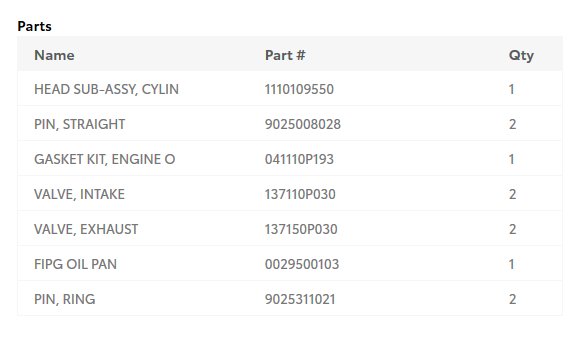

    Search for the P11EC code and there are a few threads with multiple posters.
    When I brought my truck in for the repair, there was already one in the shop undergoing the procedure.

    Due to the virus situation, I have driven less than 200 random miles since picking it up, but no complaints so far. They had the truck for about 1.5 weeks and provided a RAV4 loaner.
    My typical mileage is 400+ miles per week, so we will see when things get back to normal. Satisfied for now that it was covered under warranty and now documented if any similar issues occur in the future.

    Better attempt at posting my parts list. The issue was the burnt exhaust valve and not seating properly in the head.
