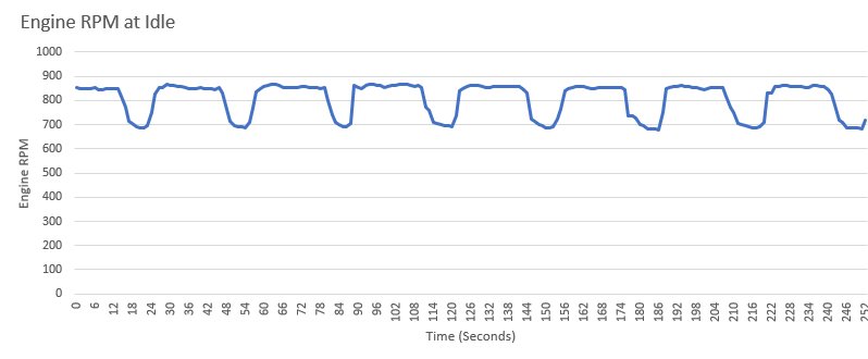

    Alright I am super confused and have been trying to find the culprit of this for a while.
    I have read through dozens of threads similar to this but seem to be unable to find a definitive answer.
    Problem:
    Fluctuating and rough idle.
    The idle on my 5vzfe goes from 700 up to 850, then back do wn... up... and so on.
    When the idle is high, it is slightly rough, not crazy shaking but it is noticeable.
    I have so far done the following (both because of this issue as well as getting this gal up on maintenance):
    - Spark plugs & Wires
    - Replaced vacuum hoses and tested for leaks
    - Cleaned the IAC (then replaced a month later after nothing changed)
    - Replaced the Throttle position sensor
    - Tried another throttle body from a scrapyard
    - MAF brand new, then cleaned again*
    - Fuel filter new (within 5k miles, 3 months)*
    - PCV Valve and tube also brand new. *
    *updated original post with these
    Here is a graph of the RPMs over a few minutes. Data taken from an OBD2 while running at idle.
    Any potential solutions are welcomed and any references to other threads and solutions welcome as well.

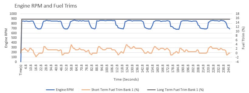

    What are the fuel trims?
    What do the AF/O2 sensor do when this is happening?
    What does the ECT temp read?
    Does the truck ever make it to CL? Or does it stay on OL?

    @TnShooter I have added this chart showing fuel trims.
    Coolant temp was reading at steady 87-88*C
    Has never had a CL for this issue
    I will have to do a re run and check if my OBD2 has o2 / af sensors (this is oxygen and what else?)

    OL and CL are Open Loop and Closed Loop.
    With those coolant temps you are most likely in CL.
    Long term trims are high.
    What scan tool are using?
    I like the graphing it provides.

    Do you have the AC on? Those pulses look synchronous with the compressor clutch

    That shows it cycles about every 18 seconds. The AC compressor doesn't run at 100% duty cycle otherwise it would overcharge the liquid side (you have pressure sensors on the lines). The IAC is supposed to raise your RPMs when it turns on, and lower it when it's off. What you're experiencing could be completely normal. If it shakes a lot, your engine mounts may be bad

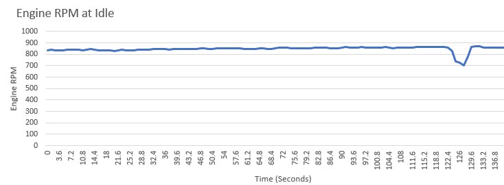

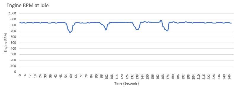

    Alright so you got me really curious and I repeated the test. It looks like it only fluctuates like that when the ac is on. Without it, idled for 10 minutes, no fluctuations or rough/shake.
    I inspected the AC components and the belt was a tad loose so I tightened it a little and resulted in the following:
    A significant change from original
    Decided to tighten it a little more:
    Got me feeling pretty dumb here lol.
    So, I understand your explanation about the duty cycle causing the fluctuations.
    Side note: this is the ONLY difference I have been able to make so it seems like this is the correct path. (all other part replacements resulted in the same graph as the initial post, no changes)
    I do not understand the part about the rough idle though. I initially thought engine mounts too but why would it only be rough when the AC is on?
    It is fine at idle with no AC, as well as driving.
    With the AC on, it is rough, but if I give it just a liiiiiitle bit of gas, it settles down and does not shake at all.

    Low RPM creates the lowest frequency oscillation. It can move more in one direction before switching, so you get the biggest feedback. AC on = more load = greater amplitude. Higher RPM is higher frequency so the mounts dont have to work as hard
    Digiratus likes this.
