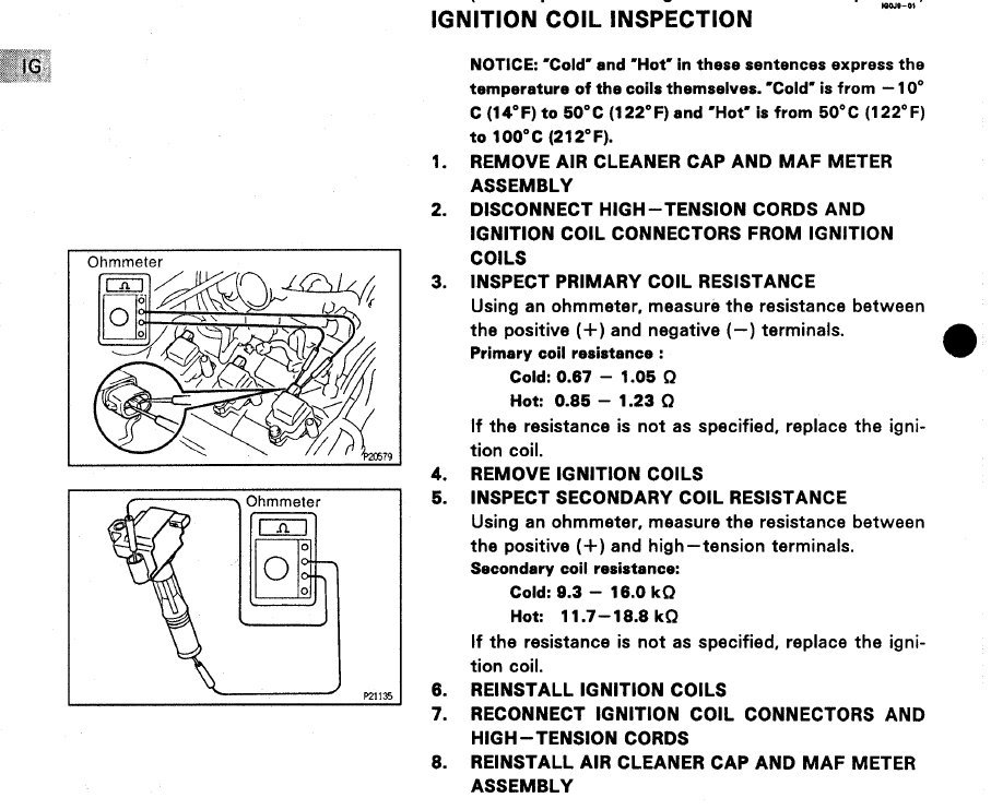

    alright so i tested the ignition coils following this FSM
    and at 88* F I got 1.1-1.2 all around for step 3, and I ~13 on step 5

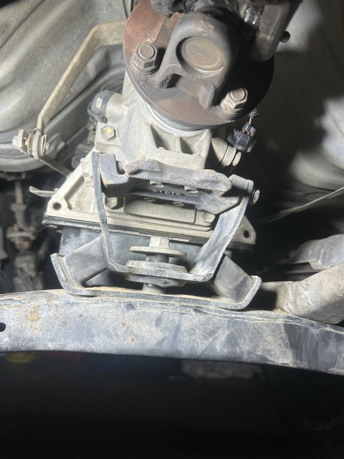

    final update... ended up being the transmission mount. Since it was bad when i first replaced it (rubber completely disconnected) it was causing this. I replaced it with the "upgraded" one from 4x innovations but it made the rumble sooo much worse it was unbearable at idle. Ended up swapping to one that oreillys had and its calm and a pleasure to drive once again.
    I fell victim to the "oh it couldnt possibly be that since its new"...
    So in my experience the 4x innovations transmission mount isnt worth it unless youre willing to deal with that rumble and your doing a strictly 4x4 build. For a daily driver I couldnt tolerate it.

    That's funny because I had a small rhythmic vibration (only detectable at idle) that was clearly coming from the engine. You could feel it with your hand on the intake plenum, steering wheel, shifter knob, or center armrest. I replaced my old OEM trans mount with the 4xinnovations one, and the vibration went away. The whole truck does now rumble (like you described), but it doesn't really bother me.

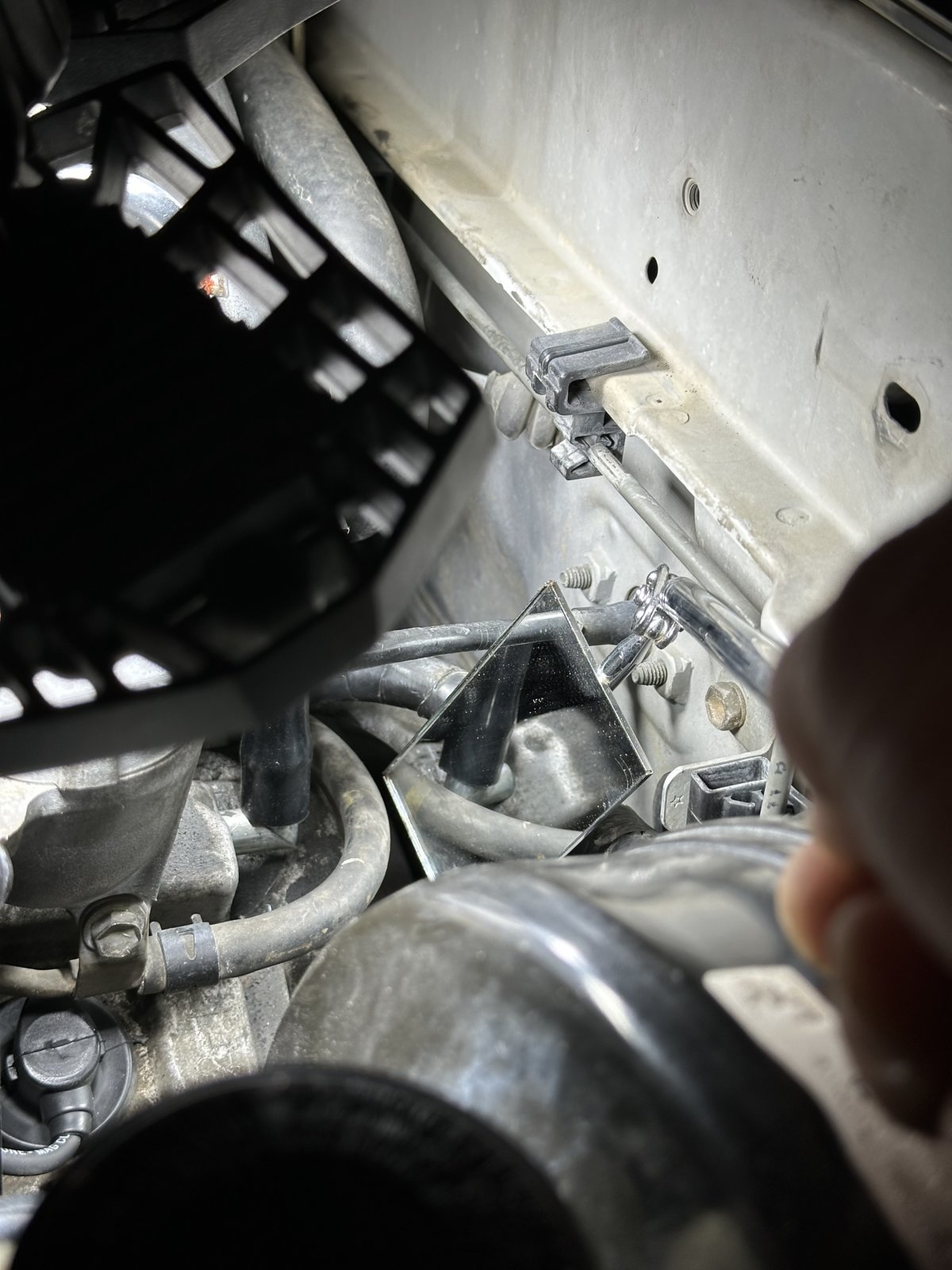

    Yea it’s jacked. I’m not getting any codes. Runs fine for about 5 mins and then a low pulsing idle. Do you know what that is called? It’s the crankcase ventilation hose no 2 on the driver side. It’s a hollow 90° tube that’s connects to the hose running to air intake. I’m about to pull it right off and it's leaking like mf. Is it’s supposed to be a different PVC connector there? I don’t know what it’s called to find something that works. It won’t fit if there’s a grommet in place. Is there an aftermarket or oem part# you can refer me too? I attached some photos to help explain what I’m asking. Thank you.

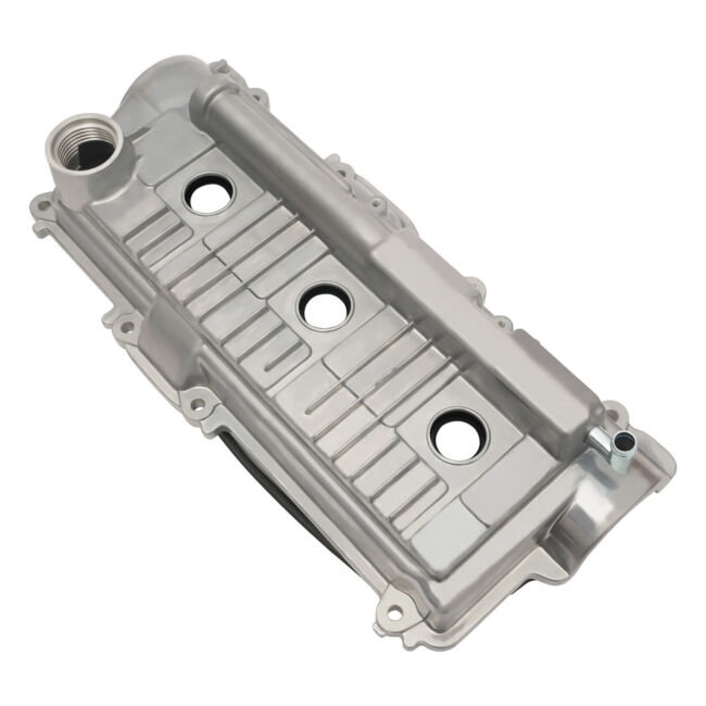

    From the looks of this you need a new valve cover? I dont believe that elbow is suppose to come off like that.
    ( im guessing, so maybe someone has seen this before and can correct )
    When I lookup replacement driver side valve covers, they all have that elbow attached.
    I cant seem to locate a distinct part number for just the elbow as I think its all one piece (or should be?)

    Get some green Loctite on that, and press it back in there like it never happened.

    Bro, I feel like an idiot not thinking about looking up a whole as* valve cover. I’ve spent days researching and parts shop didnt know either besides asking if it’s a 2wd or 4wd. Thank you

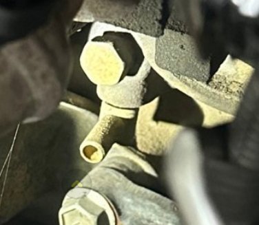

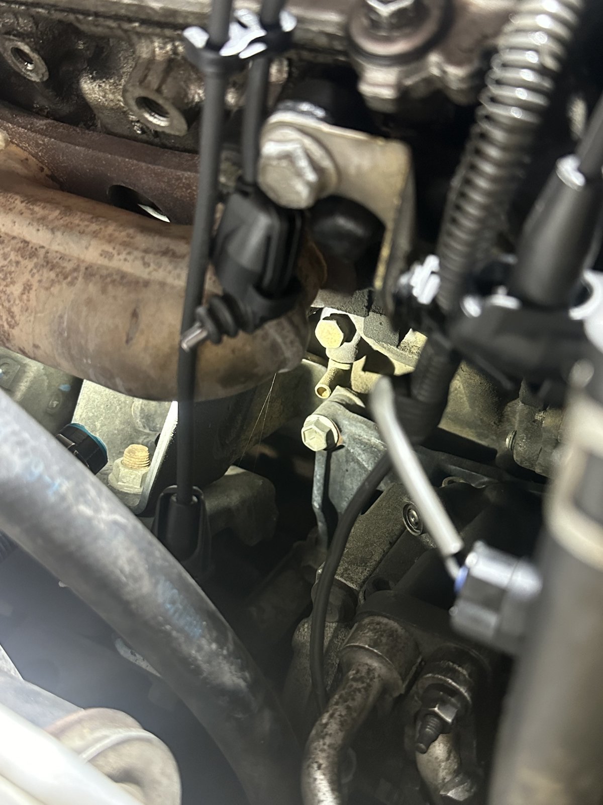

    That’s genius. Thank you. I had to figure fitting before I started doing anything. This other port on the L, below the headers…do I have anything to worry about? Anyone feel free to chime in….Ive never noticed until the other day.

    If you mean this (i just zoomed in )
    this is just a coolant drain to get coolant out of the block.
    So its fine. When you want to drain coolant from the block you can just attach a hose and the bolt above it opens/closes it.
    I know this bad boy all too well when it took ~15 flushes to get the crappy green coolant and rust from my system lol
