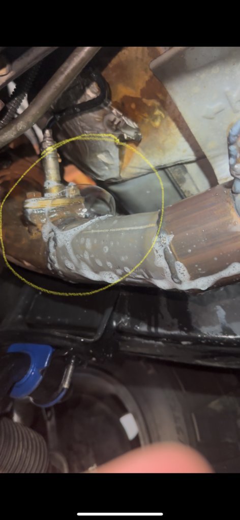

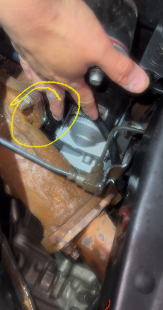

  2. Nov 27, 2024 at 5:46 PM
    #62
    monc1ne
    monc1ne Active Member
    May 10, 2015
    #155004
    31
    2002 tacoma prerunner TRD
    I’m still dealing with the bullshit lol. I think I’ve found all the leaks and it’s these MFs on the exhaust system. I could hear it but couldn’t find it. I found 3 earlier and the big leak is after the upstream O2 sensor at the welds when I replaced a new catalytic converter. Craftsmanship is non existent and I failed to check the work after. I should ask about warranty with craftsmanship. These welds are boogered. Smh
