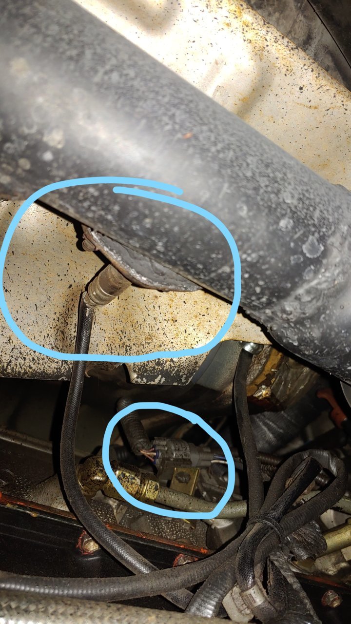

    The connector is connected to top of transmission
    If there is an easier way to get to it I am all ears
    Also from what I saw there are 2 O2 sensors, one in front of catalytic converter and one past it

    Yes, does not look like that
    Is that pic of auto trans?
    I will try and get a pic tomorrow, wire from the one I am talking about goes up over top and connector is attached to top of manual trans
    The back one is accessible

    Ya mine is auto. If manual is on top that sucks, but not the end of the world. The center console come out pretty easy
