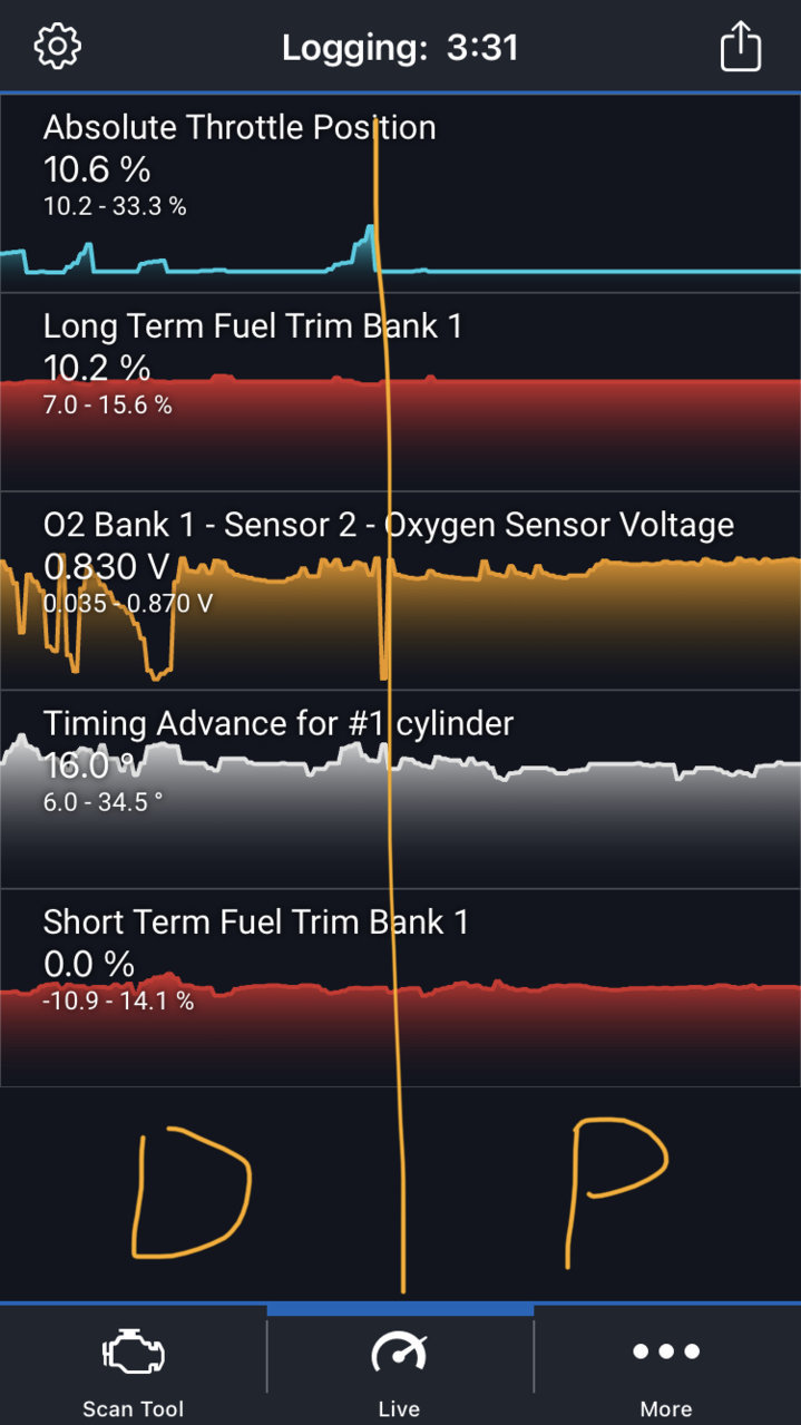

    Il be looking into the spark plugs and coils, can you look at this as see if something’s wrong? D=drive P=Park

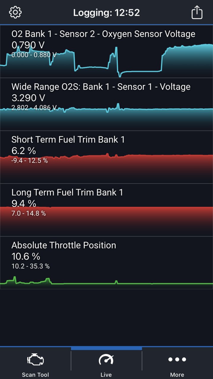

    First off, you are logging a wideband O2 sensor...I didn't even know we had those in these trucks. Learned something new everyday I guess.
    Second, I've seen worse fuel trims than that but what are your trims with load? You need to log the data and put it into a csv file then chart it in excel. You can then see how the trims behave in driving operations.
    Third, sounds like you have some sort of vacuum leak to me. Sounds like you're getting more air than is metered by the MAF thus the hesitation.
