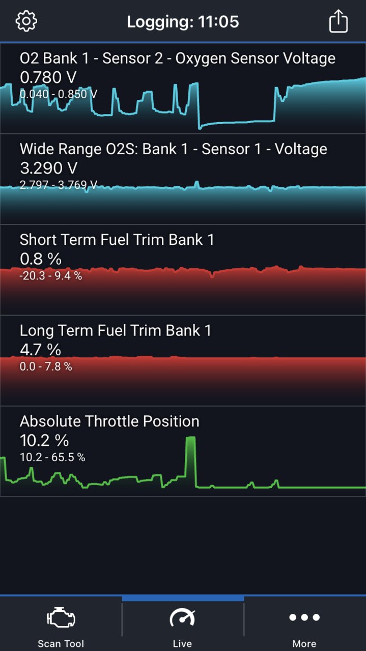

    UPDATE: I pulled the coils and there was oil on them and you can see the seals where blowing and sucking oil and dirty in and out of them so replaced the valve cover and tube seals, fuel trims dropped down to 5%
    problem still exists but it is at a drivable level but I get random misfires, I reset CEL after valve cover replaced and no CEL yet, I think I may be hearing a exhaust leak, it’s loader when I go from under to listen to it but I’m not sure us that’s an exhaust leak sound, I also took off the heat shield and didn’t see any cracks in the manifold (I paid special attention to the spot where they normally fail on the 1st Gen tacos)
    My guess is it’s leaking from the donut seals that’s in between 02 sensor and manifold (second gasket/seal from the engine first being the manifold gasket)
    last quarter of the readings (attached pic) is at idle the rest is like 50-60mph
    When I’m at idle it misfires
    When I accelerate lightly it misfires
    When I’m keeping steady gas/speed is runs great
    When I’m accelerating hard pressing down on the pedal it runs great
