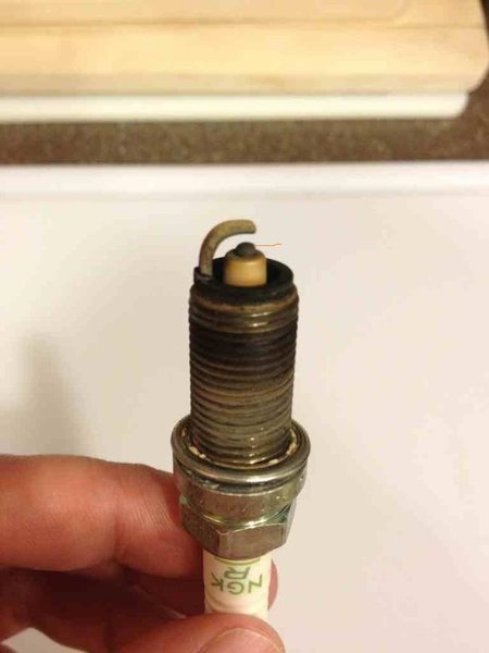

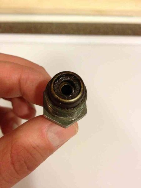

    I finally was able to do some of these recommendations. I changed the plugs (actually still had the original Denso and NGK plugs), the PCV, and cleaned the MAF, air filter, and throttle body. I don't have the original air filter assy.
    The PCV looked pretty well used...
    The plugs looked alright...
    So far the engine seems to idle better but time will tell. I'll keep this post updated as I know more.

    Glad to hear what you did helped. As for the plugs, they needed changed. When the electrode burns away leaving it round, it's time for a change. I painted a red line pointing at the electrode, you can see it if you blow up the picture..
