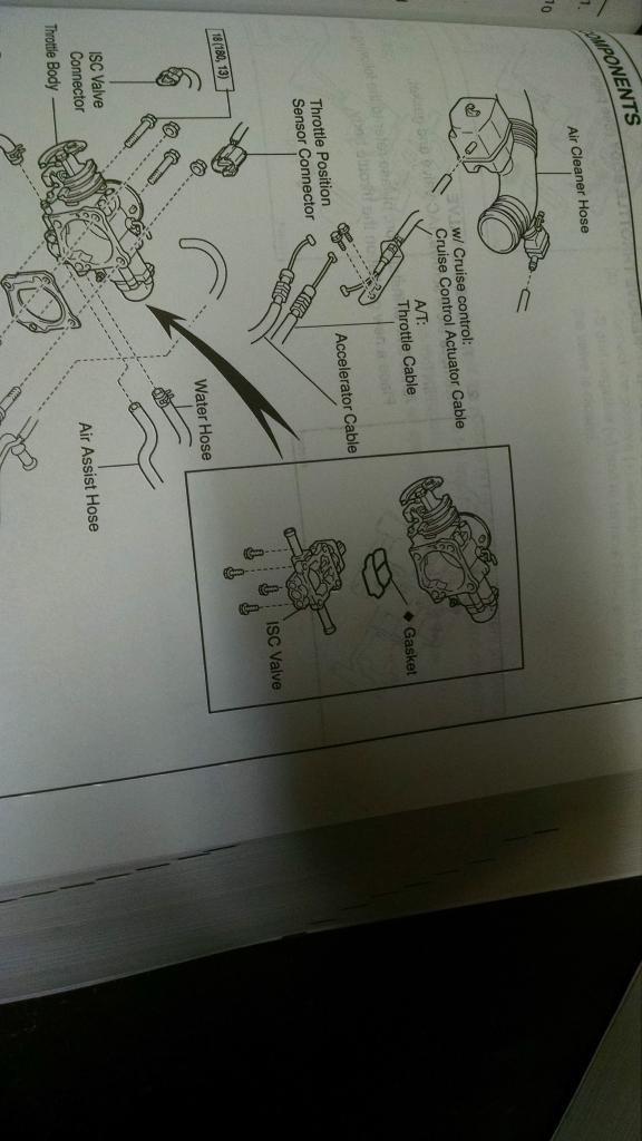

    nagorb
    nagorb Should be a dang perma mod
    Feb 28, 2011
    #52025
    9,352
    Alabama
    2001 dbl cab 4x4
    From an 01 FSM but it also shows it in the 03 FSM.

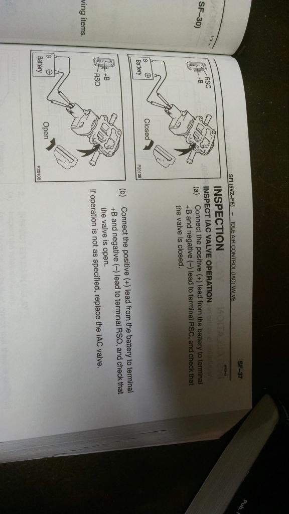

    so the IAC or ISC valves are the items that are often the cause of rough idle because they control ther idle air mixtures your engine gets.
    do you have anything that looks like what is shown in the pictures above?
    the way it works is engine coolant runs through the tubes so it can pick up the engine temperature and based on that temperature the air valve opens or closes to adjust the extra air going passed the valve body butterfly flap at idle

    pretty sure he mentioned it in a previous post, but that manual is an 01 so it's a little different
    ISC = Idle Speed Control?
    I believe they switched production early "during" the 2003 year when the last of the 4Runners were done and gone if memory serves (think a few '03 had the previous TB)

    Nagorb: yes i looked at your pic of the manual, no there is nothing resembling the iac or icv... Sorry.

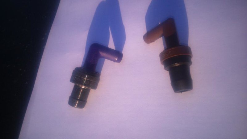

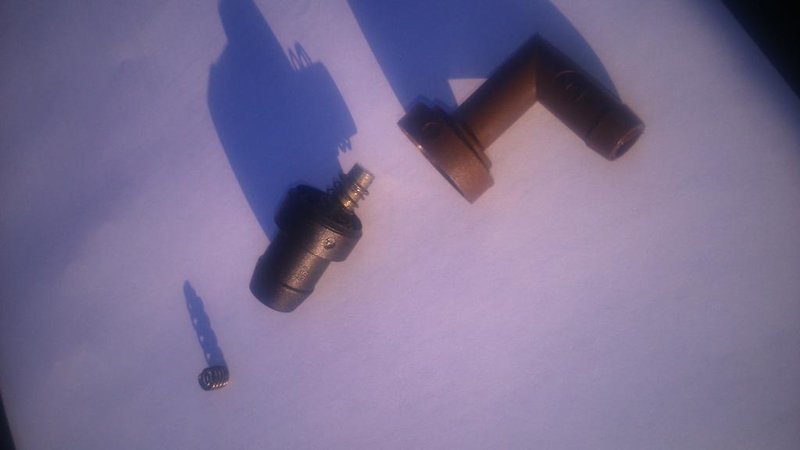

    Ok, another sitrep. Seafoam didn't smooth out my idle that much, maybe a hair, and to be clear i DID NOT soak my cylinders, only introduced the seafoam through the pcv hose. however, i was taking the advice of whoever mentioned a vacuum leak and was spraying down all the vacuum lines and such with carb cleaner, and found no leaks. Then i was fiddling around again with the pcv and this time the damn "new" O'Reillys special broke in half. piece of SH!T. Cost me a 40 minute round trip, and another 10 bucks from the dealership.
    Fwiw, buy oem!
