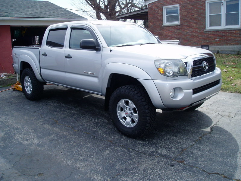

    2011 DCSB, TRD OR, 5100's, 885's 285/75r16 Cooper STT PROs.
    I never had 884's.....I used 2" top plate spacers with stock struts prior to the new lift, then 885's. Had 1" block in rear with the spacer.
    When I did the 885's I also installed the AAL, removed 1" block, for a net increase of 1" lift in rear.
  4. Feb 23, 2016 at 7:04 AM
    #44
    Bluegrass Taco
    Bluegrass Taco Politically incorrect low tech redneck
    Jul 27, 2015
    #160391
    23,099
    Bill
    Mt Washington Ky
    My stock rear leaf pack was 2+overloads. I used the single leaf AAL IN ADDITION to stock leaves, retaining the overload. I'm running empty 98% of the time, but occasionally tow a light travel trailer. Current setup seems to work really well. I have NOT done a long distance tow with the trailer YET, but see no real issues. It did OK with just the stock leaf pack. Ride in the rear is firmer without being too stiff or harsh. Excellent ride at highway speeds. Rides like a 4wd truck at lower speeds.....After owning 17 different 4wd trucks over the years, I'm happier with this setup than anything I've tried up to this point.
