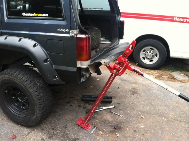

    While I have everyone here, instead of making a new thread (couldn't find my answer to this question), if I got a hi lift jack, and I have side steps, where would I jack up the taco if I needed to put the spare in?
    Edit: I have 4 inch oval side steps

    Don't use your hi-lift on standard tubular step-bars. They aren't designed to support the weight of your truck like sliders are.

    yeah i kinda figured that, so where would be the best/safest jack up point?

    with stock bumpers and a hi-lift? Trailer hitch/drawbar. You shouldn't jack from the front bumper at all, just all plastic. I'm pretty sure the stock rear bumper would end up like this:

    yeah my bumpers are all stock and i would not want that to happen to my bumper haha. so trailer hitch for the rear.....not sure what the drawbar is but im guessing thats up front

    Best/safest would be to skip using a Hi-Lift type farm jack since you don't have sliders and armor bumpers. There are few pieces of equipment that will literally kick the shit out of or kill offroad newbs and wannabees like a farm jack. But if you are determined to try and hurt yourself and/or the truck one of these will lift one rear corner to change a rear tire. http://www.amazon.com/Hi-Lift-Jack-BL-250-Bumper-Lift/dp/B00042JSNY/
    If you just need to lift a tire to put rocks, limbs, or traction boards under a corner then one of these is the ticket. http://www.amazon.com/Hi-Lift-LM100-Jack-LM-100-Lift-Mate/dp/B00042KGWG/
    In the end your stock screw jack plus a cheap bottle jack and some random pieces of lumber will do most anything you will be able to do with a farm jack and cause less havoc in the process.

    Not on the oval side steps. For a Hi lift you need sliders. Welcome to TW. Now hand over your wallet.

    haha yup, I've already spent too much money and only more to come. I wanted to get a hi lift jack because the truck is higher than stock, and I havent even tested the stock bottle jack to see if it would lift it if i haver had to use the spare
