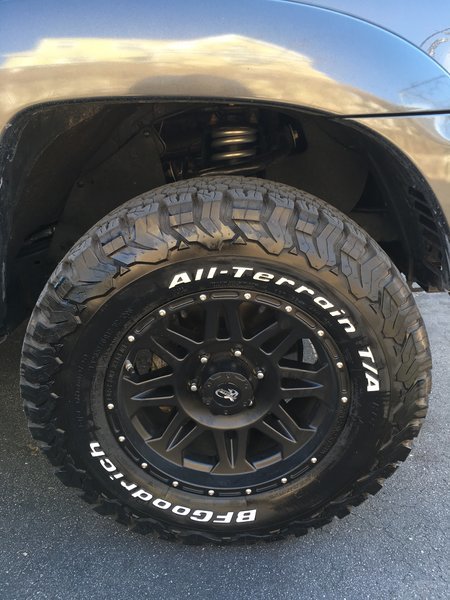

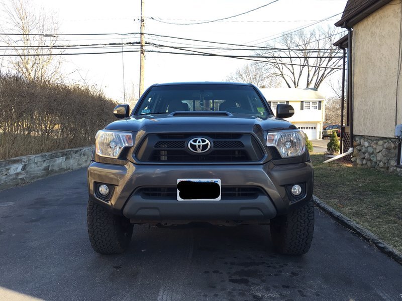

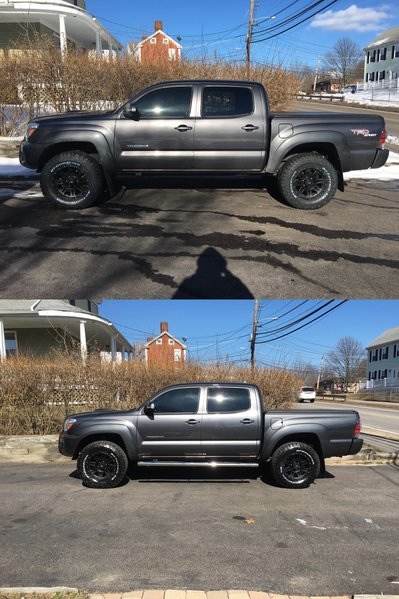

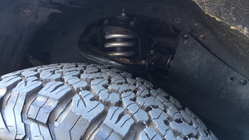

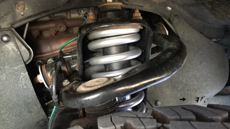

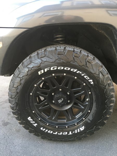

    ok guys...........
    results are in.
    purchased from wheelers-off road
    eibach 620 coils
    1/4 top plate spacer
    _____________________________
    before installation:
    bilstien 5100 with stock shocks set at 1.75
    factory 4 leaf pack in the rear
    After installation:
    bilstien 5100 with eibach coils set at 0.0
    factory 4 leaf pack
    custom alignment number request
    installation took about two hours. the guy who was working on it tore the passenger side ABS wire, which made the dash light come on after the eibach installation. They replaced the wire with the OEM part, they took responsibility which is rare these days.
    after, I got an alignment. I told the technician to give me 0 toe, 0 camber, and max out the caster, preferably to 2.4.
    did some reading on here and apparently those numbers are the best.
    below is the transition picture as well as the alignment specs and pictures of the coils.
    i am really starting to dislike the tube steps that ive had on for two weeks now, so ill most likely end up selling them.
    the truck was more level before the eibach install, and is currently a little higher in the back, like, a tiny bit.in the original post i stated that i'd rather be a little less level than before, instead of being nose high. i got what i wanted.
    interesting effect with the top plate spacer, it seems to have caused a reverse effect, making the driver side higher than the passenger side. I really dont care, its a negligible amount.
    After driving for about 30 miles on various road types, I'd say its better than before, but not night and day. There is improvement, not as harsh, and its eating up bumps and pot holes well.
    Ive noticed, though, that at a complete stop when i go to accelerate, when i take my foot off the break pedal, there is a studder. could that be from the coils?
    Also, I really like the silver coils. Definitely bad ass.

    looks good.
    said it on page 1, the ride quality is from your tires. Im in the same boat. it just is what it is.

    Looks good... Should've set the billies at .85 and got some different tires.....looks good though...
