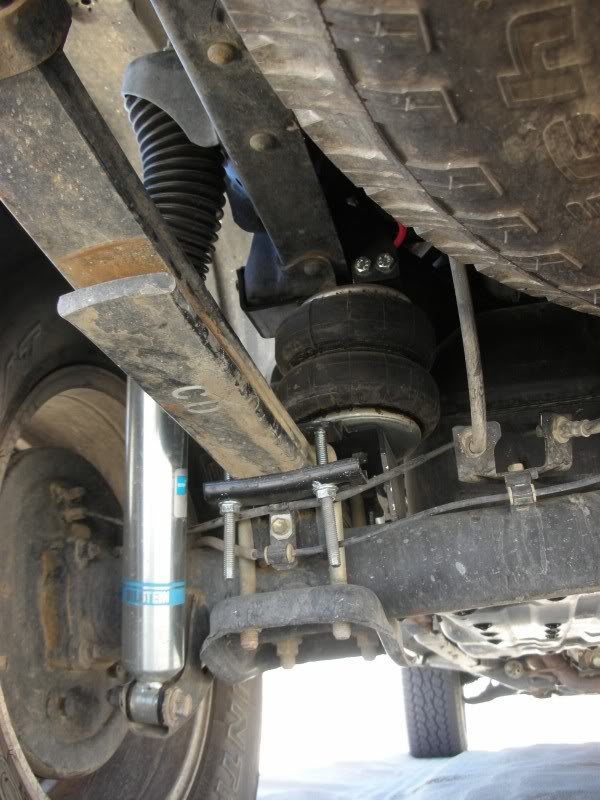

    Air springs are usually called 'air bags' and they go where the bump stops were to supplement what the leaf springs do...
    Basically an inexpensive cure and you can adjust how much air (10-100 psi) to put in them for the degree of firmness you need. Stops the bottoming out from heavy loads when your stock springs are too soft. The brand is Ride Rite, made by Firestone. Shraeder valves (tire valves) are installed in the back bumper for each air bag... You just add or remove air their to change the firmness and ride height. Fancier set ups have an air compressor on board and you can adjustm, on-the-fly.
    Here is the left one... on my '05:

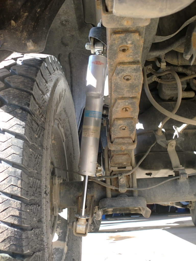

    Could try this...
  17. Jan 21, 2011 at 10:14 AM
    #17
    dante087708
    dante087708 [OP] Member
    Jan 20, 2011
    #49596
    9
    Dante
    Houston,Tx
    06 PreRunner TRD Sport
    What is this? Explain please.
  18. Jan 21, 2011 at 10:17 AM
    #18
    Chachie
    Chachie Well-Known Member
    Dec 23, 2009
    #28047
    1,849
    Justin
    Nor Cal
    '06 TRD OR, 4x4, Auto, 6" Fabtech, 35's
    Locker mod, Anytime fog mod, always 400w mod.
    Well im not sure what your plans are for the truck but more than likely it is pretty impractical for you. It is Allpro's 3" leap pack with a set of billie 5150 piggie-backs. We just got back from the desert and aired down a little, we were doing about 60 on washboard and felt next to nothing. In all honesty, if you air down, you will notice a big difference. But with these trucks, you are going to get a rough ride on dirt with stock suspension, thats just how it is.
