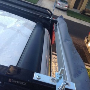

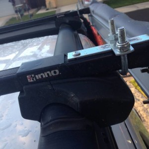

    Love the rig by the way. A Bestop will be my next purchase. Is that the 1250mm/50" ARB awning? Looks great on the double cab. I'd like to see how you mounted it to the OE roof rack/yakima crossbar combo. I'm thinking about doing that same setup.

    Thanks. yes it is the small 1250. And I mounted it with 2 L brackts, 2 ubolts, and 2 sheet metal screws. 2 dollars worth of hardware
