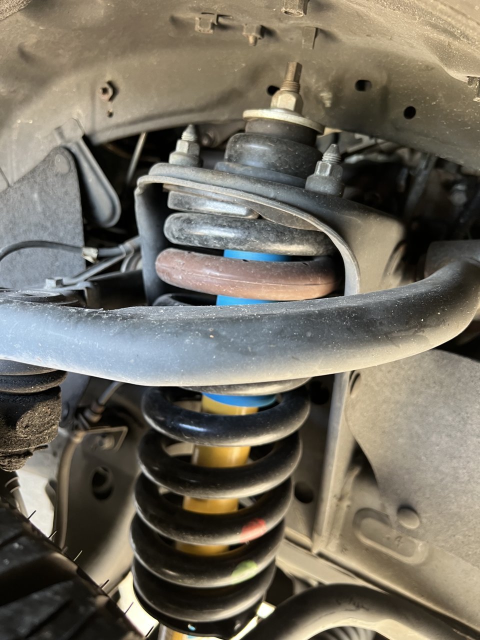

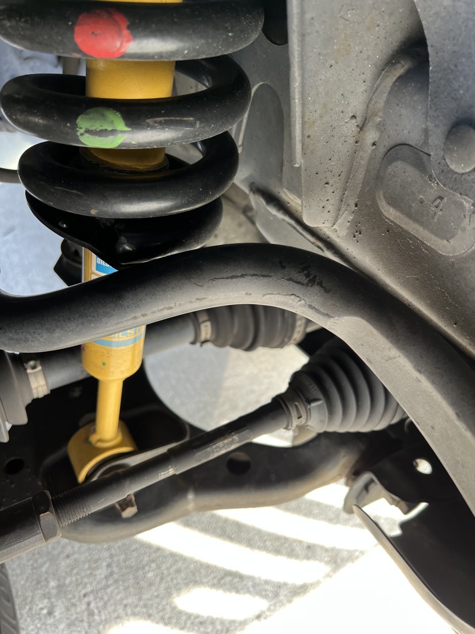

    Pics of the install? I'm being they tightened everything at full droop which is no bueno

    Pic how? like pics of my truck as it is now? I don’t have any before pics or during instal since dealer did it

    Exactly what I said, Pics of the struts installed in the front. Clearly showing the whole assembly, spring perch and top plate.

    Let us see pics of the install. Sounds like they fucked it up. Sure the 3rd gen coils are 700lb vs the Gen 2 450lb coils but they should not make it ride like crap.

    Idk man even with the 700lb coils it still gave a very comfortable ride. All I could say that it was a bit more firm but still a soft ride with better handling with the Gen 3 TRD OR front shock assembly. It should not be giving anyone a rough ride even with the 700lb coil springs unless he got the TRD Sport shocks. Those do ride like crap. I would hope OP could just post a pic so we can see if they installed anything wrong or if they installed the red/blue sport shocks in the front.
