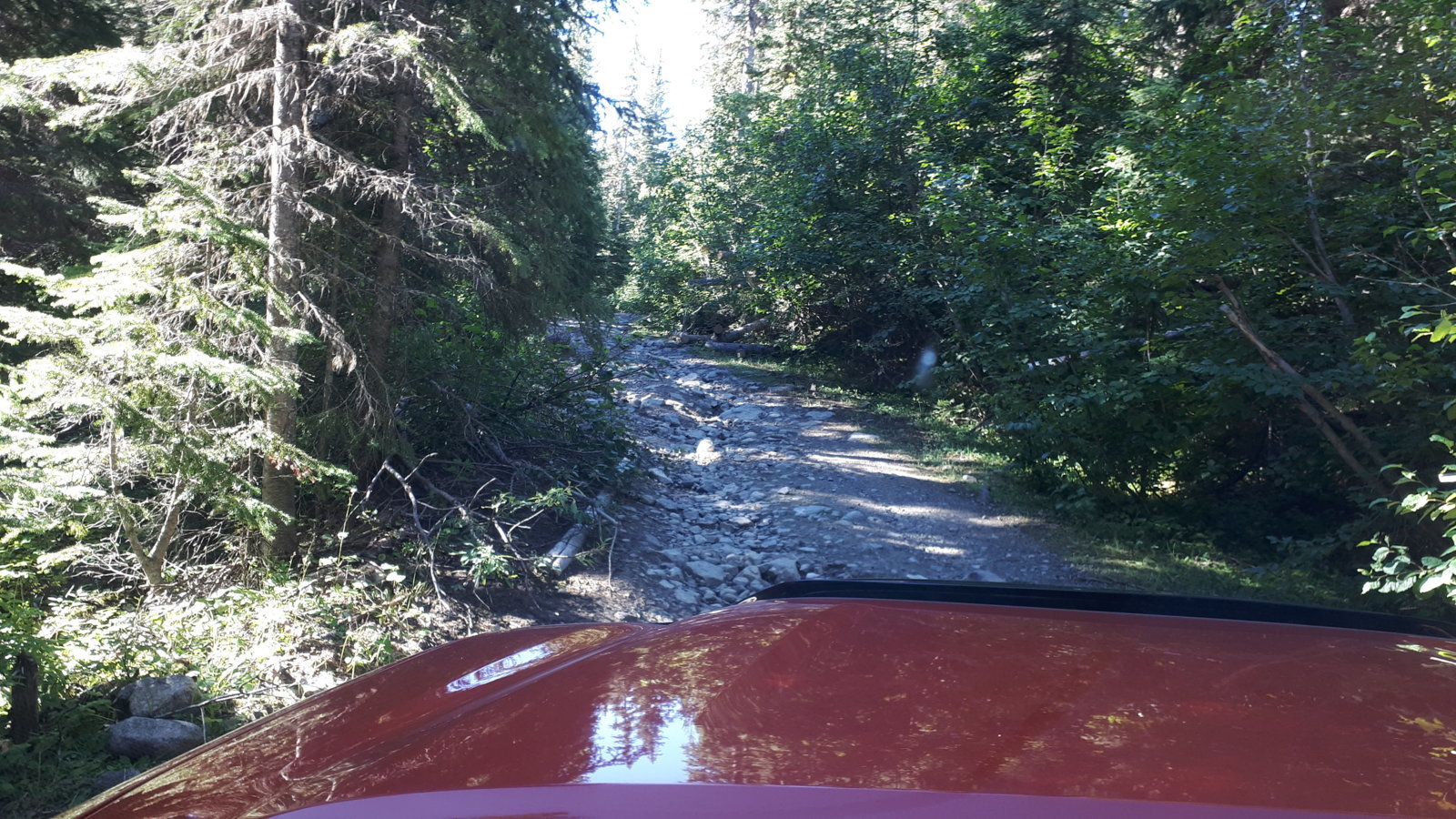

    Just added toolbox and roof-rack to haul my fishing boat 100's of miles into the backwoods every week. Goodrich K02s, Bilstein 5100 front and back, no lift.
    On pavement, my 32 inch E load KO2s are always at 30 psi.
    No lift, Bilstein 5100 and Firestone air bags in the rear. Yes, every bump is felt pretty hard, but it rides smooth if the road is.
    I will put 800 pounds of gear in the bed, and never inflate then to anything over 32psi.
    My previous set of KO2s never suffered any uneven tread wear at these psi, and the current set wearing even as well.
    I air down to 22 psi once every week for offroad trips on brutal washboard rocky trails. Back to 30psi at end of day.
    Offroad on these trails at anything over 24psi with E load tires and it is too bumpy. 22psi works well offroad.
    2016 TRD OR access cab, 6 foot box. Typical offroad trail shown with these tires at 22psi.
