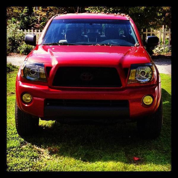

    Still loving mine! The stuff from TRS is flawless here's mine for a little more motivation for you guys that are on the edge.
