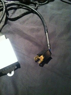

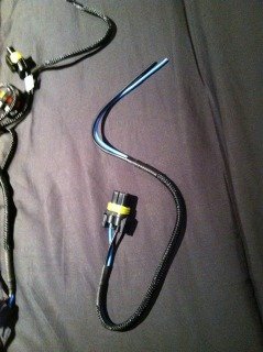

    I think I understand how everything goes together but i cannot figure out where the three pronged plug and the extra two wire adapter go?
    :confused: Help please hahaha i feel dumb

    Blue two wire adapter is a test lead for a 12v power source so you can align your lights....the other one I have no idea...not that far yet

    its the old halogen plug adapter thingy, i think

    As mentioned above, the one wire is a test lead so you can run the ballasts to a 12V power source during assembly without having to hook everything else up.
    The other piece, the three pronged plug, plugs into the headlight power socket and will provide switch power to TRS's relay circuit (the headlight circuit will not be powering the ballasts, only telling the relay to fire the ballast and to control the high/low beam solenoid).

    OOOHHHH ok thank you! So sense i just have to plug the one in, do i just tape the one on the passenger side off?

    Pretty much, yeah, just tape it off well and zip tie it in place somewhere.
