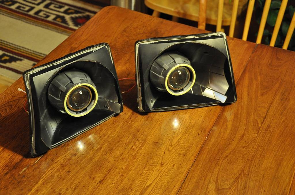

    still some things to work out, but I figured I'd throw a pic up.
    gunmetal instead of chrome.

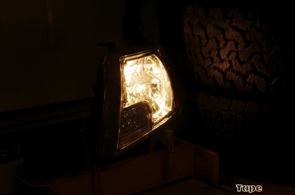

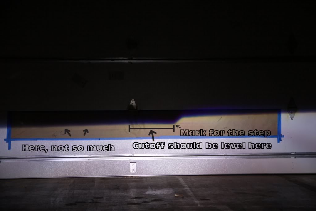

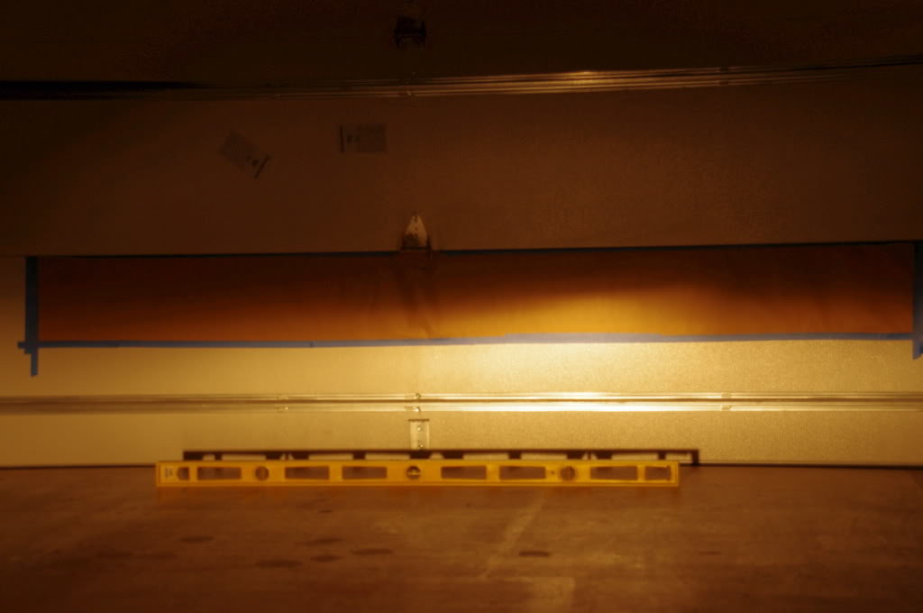

    The lock ring should have a grippy texture to it? That is meant to use round nose pliers on, but needle nose pliers will work. Its just like replacing the switch on a tactical flashlight. Place the pliers in apposing notches, pinch, and turn.
    As for aiming, I make a metal or wood jig to hold the light in the same position, it doesn't have to be level, as long as it is holds the light in the same position every time. Then you can mark the position with the factory bulb, and match your projectors to that.
    Here are some pics from the last time I changed my lights. I'm waiting on my TL's to come in now.
    Light on the jig:
    Stock cutoff marked
    FX-R marked, with some random info :D

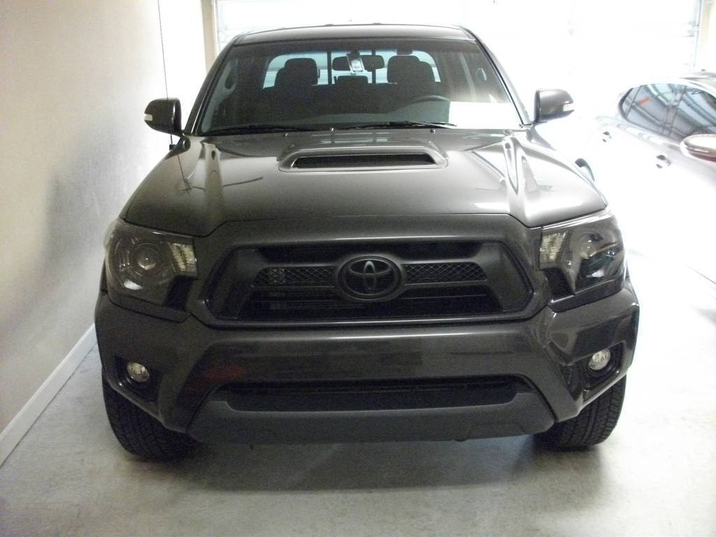

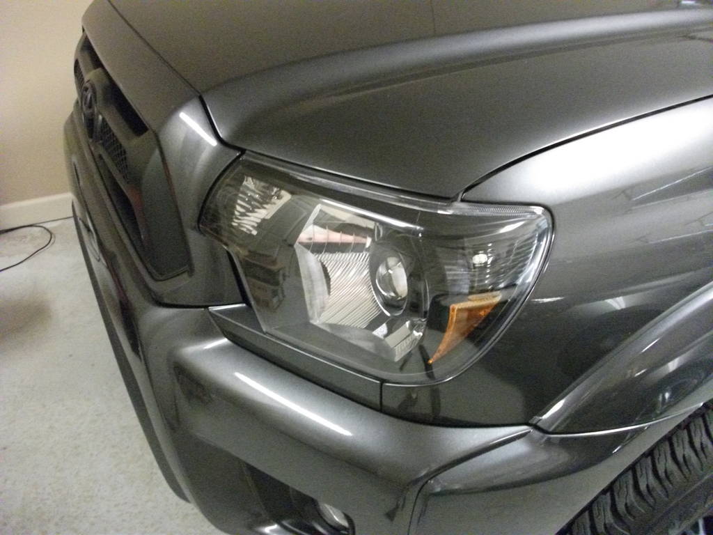

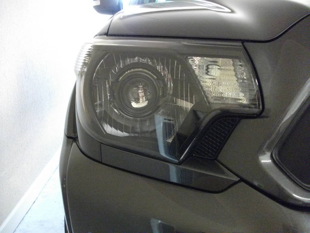

    Just a few pics of my install:
    Also, found a way to adjust the height a little quicker. On the driver side I used all the extensions I had for my socket set, about 20" worth, and was able to slide it along the side of the engine bay, between the fuse box and the inner side of the fender wall to get pretty straight on with the 8mm bolt. On the pass side I loosened the washer tank and was able to get on it with just the socket on the ratchet and using finger tips to move it.
    Still having the problem with the bulb spinning, really just on the pass side for some reason. I am going to take it apart and try adding another washer in there to try to keep more pressure on the bulb in the notch.

    ATL
    ‘22 4Runner, ‘14 F150, and I’ve had 4 Tacomas (‘12, ‘15, ‘16, ‘18), 2 FJs
    Silver ring around the lens = not Minis. :p
