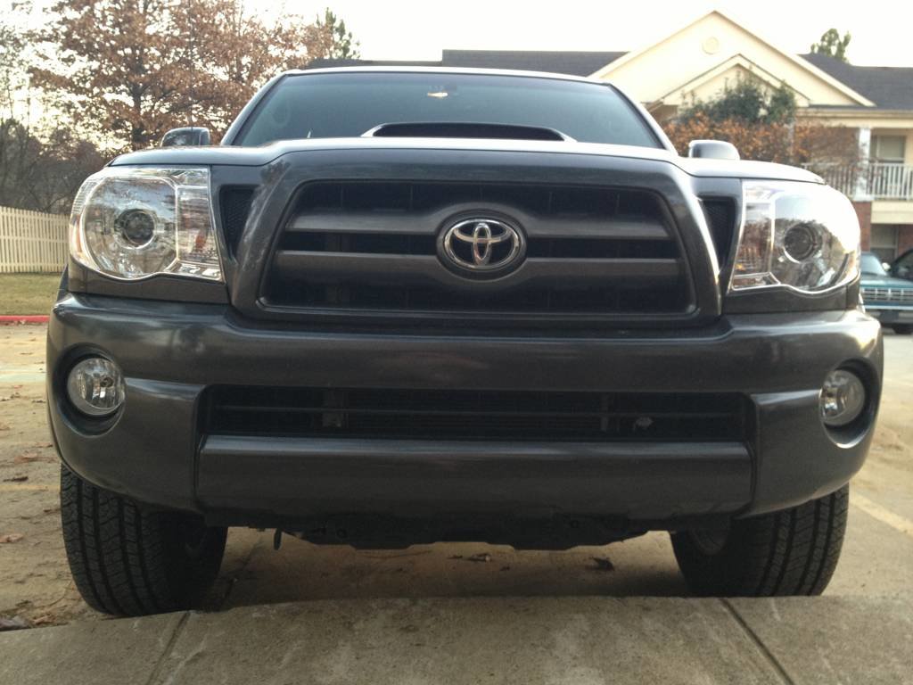

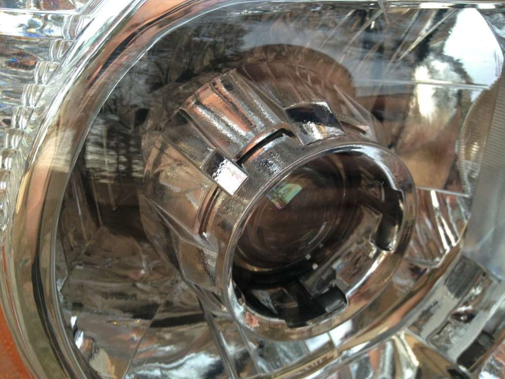

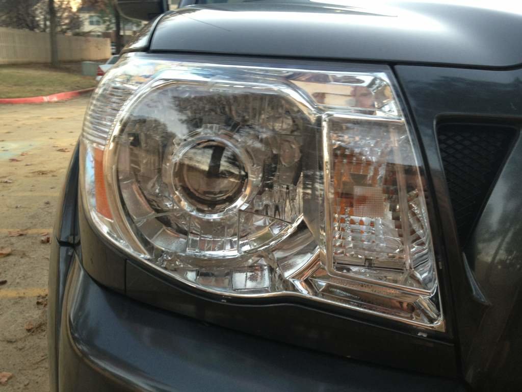

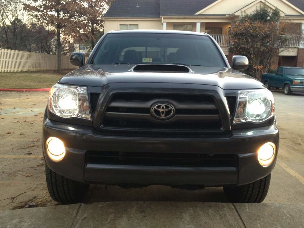

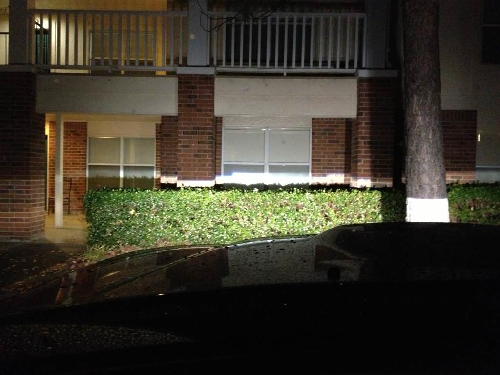

    Well got that fixed. Just added a simple rubber o-ring between the metal ring and the rubber washer and it locks up tight! I am done, for now ;) I will have to tear it all down again to get the alignment completely level since I just eyeballed it the first time and am off by a couple degree's. As long as I'm not wall hunting with the lights it's not noticeable at all, so I am gonna roll with it for a bit while I tackle my suspension mods :D

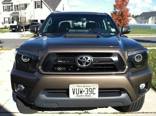

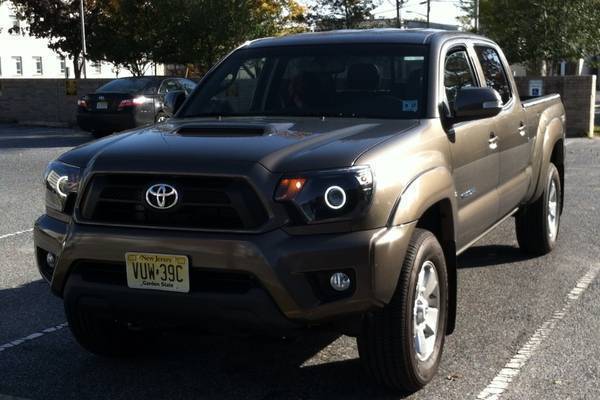

    A few pics

    Got mine installed. Went with chrome housings instead of painting. Used to have sport lights (black chrome surround) but bought new chrome ones instead because I didn't care for the black chrome look. Might go back to the black chrome but I will still use the aftermarket lens as my stock ones were really scratched and fogged up (probably why I didn't like the darker surround, the bad lens was even more noticeable). The aftermarket lights I bought also have a clear turn signal vs the stock yellow lens.

    They look so tiny... are those the minis?

    No they are the 2.5" FXRs.
