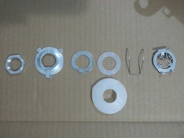

    Thanks. So what is the thinner, non-concave, silicone washer for?

    On my mini d2s kit there were 3 washers. The big white one goes between the back of the projector and the bowl. The 2 smaller ones go on the threaded part that sticks through the stock bulb location. I think on the mini h1 kit, there is only 1 washer though. So it goes on after the alignment ring, followed by the locking nut to secure the projector to the bowl.

    There's actually two washers.

    There's two washers for the mini h1 kit but you only use the thick concave one inbetween the reflector bowl and the projector. The other washer is for all non H1 kits I think.

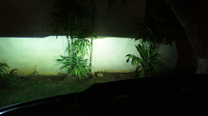

  19. Dec 6, 2012 at 10:55 PM
    #379
    WYOTAC
    WYOTAC Well-Known Member
    Dec 26, 2009
    #28176
    206
    Joel
    Montana
    06 AC SR5 TRD OffRoad Desert Sand
    Billstein 5100's, OME 884, AAL, Black Badging, TRD exhaust, Window Tint, ARE shell, color matched Satoshi grille, Hella 500's behind grill, horn relocation, Front Skid Plate, shovel mount in bed, illuminated 4X4 switch, bed lights in side pockets, Avid Offroad rock sliders, BHLM, yellow sleeved fogs, Custom snowboard rack crossbars, toolbox mount with jerry can and bike mounts, plastidip rear bumper, in-dash navi/touch screen, TOYOTA tailgate vinyl, Mini D2S Retrofit.
    So I finally got to the point of aligning these things and lucked out; They are pretty close with just cranking the locknut down on the alignment washer. The driver side is just a tad off counter clockwise. Only thing is that there is a weird flare above the step up on the driver's side. Any idea's what this is from?
  20. Dec 6, 2012 at 11:52 PM
    #380
    adio
    adio Well-Known Member
    Sep 11, 2008
    #9165
    2,646
    HI
    2015 INFERNO TRD PRO
    Bought, not built:-P
    hmm it maybe the bulb?? which kit do you have?
    here's mines, D2S kit.
