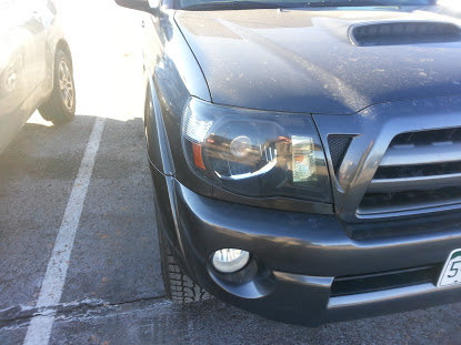

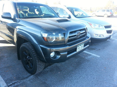

    I'm in the same boat, probably a little fine tuning left to do. 2nd guessing going with Osram 66240 SVS 4200K's instead of a 5000k bulb. Definitely not unhappy with the light output of what I got though. Realistically I notice it not being a pure white when adjusting the lights or aimed at my garage door, but not at all while driving.
    May get some better photos later
    [​IMG][​IMG]

  16. Dec 19, 2012 at 2:36 PM
    #396
    ambiguous
    ambiguous Master Retrofitter @RECHELON/AESTHETICS Vendor
    Jul 30, 2012
    #83730
    1,156
    Burt
    Portland, OR to SoCal
    2012 DCLB TRD
    Give the bulbs some time. They will color shift to more of a bluish hue. They look pretty yellow right when you get them.
