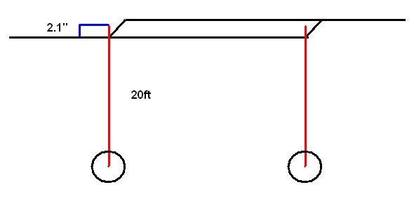

    Correct.
    DOT adjustment is with the vehicle 20ft from a vertical surface, the lower line on the cutoff should be 2.1 inches below the centerline of the light.
    The beginning of the angle on the cutoff should be directly in front of the centerline of the light.

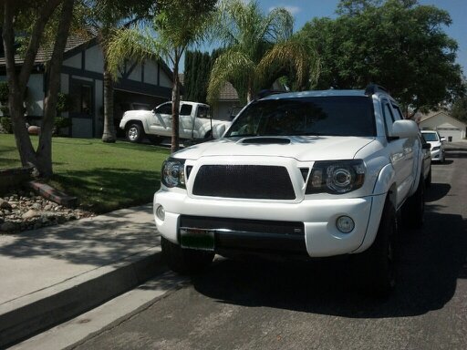

    Done with mine! Had a couple of hiccups but I pulled through! :D

    Very nice dude! Those look good on your truck! I still wish I woulda bought a white truck.
