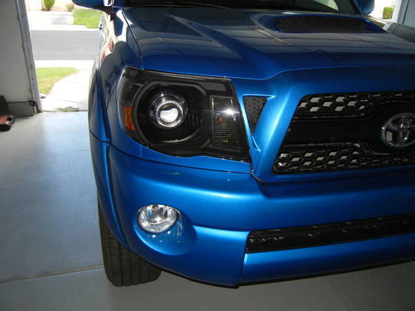

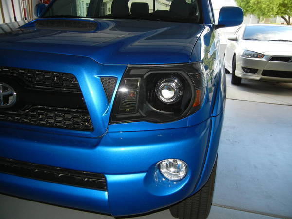

    Finally finished. Think the painting turned out to be the worst part of the whole thing. Kept messing up and because they *have* to be perfect for my own sake, I would have to re-sand and repaint. Such a process this was, so glad its over lol.
    Thank you TRS for this group buy, and everyone who helped make it happen.
    Here's my pics:
    By the way, anyone know why my Left Headlight has a bright spot being sent out and not the left? I double checked the bulbs and they both look like they are in correctly. Think its supposed to be more of an even output like the right. Any ideas?

    2011 PreRunner TRD Sport L/B Grey Metallic
    -Satoshi Grille Upper/Lower/Triangles -LED Map Lights, LED Dome Light, LED License Plate Lights -No front license -Wet Okole -Weather Techs (digi) -Running Boards -Bed Extender -AFE Cold Air Intake 2SI Dry Filter -Tailgate Hose-Clamp Mod, Tailgate washer Mod -Combi chain lock on bed extender -no chime w/ key in ignition & open door -Fog Light anytime -Slim Cubby's 3kHID fog -bumper plugs -keyhole plug -TRD license plate frame -combi-lock storage -rear TSB -window tint -camera mod -Painted radiator/engine covers -LS460 RetroFit -Bed Tie-Downs -LED Gauge Cluster, radio, clock and AC -Bed Mat -Extra DRings -Painted center console, radio unit, ac panel, overhead console.
    sometimes there is a minor flaw in the build of the projector? maybe the projector itself or the lens...... iono

    URD TCAI, TRD Seat covers, WeatherTech Liners, BHLM, DTRLM, 6000K HID Heads, 3000K HID Fogs, Black Valence, Custom license plate mount, LED interior lighting, Pioneer 4200DVD, 2 10" infinite subs behind rear seats, spidertrax spacers, 265/65/17 Dynapro ATM with powdercoated stock wheels
    That's a bummer! You should have checked them prior to closing them up. On the bright side, I'm jelly of your headlights! I wished i would have painted my bowls black now! oh well

    Yellow-Wire Mod, Any-time backup camera, Bilstein 5100's @ .85, Rear TSB Springs, FX-R Projectors
    I checked them when they first came in and weren't like that but when I was gluing them all of a sudden they were >_<. I figured it was an adjustment or something and just continued since I was already in the process. Oh well I guess. And thanks about the lights :) I'm impressed on how well they came out too. It was such a debate on painting the bowl and/or shroud.
