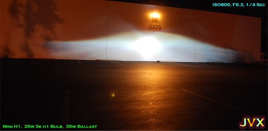

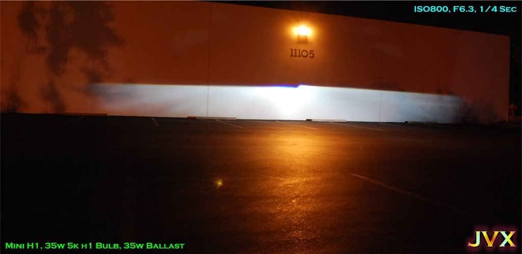

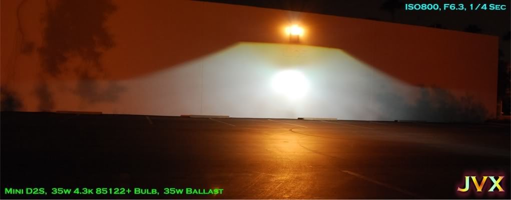

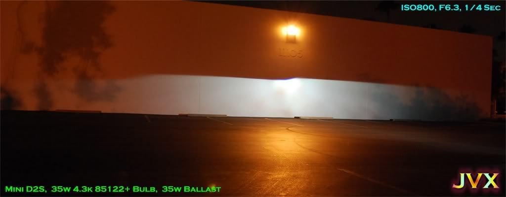

    From what I've read both of the Morimoto's are going to be easy to install....neither should require cutting of the reflector in the Tacoma.
    Here is a really good link to a discussion that happened a few years ago. The MH1 has since been upgraded to Gen 5, but the basic pros/cons remain the same. Pay close attention to post #7, Matt from TRS has a really good breakdown on the main bullet points of any projector and which of the two Morimotos is superior in either.
    http://www.hidplanet.com/forums/showthread.php?33149-Morimoto-Mini-H1-vs-Mini-D2S
    Hope this helps.

    NICE comparison... Keep in mind that one of these is 4300k and one is 5000k, but look at that high beam cutoff on the DS2!

    H1 looks a little wider, but it's more rounded.
    The DS2 looks to be more of a "band", filling in the lower corners.
    That's a big help for mountain roads when you've got deer in that area.
