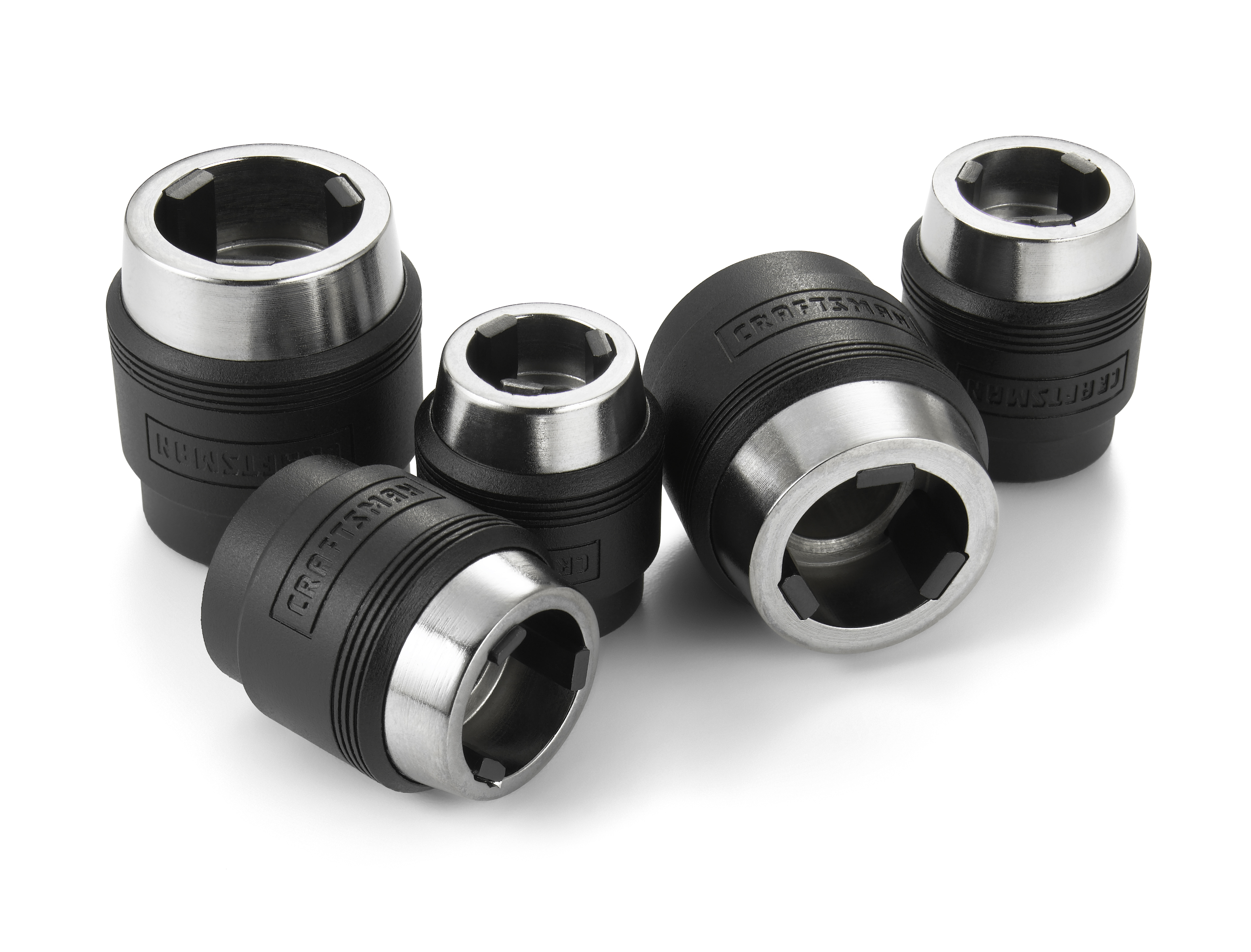

    Anyone know the best way or the best socket set to remove the 12 point head bolts on the head cylinder? Mine are rounded and I don’t have a welding machine or know how to weld

    Or heat the head bolt with a torch and beat the next size smaller socket onto it. Worst case scenario, drill off the bolt heads, then pull the cylinder head off and use vice grips to remove remaining studs.
