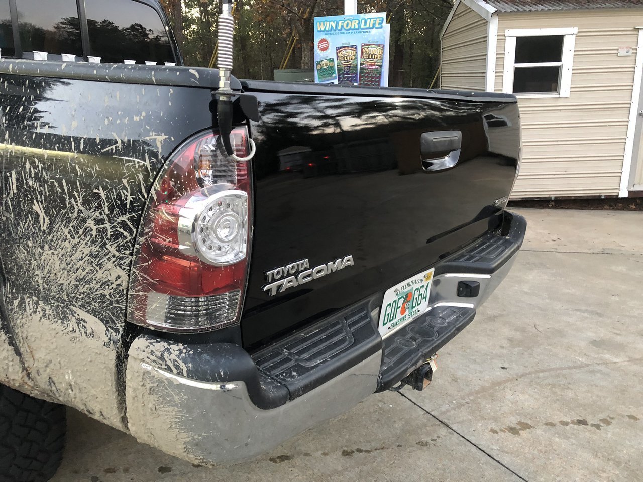

    This is how I did mine.
    And
    Ran it thru the grommet under driver seat and zip tied along frame
    gunn_runner[OP] likes this.

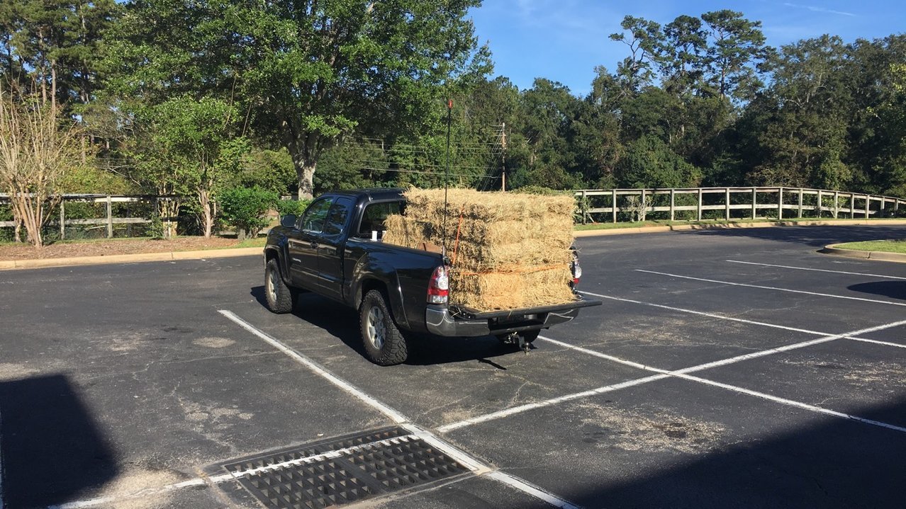

    I routed mine into the taillight, over wheel well along the frame and up into the cab through the grommet under the driver seat. Easy as pie.
    Best place to mount the antenna IMO because I can haul loads like this without it getting in the way whatsoever

    Here’s a funny picture when I had my temporary tailgate.
    This was 80 MPH on i-10 westbound out of Tallahassee. Antenna holding strong
