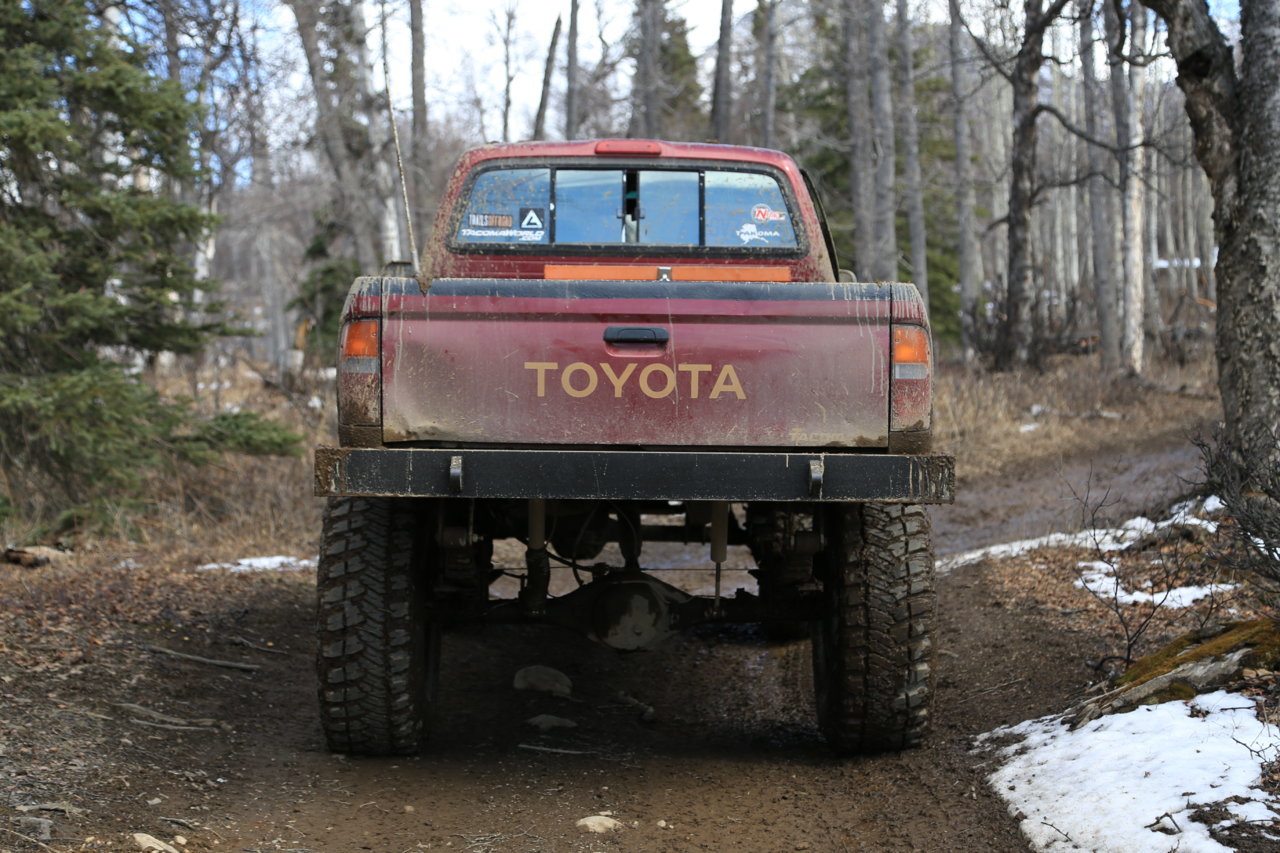

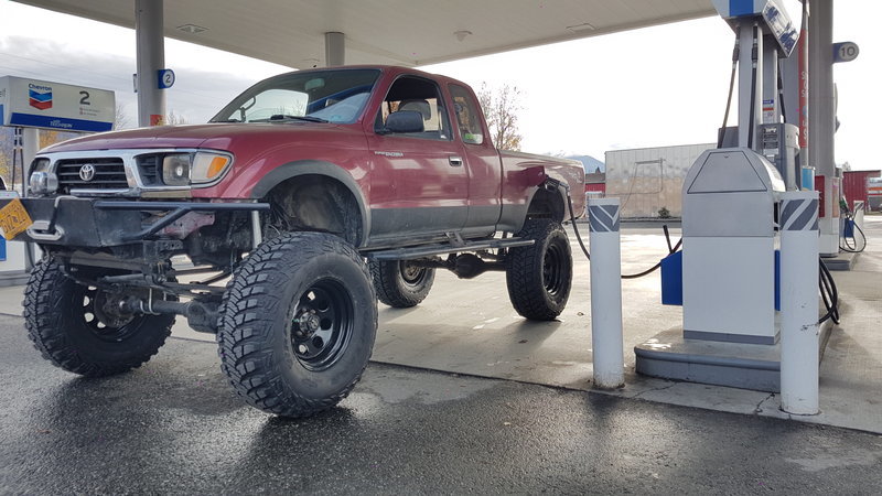

    Thanks for looking at my build! I bought Roxanne with 160,000 miles and BFG All Terrain TA KO 31's. I previously owned a 1999 Jetta 2.0 Wolfsburg Edition that was totaled. I bought Roxanne to get me through school, have my first truck, and something to wheel. I cruised craigslist for a couple days and picked her up a day or so later. So much has changed...
    Obligatory stock flexing pic. 24 mpg on this trip :rofl:
    Currently solid axle swapped and sitting on 37" MTRs. :cool:
    https://www.youtube.com/watch?v=3gpDN4xXsFg&feature=youtu.be
    • Solid Axle Swap with Trail Gear kit C, 3" Springs <-- to be swapped out for OME CS010R springs
    • Rock Assault Axle, 30 spline chromoly axles and hub gears, Longfield birfields, HP front diff
    • Chevy 63" Springs in the rear with some helper springs for height from my old leaf packs
    • ARB Air Lockers Front and Rear
    • Nitro 5.29's in both diffs
    • 37x12.5 R17 Goodyear MTR with Kevlar
    • ProComp Classic Rock Crawler Wheels, 17x9
    • 9500lb XRC Comp Smittybilt winch with synthetic line
    • Ruffstuff Chevy 63" Spring Swap kit
    • Custom front bumper
    • Custom rear bumper
    Current To Do List
    • Take out Chevy overload in rear leaf pack
    • Clearance bedside by cutting out fender
    • Front driveshaft work
    • move the front axle forward by swapping leaf packs acks
    • Clearance around front by tubbing (if still needed after swapping front leaf packs)
    • Rear Bumpstops
    • Install Ruffstuff trac-bar
    • Install Blue Seas fuse block and 100A circuit breaker, then rewire a ton of stuff.
    • reinforce front bumper to the frame
    • front stinger?

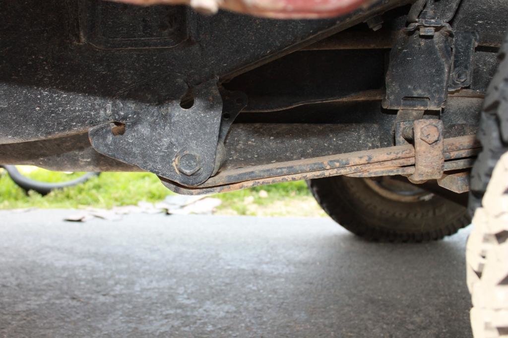

    • weld rear spring mounts to the axle to fix pinion angle (ruffstuff perches)
    • driveline spacer or extend it once rotated rear axle (if needed)

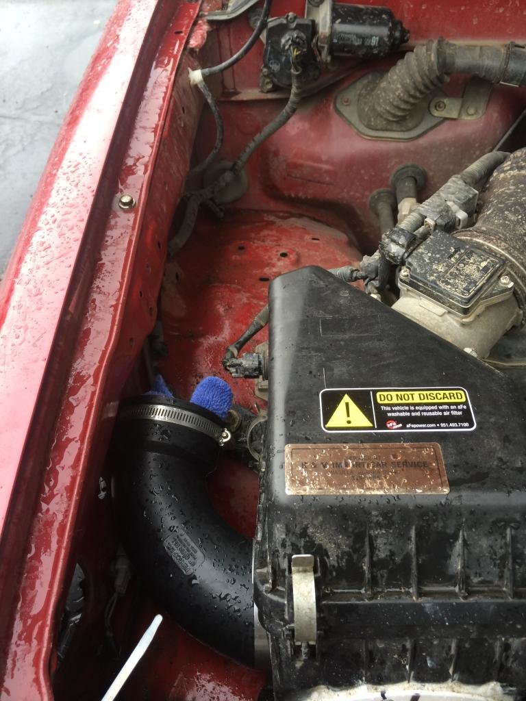

    AFE Pro Dry S or a generic fabric filter...

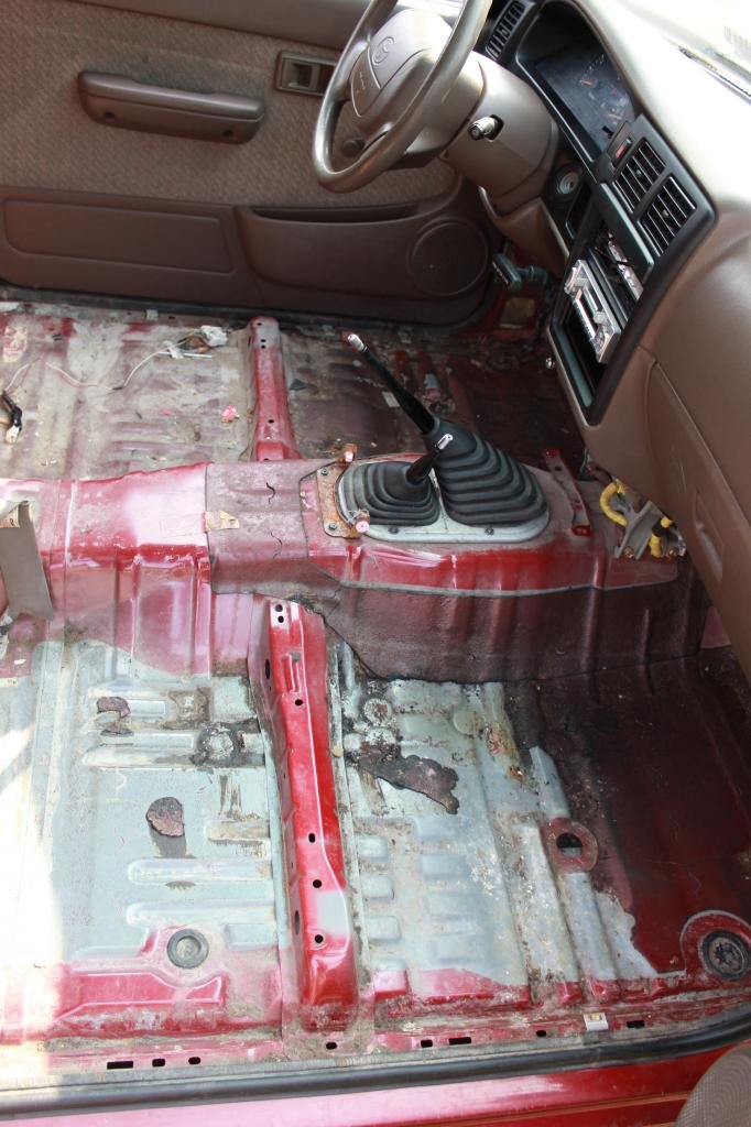

    Removed all floor carpet-LOUD regret doing this honestly

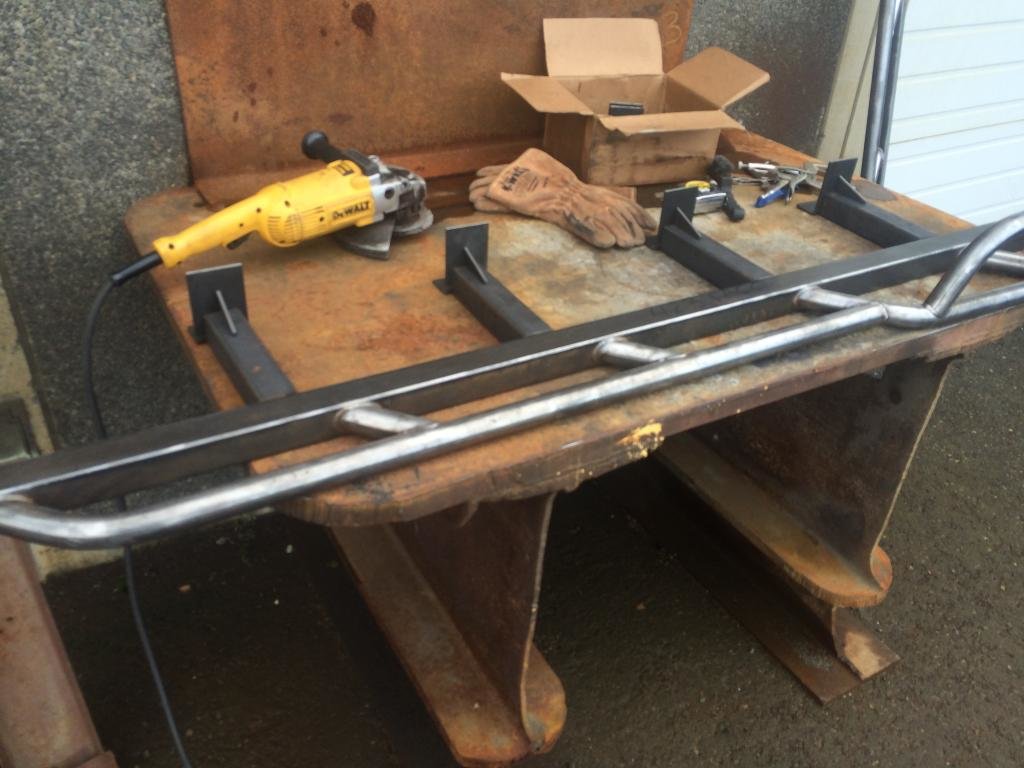

    Brute Force Fab Kick-out sliders
    Snowrox Fab Bumper
    Snowrox Fab Hi-Lift Mount

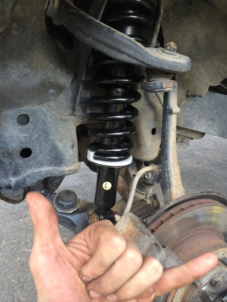

    Replaced stock front struts/coils

    AFE Pro Dry S installed 9/6/14

    First week, deep clean and carpet removal.

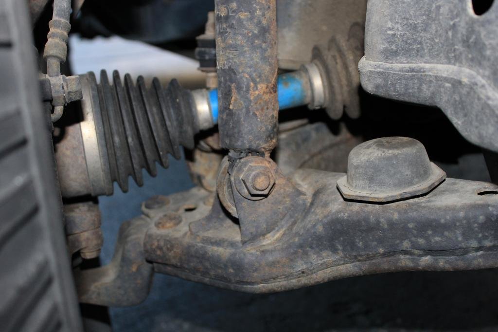

    Saw that I REALLY need new front shock bushings *Replaced!
    Installed these, nothing amazing. Napa had them in stock...

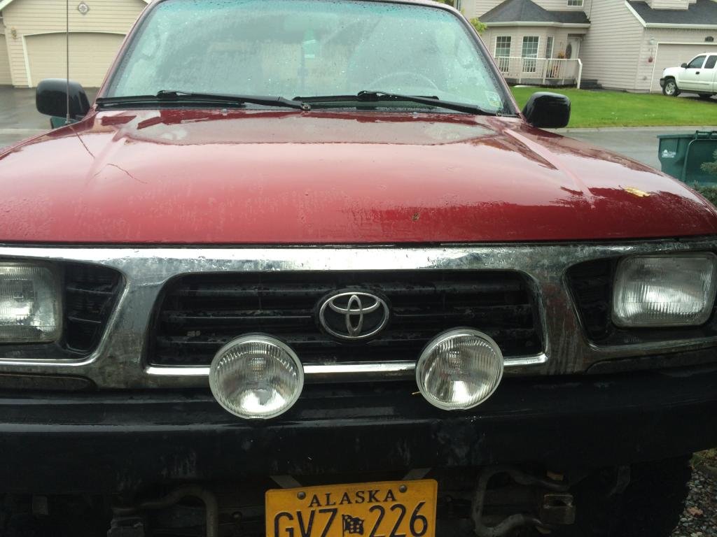

    Bolted up my driving/offroad lights (Bling lights 200-C), now just need to test them at night and review them!
    And started my kinda snorkel project (Just going to extend this, not going to cab.)
    Also, cleaned up some Brute Force Fab siders I bought from 423 Taco. Hopefully I can weld them on next Sat. at my University.

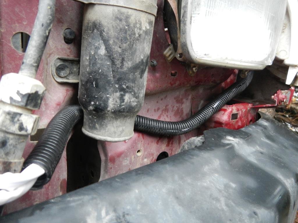

    Yesterday I wired up the 6" Offroad lights, work good! I ran the wires right behind the AC Dryer/Reciever and thru the fender well area.
    Maybe next week I can get the Dually's and sliders on! And LBJs...

    I had the 882's (medium lift/medium duty) and it net me about 1.75" of lift up front, which was perfect. Although, my truck was a V6, so it was a little heavier up front than your truck, so you may net a little closer to 2", but my guess would be 1.8-1.9" of lift. I would think 881's will get you about 1"-1.25". 882's are the way to go, unless you're mounting a SUPER heavy front bumper. Just make sure you drop the front diff, because you'l still blow out CV's with 1.5" of lift.
    Now, as far as flex, you're still going to be limited to your stock control arms, and ball joints.. but it will flex more than stock, that's for sure.
    On the note of ball joints, I would just presentably replace them. 1st gen Tacomas, after about 100K miles, the ball joints start to weakin heavily. Which could lead to them just popping out of the socket. Easy fix, just make sure you get it aligned afterwards. I'd probably do it at the same time as the rest of the suspension is being done, that way it'll save you the cost of only getting it aligned once.
    That kit you've got listed is a nice one! That's a decent price, too.

    Yeah, diff drop would be done at the same time. I have the OEM LBJs in my room, ready to go on. Shouldn't need an alignment for those though. UBJs are on hold at my dealer, I need to get my LBJs on first!
    somewhere around 2" lift would be alright for the front after the winch is on. Sounds like it would if that is what you got with the v6 w/o winch :notsure:

    Front bumper ideas?
    Not sure about the corner measurements, those were guesses.

    I like it. Gives some protection, but still "minimalist" looking.

    Thanks! Yeah, it needs a lot of adjustment before it is ready for fabrication... Just threw down some ideas. I want to keep it minimalist to keep approach angles up and weight down while having the winch.

    Yesterday I threw a bolt on the exhaust manifold where one was missing. Quieter now, probably still have an exhaust leak somewhere, but not as bad now.
    Pics from the other day.

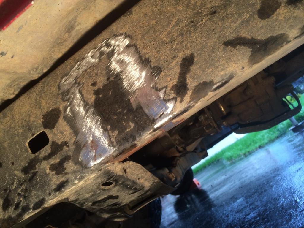

    Got one side of the sliders welded on but I dont like the kickup, so those will be cut off soon enough. Then I need to paint them and do my ball joints this weekend.
    And I bought some coilovers for the front. :D Was planning on waiting but something presented itself!
