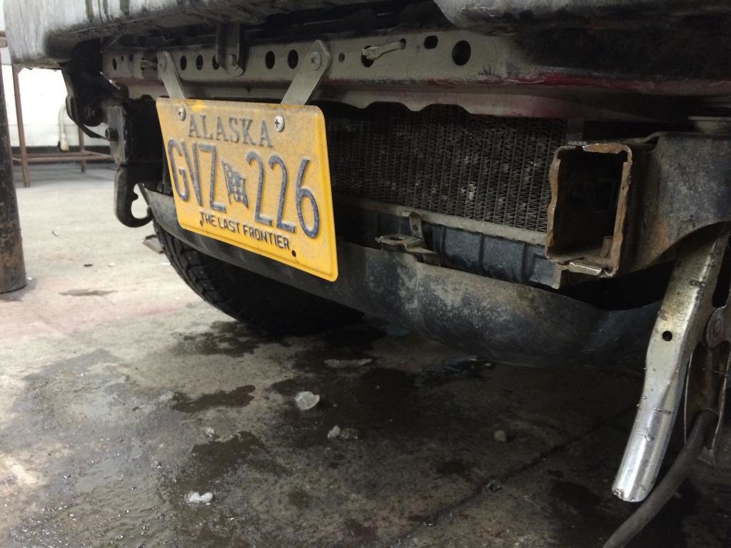

    Here's the start of it.

    Is that where the winch will sit?

    Yep, that is the bottom side of the winch plate and cross member (including my two main recovery points).
    After I shower I'll update with more pics.

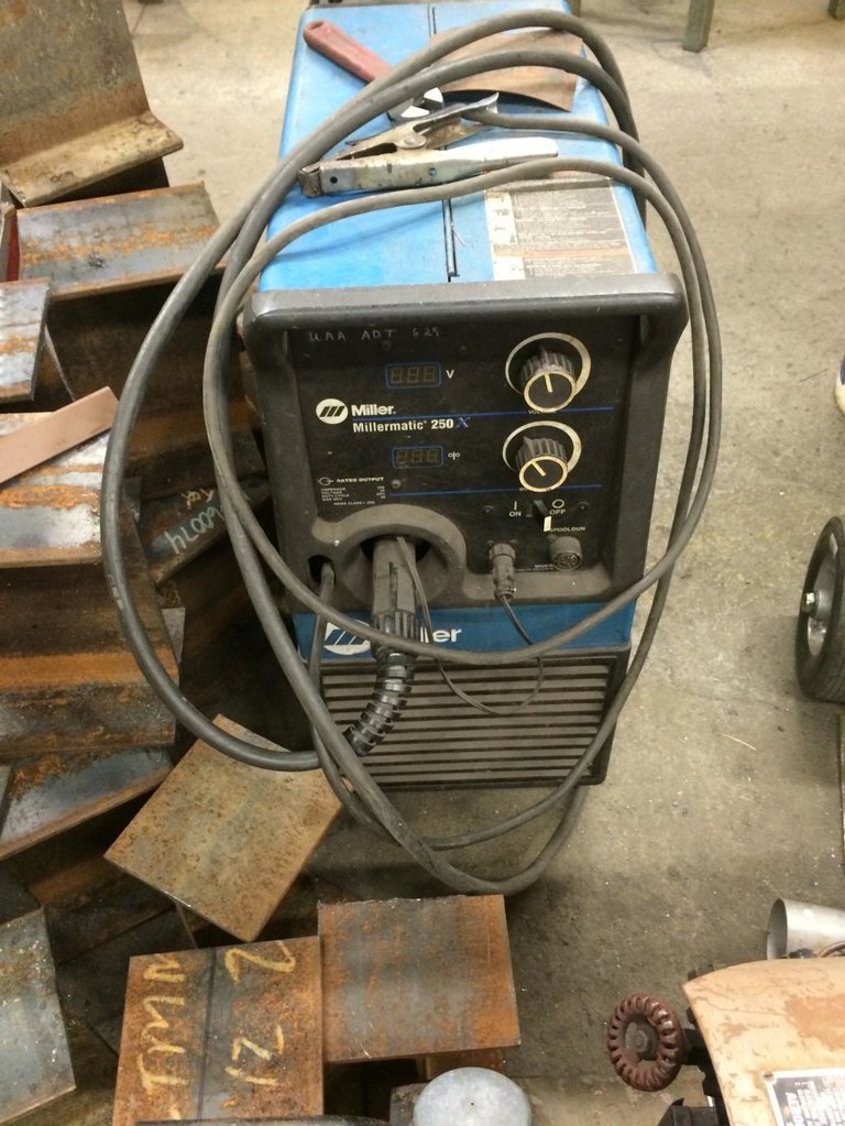

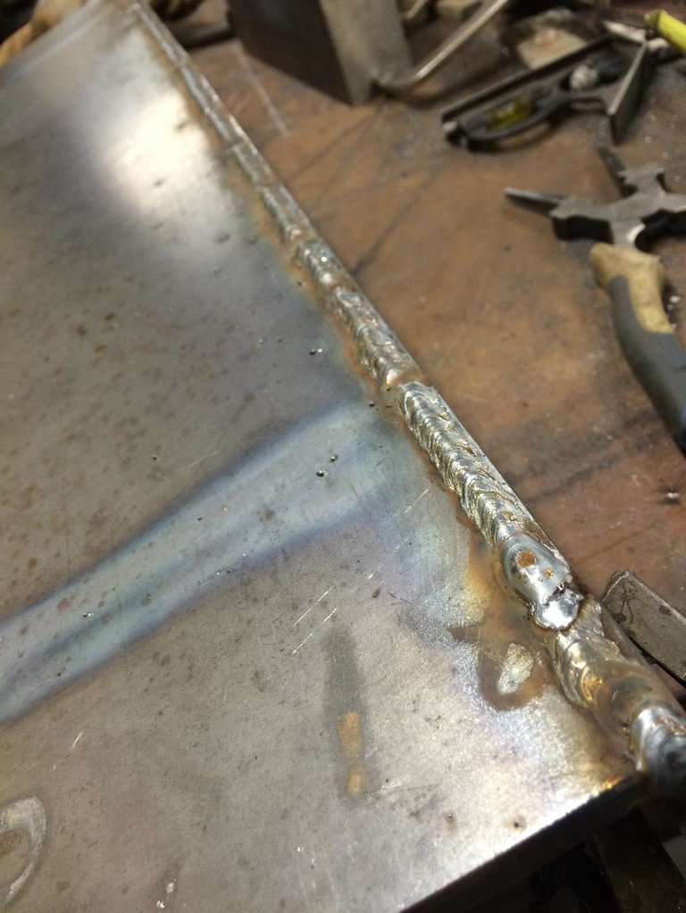

    Frame end caps, right side on, about to weld on the left side. I used 1/4" plate with a grade 8 nut of the same size/thread pitch as factory welded on all six sides. It ain't going nowhere. :cool:
    Layin' down some beads. (This is the the top of the winch plate, and top edge of the crossmember.)
    Almost done with the basic winch plate here.
    And the awesome welder I have been using so far on this project and my hi-ift mounts.
