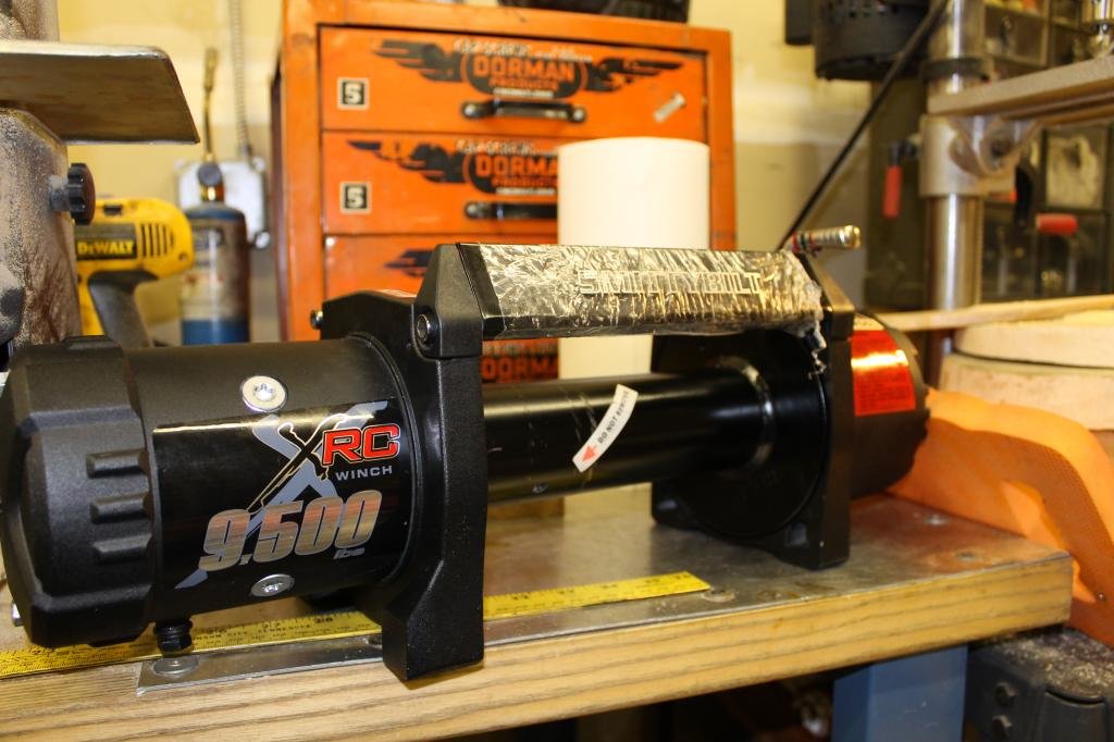

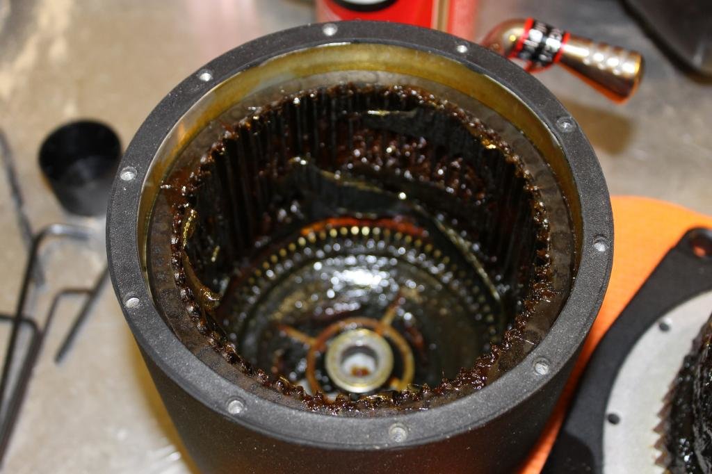

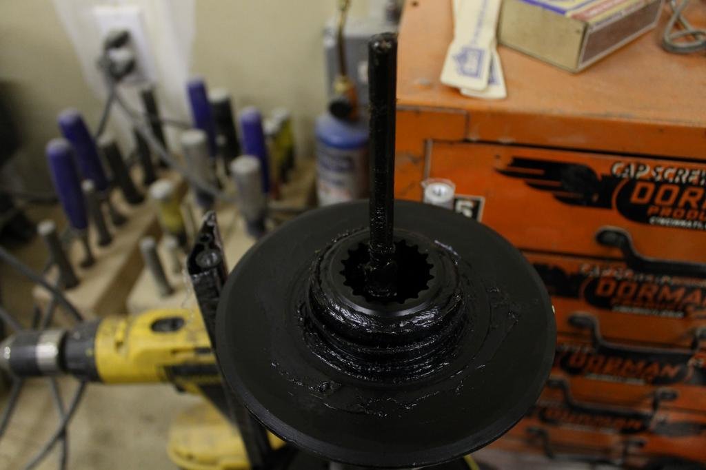

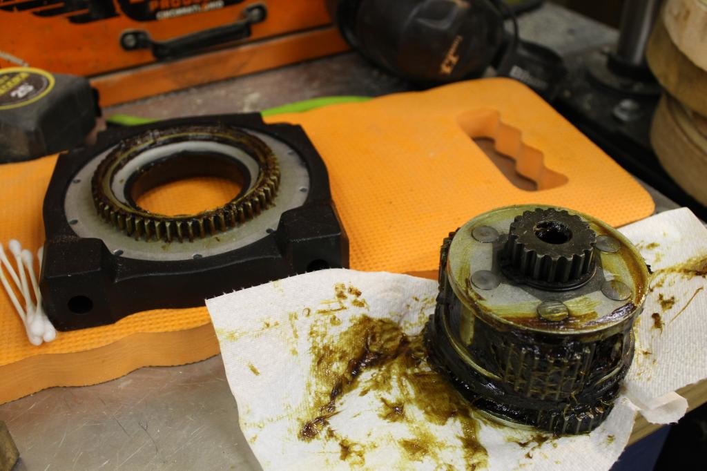

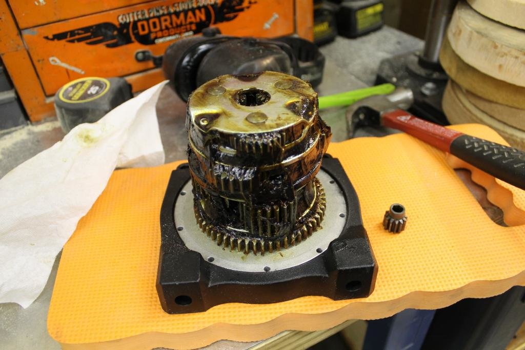

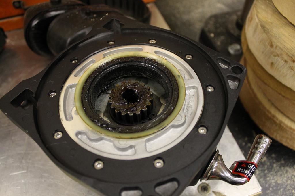

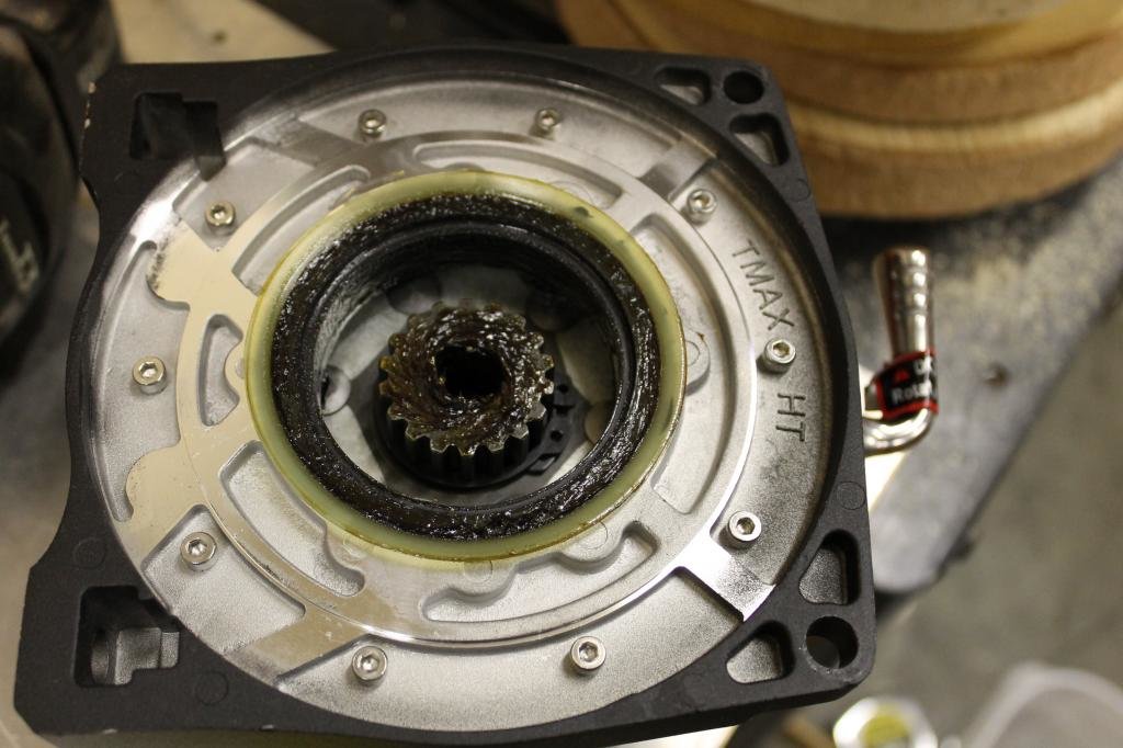

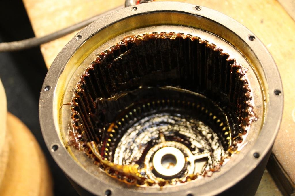

    Well I just redid the grease in mine.
    To take apart the gears, you must undo the winch by the two support pieces tying everything together. Once you remove the two allen screws and lift off the gear end, it will look like this.
    The part you just took off looks like this.
    Remove the black plastic ring and here is what you have. (A Tmax winch! :laugh:)
    After I unscrewed the 10 allen screws the cover was still sticking to the body, so I gave it a couple gentle taps and it came off.

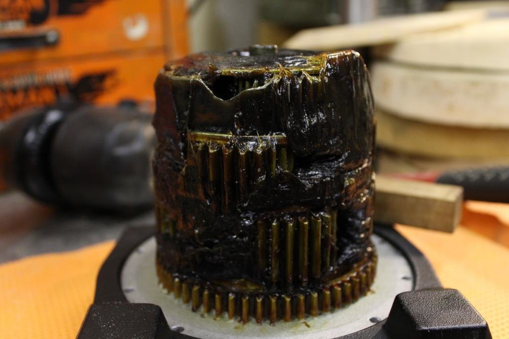

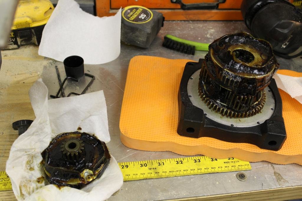

    Now the goey grease pictures!
    Time to clean up the gears...
    Then repack with good grease.

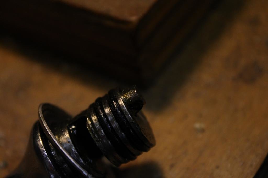

    I also modified my gear selection switch because it was over engaging my gear set. This may not be necessary for you
    I took a grinder to the edge of the selection switch's small cylinder that actually moves the gears. Remember that a little goes a long ways here.
    Enjoy your winch!

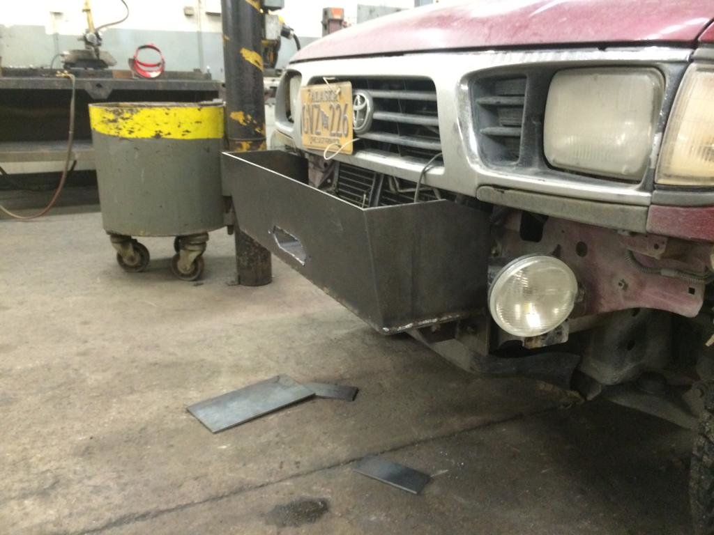

    Bumper update.

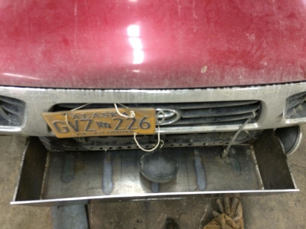

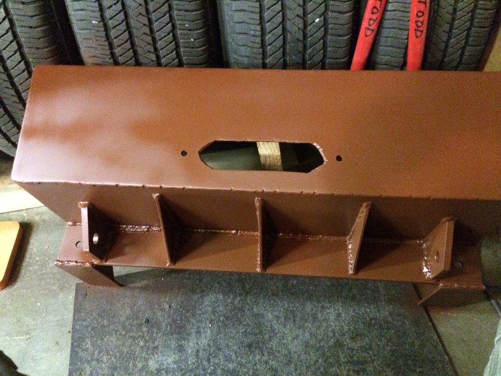

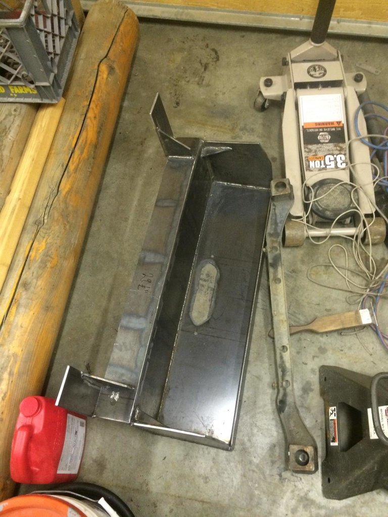

    More updates, all done except for a few more holes and the tubing work I'll have done.
    And the first coat of primer.

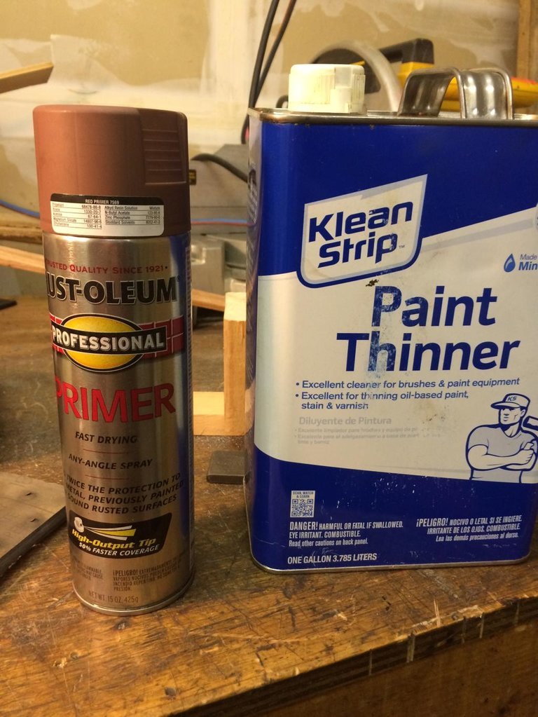

    I first rub it all down with some paint thinner then use this Rustoleum.

    How thick of plate did you use for it?
  17. Dec 14, 2014 at 1:03 PM
    #257
    Delta00
    Delta00 ᕕ( ᐛ )ᕗ
    Sep 16, 2013
    #112633
    4,137
    Troy
    Chandler AZ
    2002 Toyota Tacoma 4WD
    Check Build
    I'll throw out a guess of.... 3/16?

    The specs for the winch called for a certain thickness in mm that was in between 3/16" and 1/4" so I used both haha. The winch plate, cross member, and sides are all 1/4", the front and top (light bar mount really) is 3/16"
    If I were to do it again I would change the sides to 3/16" for weight reduction... But I am pleased with it how it is, especially considering I will have the tubing attached to the sides.
