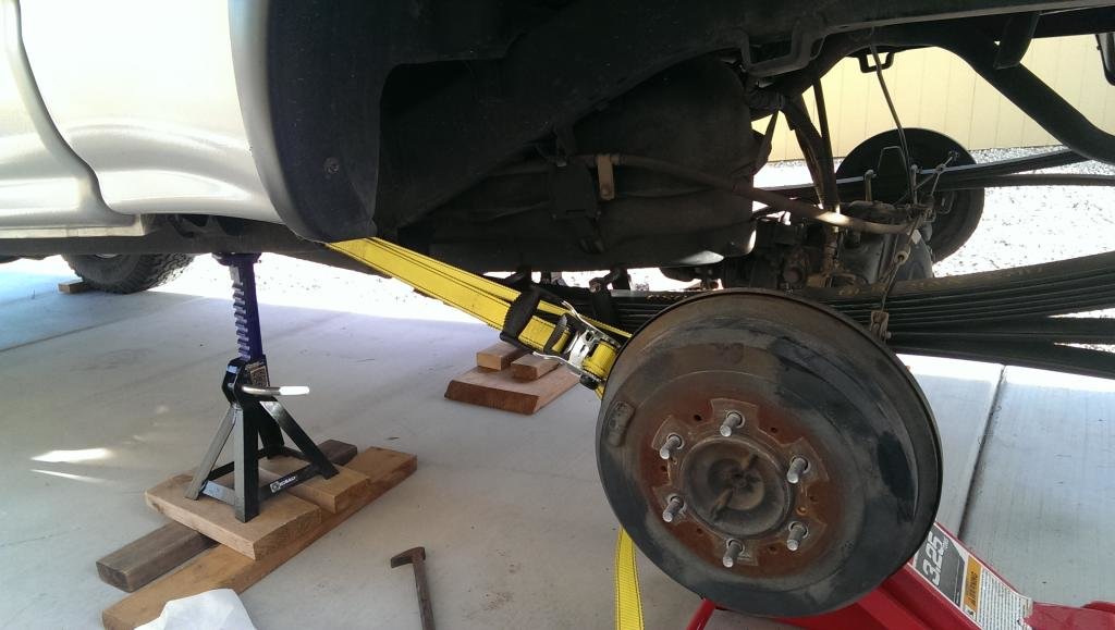

    For a full leaf pack I would recommend that you drop the whole axle instead of doing one at a time. This is why its a good idea do do the brake line first.
    I did one at a time and had to use ratchet straps to move the axle forward to line it up with the center pins.

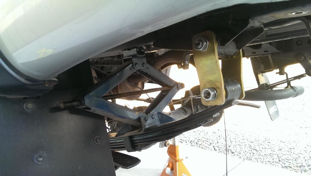

    Also, for me to get the rear leaf dpring shackle bolt in I had to use a scissor jack. Ive heard of people using a bottle jack also. This made the job reallly easy.

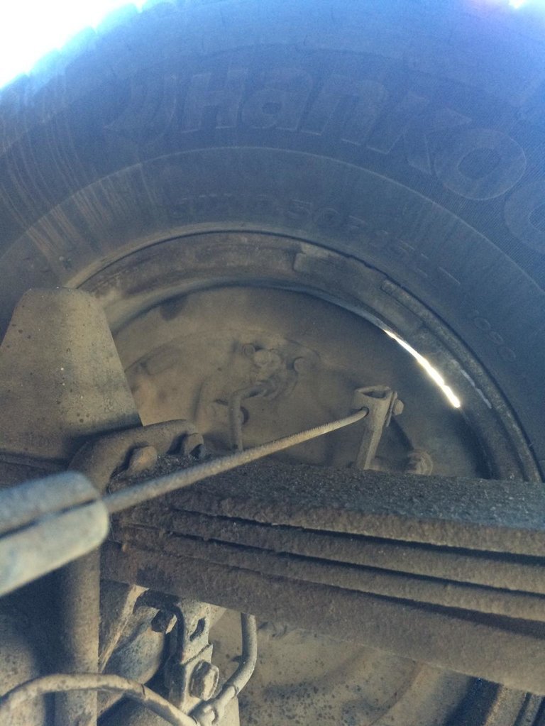

    hey bro its been a while since I've been on here and must have missed your post in my build thread! sorry.
    Yea the 5125 10" in stock location are the way to go w/ OME leafs. unfortunately i don't have a pic of the angle of the driveline and my truck is over an hour away (shocks are off and being sent to toytec) You don't for sure need the axle shims and bearing drop, but its really nice to have them on hand incase you do. IMO its more likely you'll need the axle shims though and the bearing drop is more of a fine tuning thing. I can't really remember how i figured out the driveshaft angle i think it was something like each inch you raise equals one degree of shim. so for the OMEs it was a 3degree shim.
    also is your ebrake line over or under the leaf packs? if it runs on top of the leafs ill post a picture of these little extenders you will need/want to make.
    edit: you can also use some washers for the carrier bearing drop I'm pretty sure all i needed was like 5/8" drop on the bearing.

    Looks like I'll need to make an adjustment here... The e-brake cable does go over the leafs. What did you end up using?
    I am also thinking about taking the bottom short overload type leaf out.

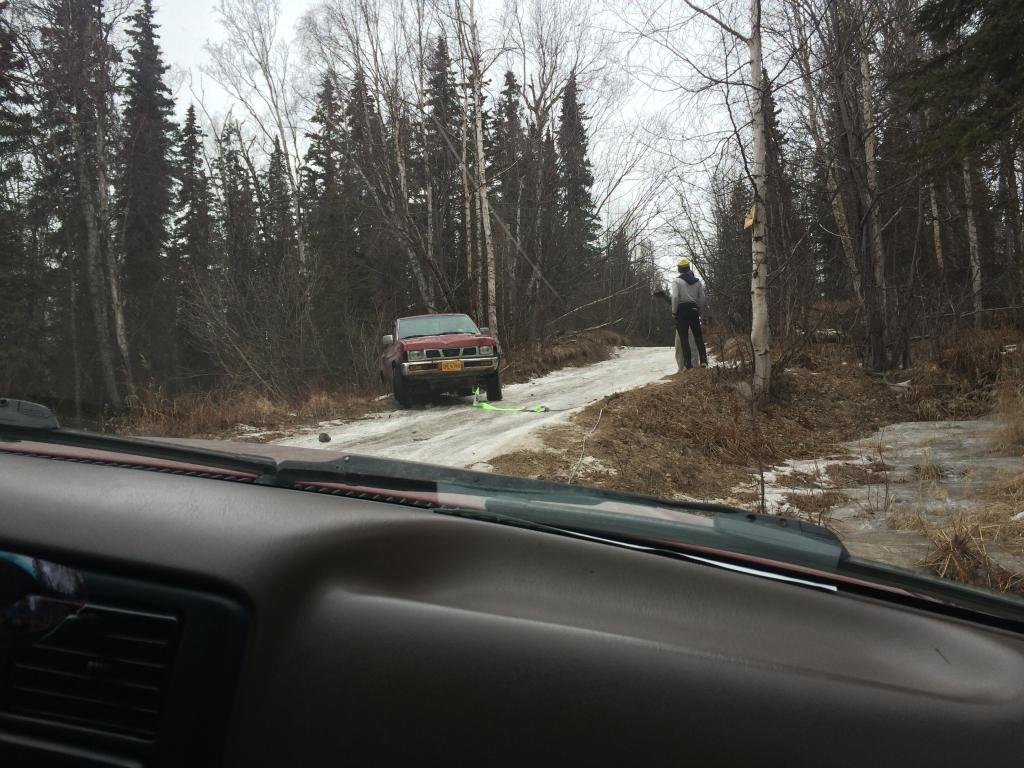

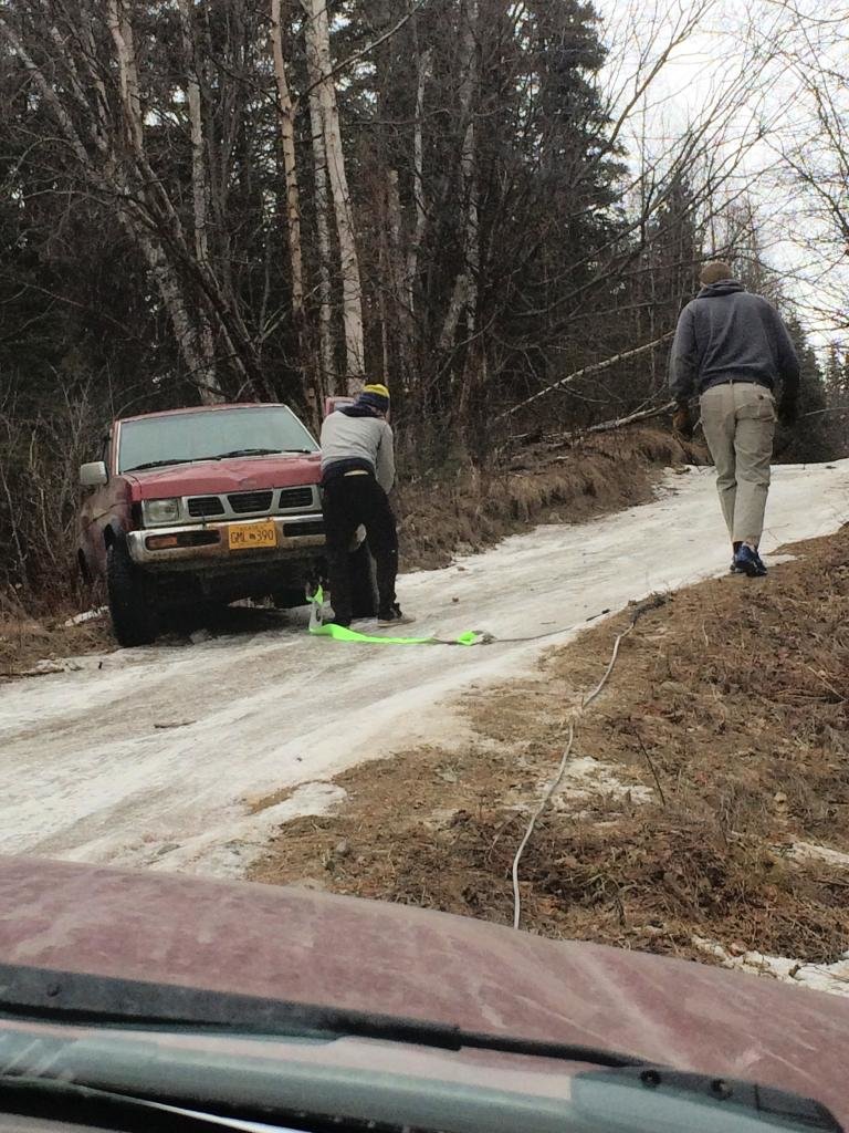

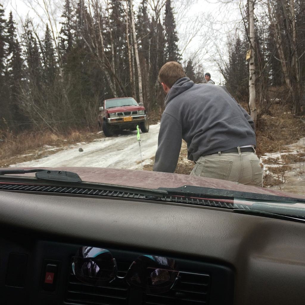

    Did my first vehicle recovery yesterday!
    This Nissan had been sliding down the icy hill. He tried to turn it around and started sliding mid turn, his passenger rear wheel was in the air and the truck was stuck on his leaf spring and stock gas tank skid. The hill was VERY slick and I started to slide down it while walking it a couple times.

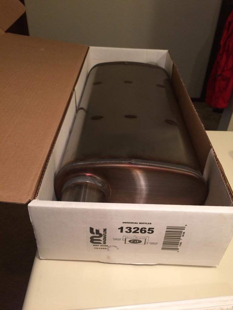

    My muffler came in a day early. Planning to get it all installed Friday.

    It looks like a lot higher quality than the flowmasters I've seen. I bet it'd sound better on your V6 though! :thumbsup:
