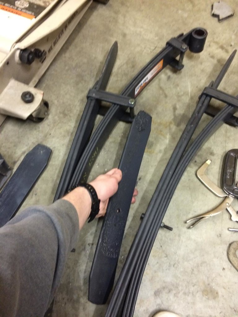

    So to lessen my lift a little I took off the bottom leaf from my OME pack, I don't think it will have adverse effects unless I really overload the rear end.

    Good idea.. When I did mine it literally got lifted like 4 1/2" lol. Eventually when you break in the springs a little you might end up wanting to put it back.

    Exactly my thinking. Yeah I'm going to keep it around. Might keep my stock overload leaf pair too, just for options later on.

    yea that's a good idea too. I was thinking of doing the same but after a few months I realized that they are still pushing the rear end up a bit higher than the front even fully loaded lol.. Ended up giving my old leafs to the scrap metal guy.

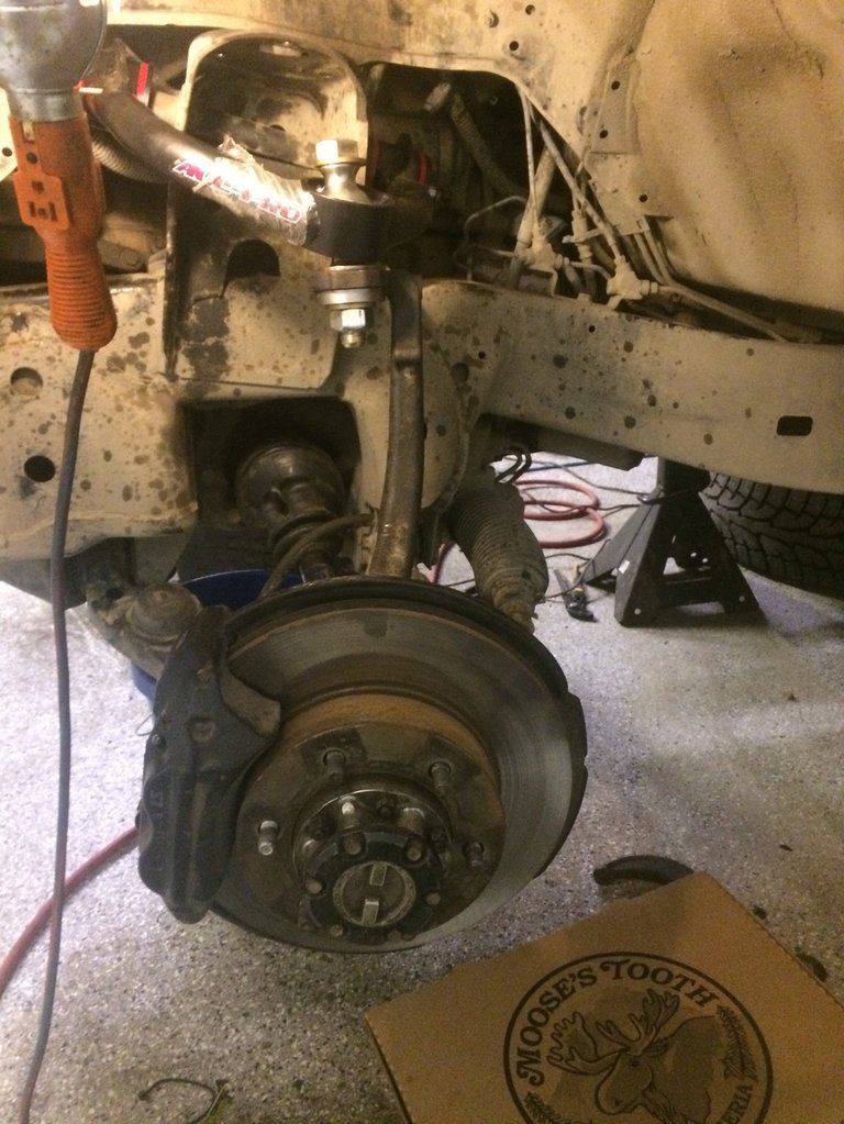

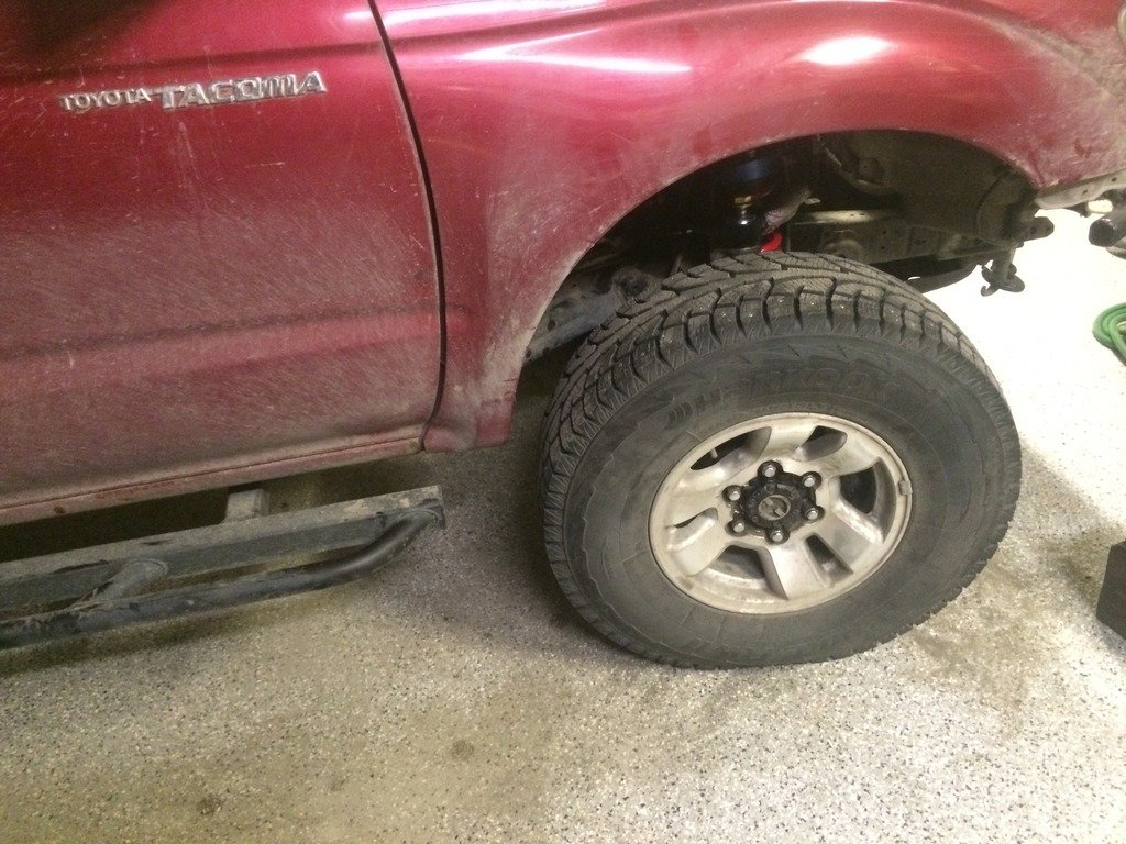

  12. Mar 11, 2015 at 12:46 AM
    #372
    SnowroxKT
    SnowroxKT [OP] Well-Known Member
    Dec 11, 2011
    #68604
    5,321
    Kyle
    Anchorage Alaska
    2008 TRD OR
    Got a crap ton done today and yesterday! New CVs, New All-pro uniball UCAs are in and my Fox Coilovers with my Eibach could are in, took some persuading, but they're in! She is sitting pretty high and my alignment is horrible!!!
    Some pics for now until I get better ones.
    Tomorrow I start on the rear.

    Looks good bro, now we need a full truck picture! Did you adjust your fox coil overs or did you leave them how they came?
  14. Mar 11, 2015 at 9:17 AM
    #374
    SnowroxKT
    Dec 11, 2011
    #68604
    5,321
    Kyle
    Anchorage Alaska
    2008 TRD OR
    Eric (from Relentless Fab) sent them to me at 2" and 2.25" threads showing, I changed it, then changed it back lol. These are the Eibach 650# coils too, hope she settles a little, my fiancé likes Roxanne more now because the sliders are at an appropriate step height instead of just being in the way.
    I brought the nice DSLR and forgot last night :anonymous: after today or tomorrow before the alignment I'm hoping to get a good set of pics.
  15. Mar 11, 2015 at 9:39 AM
    #375
    presto
    presto Well-Known Member
    May 9, 2011
    #56375
    2,243
    Topher
    san francisco
    2000 T4R 4x4
    Fully armored on 33’s
    Ah I think I have the same springs as you haha.. Just be careful that you don't set them too high if you do end up adjusting them (Not saying you did in the first place..) I had adjusted my toytec boss coil overs too high and ended up ruining my steering rack, it still works but it will go out within a few months - a year probably.. Also made the ride really harsh. I probably will never touch the adjustments on my coil overs again.
