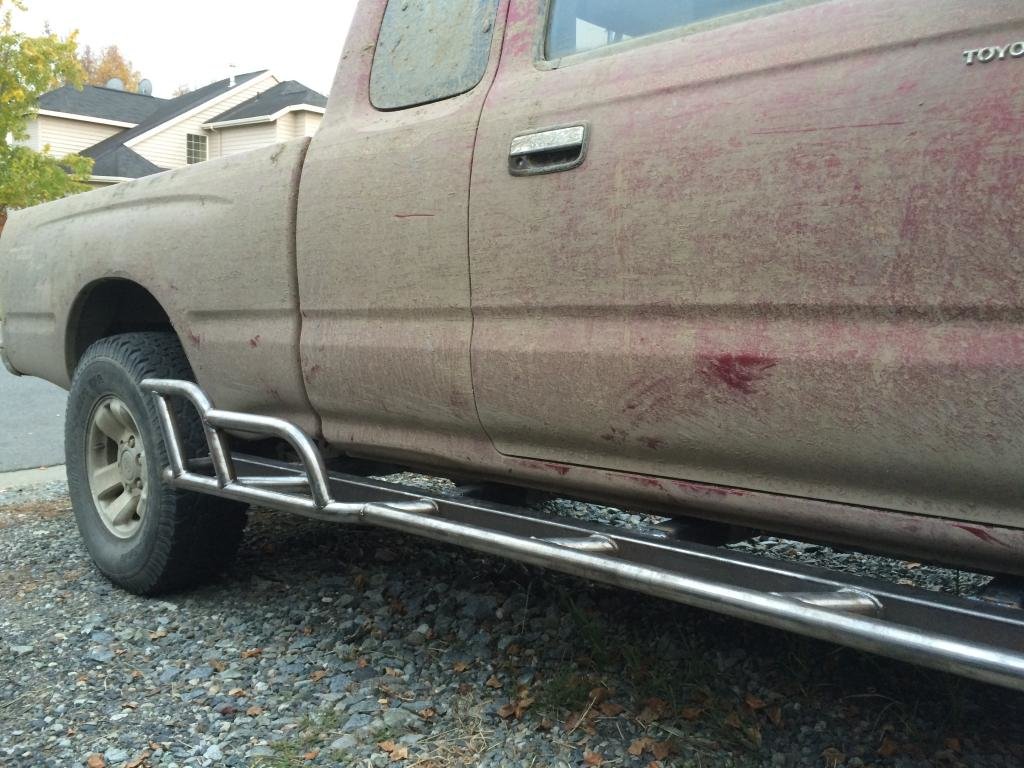

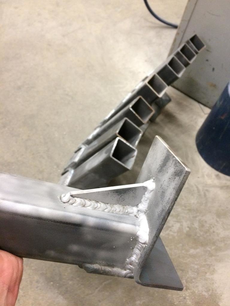

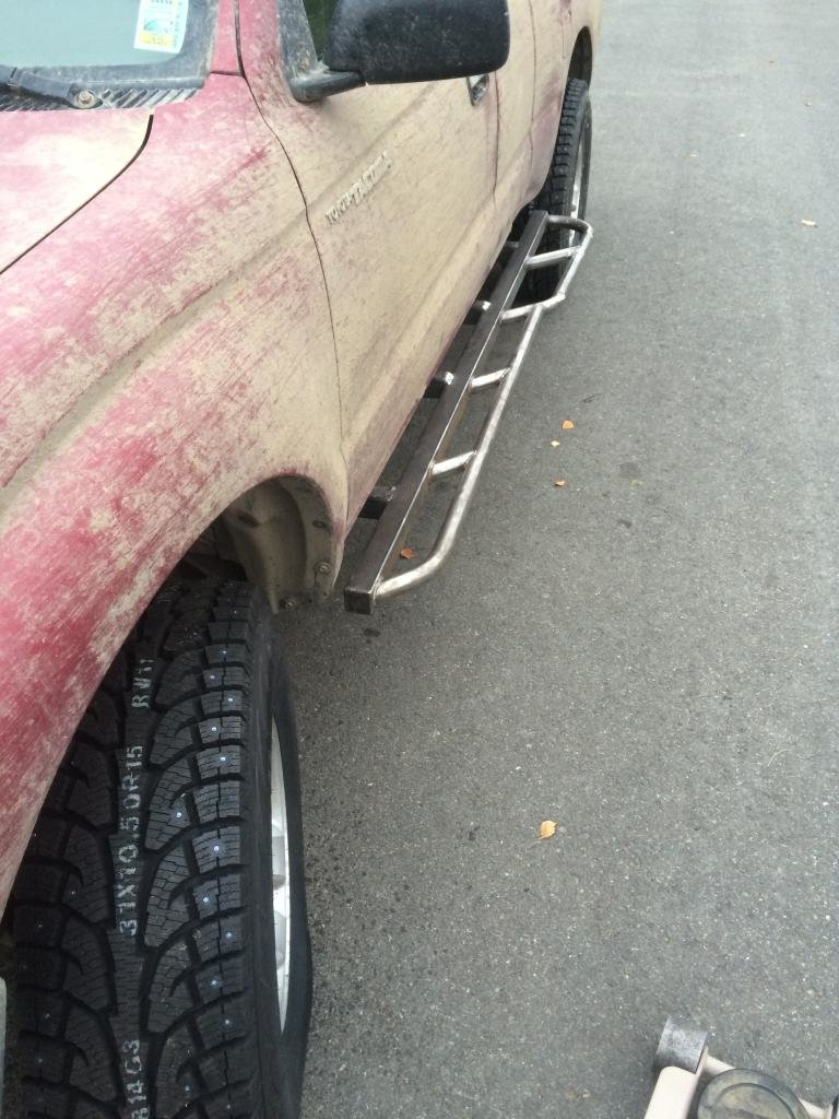

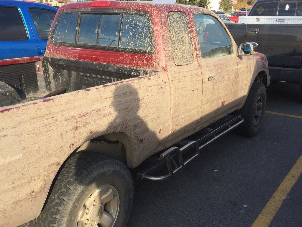

    Here are a couple pics of the sliders during fab/install
    I dont really like the kick-ups, so I am planning on cutting those off Saturday, as well as welding the other side on haha.

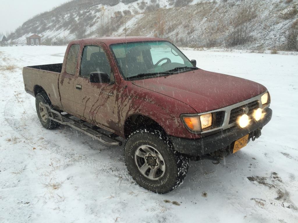

    Update!
    New OEM LBJs installed. Looks like I will need a new outer tie rod soon, passenger side. Maybe I will do that when I get the coilovers on... :D
    From yesterday, first snow run to the mountains!

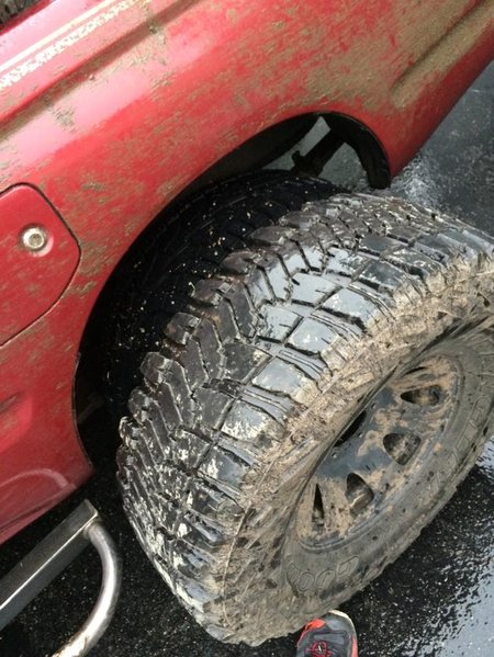

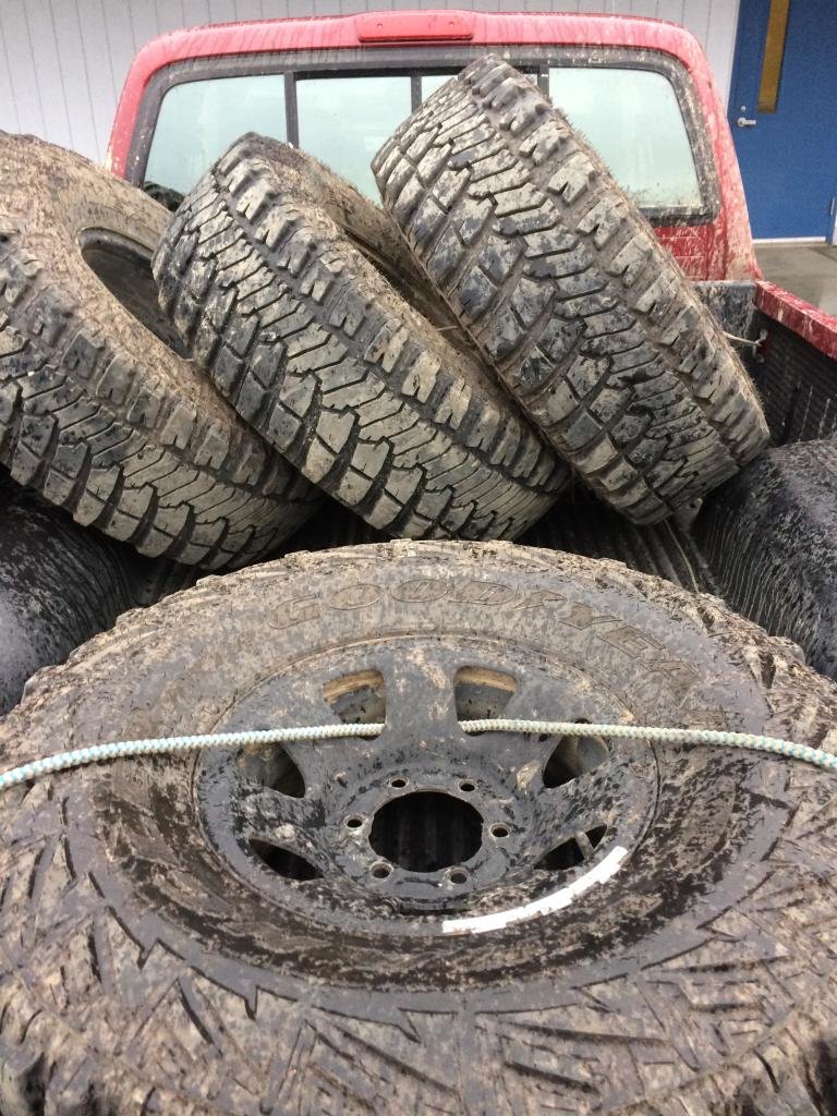

    Hmm.. Wonder what happened to my pictures... Anyways, got these!
