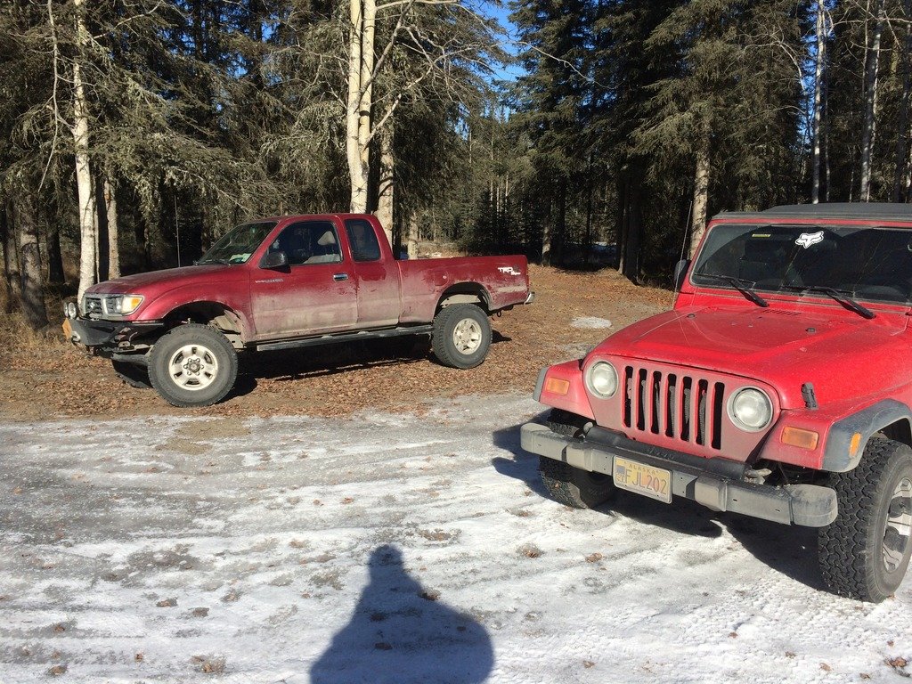

    Here's a quick pic of her down at the cabin with a friends TJ

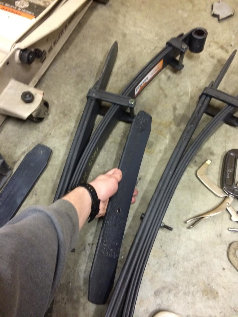

    Have some major updates!
    New exhaust installed, new exhaust manifold (wanted the tubular, but unfortunately I had to go with another cast one...) and new everything after the cat, 2.25" pipe and a Magnaflow 18" muffler.

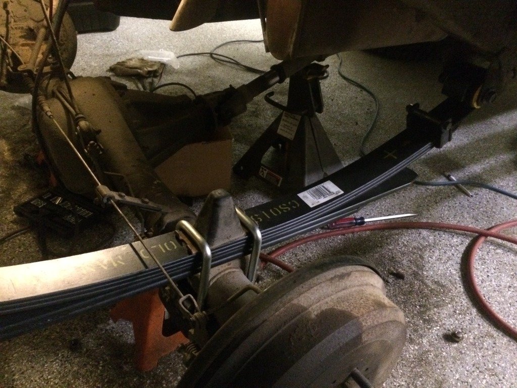

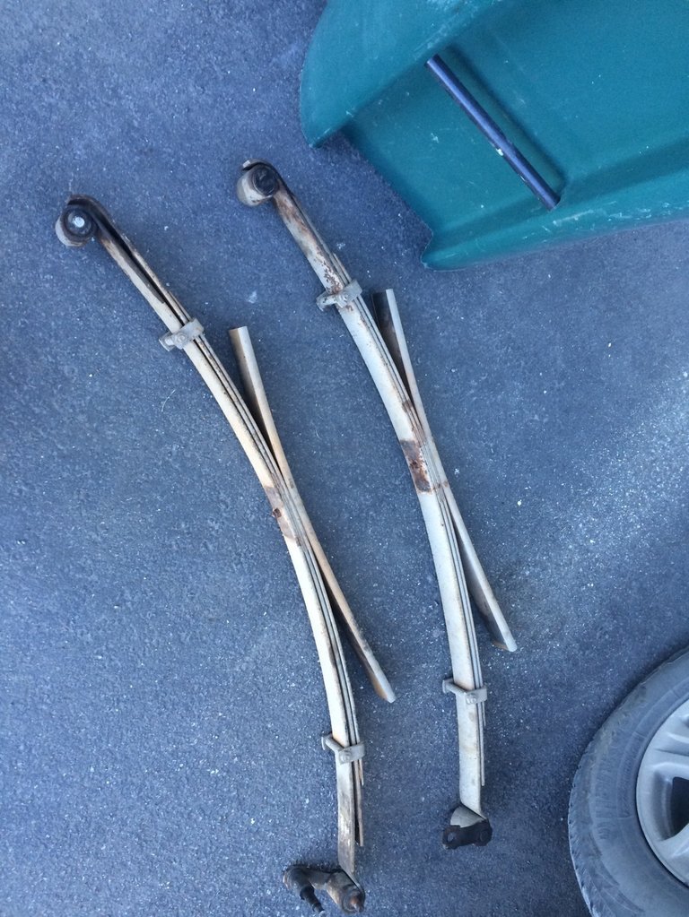

    Also, I installed my lift over spring break, took my 4 pretty laid back days of working in my in-laws (As of June '15) garage. Went pretty well except for the front bushing sleeves of my leaf spring bolts were seized so I had to cut the bolts out. By some odd miracle Kendall actually had the bolts and hardware when GTF hadn't received their shipment, so that saved the day. Then put it all together. This was by far the biggest vehicle job I have ever done. And to think a few years ago I was learning how to change the oil on a Jetta. :rolleyes:
    Anyways, I just have some lame iPhone pics for now.
    I took off the bottom overload type leaf of the OME leaf pack. These are meant for the 89-94 Toyota Pickups which have a lot more arc to the leaves, providing close to 5" lift rather than my goaled 3", so I just took this bottom leaf out. There is still plenty of lift and I doubt any adverse effects will come of it.
    Compared to the old leaves

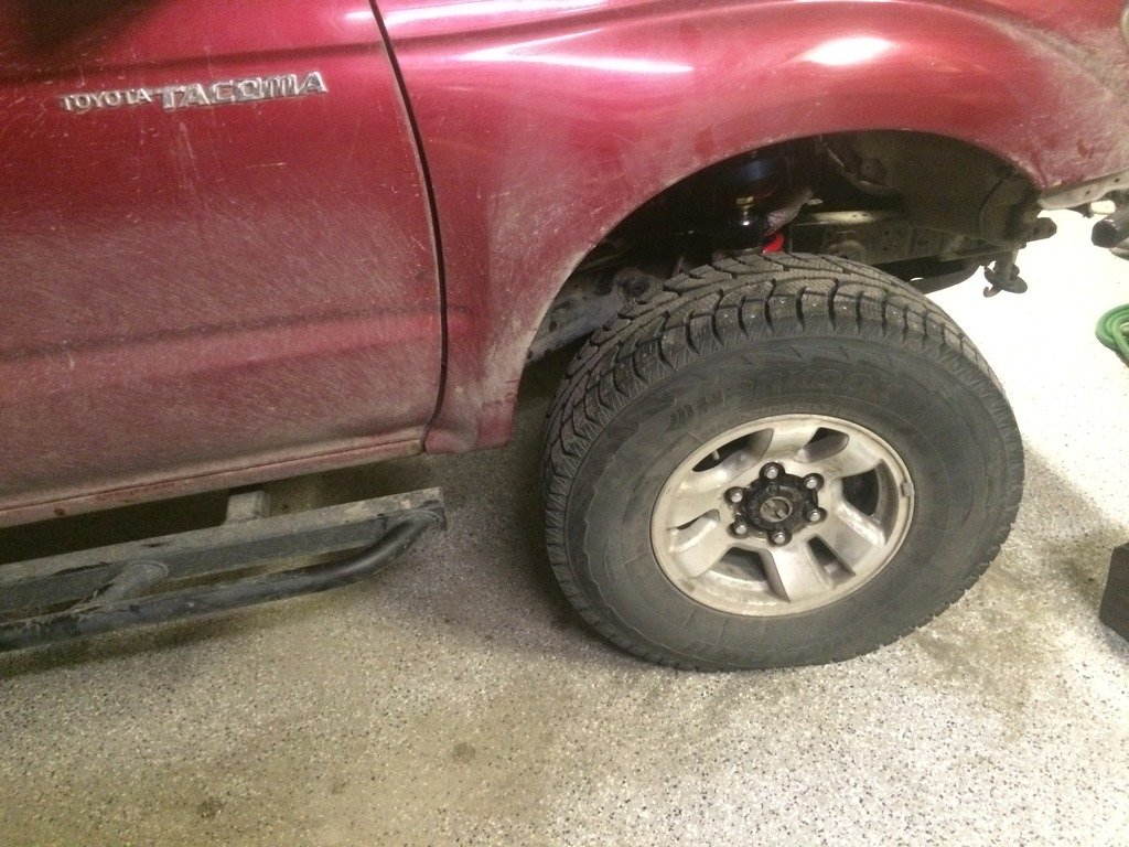

    Installed here. My ARB shocks are a full 2" short on the fully extended droop, so I will have to be in touch with Tom at GTF about that.

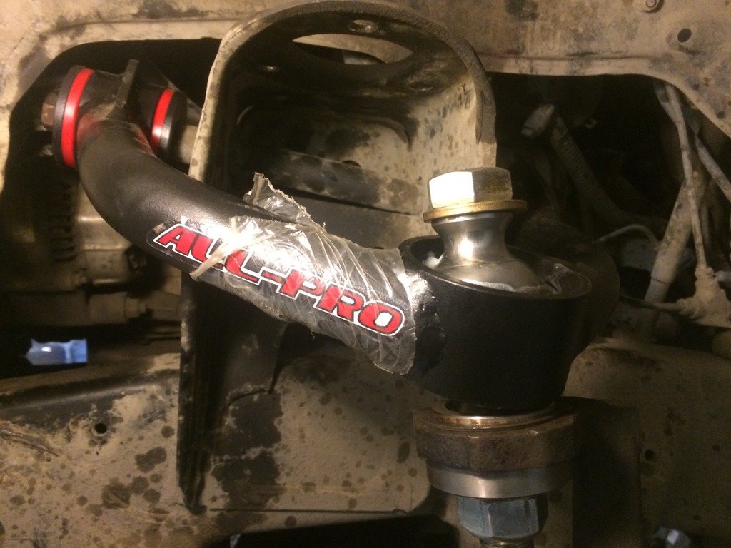

    Here are my All-Pro Uniball UCA's installed.
    Front end put back together, before alignment. Also installed new Napa CV's.
    And here it is on her fist maiden voyage post lift.

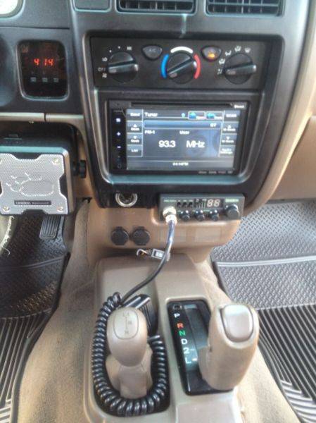

    And I need recommendations for a CB radio. Entire set-up actually as I have no experience with CB. I want it to fit in the ash-tray location, so a smaller one.

    Same cb I just got too ^

    Just the muffler and turn down were 99 bucks. It might melt the ABS line on the newer trucks, but I love it. Totally out of the way of the suspension and :eek: rocks.
    That looks good for the CB, what else will I need?
    CB Radio, I like that Uniden PRO520XL 40 channel
    -Antenna 3' Firestik This?
    -Coax cable
    18 feet
    9 feet
    -Mounting spring necessary? Thinking of mounting it in the bed either right by the cab or near the tailgate.

    I would get a spring, you will also need the coupling to attach the antenna to the coax cable, and a mount for the antenna.You will also need a switch for the radio itself, I got a cb radio switch from OTRAWTT just now actually. I also got a quick disconnect for my antenna do no punk kids can steal it haha but that's optional.
    Ps I read somewhere that mounting by the tailgate = not as good of reception, also bad grounding = bad reception.
    I got the cbi hood mount and really like it, if I didn't want the hood mount Id probably go directly behind the cab. Although it might be hard to mount it nice and sturdy in that spot.

    Like this?
    http://smile.amazon.com/gp/product/B0002HRBSU/ref=ox_sc_act_title_1?ie=UTF8&psc=1&smid=ATVPDKIKX0DER
    And then I need a switch for the radio because it is wired directly to the battery, correct?
    EDIT:
    You used a 9' coax then?

    Yep that's the coupling I got, and yea you have to directly wire it to the battery (comes with an inline fuse already installed) because I guess you get a bunch of interference of you wire it to a fuse block or something..
    I got a 10' coax, I heard most common sizes are 9 and 18' but I think on Amazon you can really get any size..

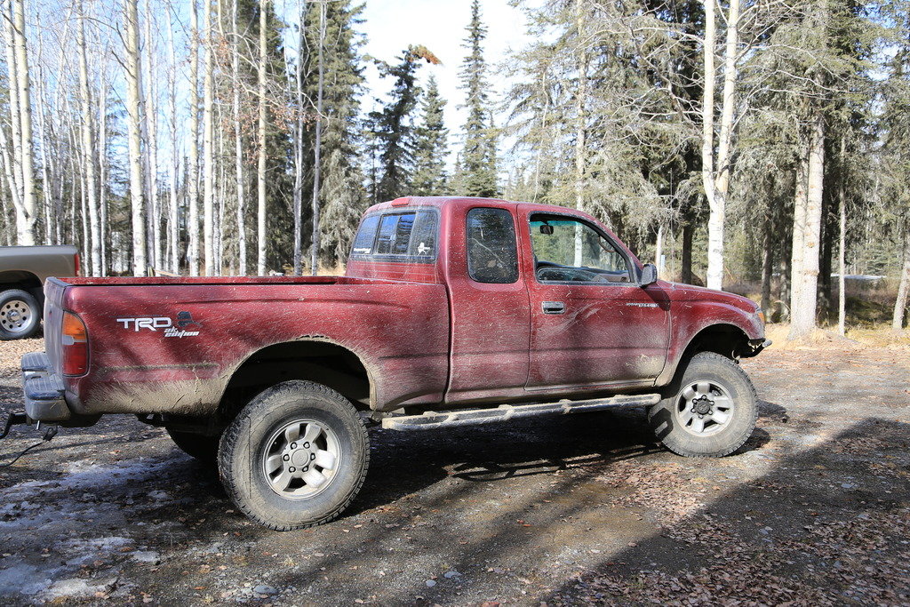

    Finally got a good post lift picture...
